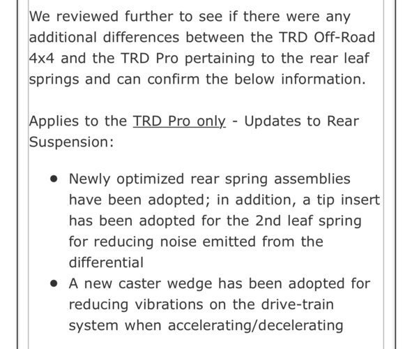

    This is a copy of the email sent to another member from another thread that states the specific differences between the standard leafs and the pro leafs

    Also some fun info, the offroad uses the same upper rear strut bushings as the pro. My pro suspension was missing 1 of the rear bushings, the offroad ones were the same so I just used my offroad ones.

    You are correct, it's a marketing term that Toyota used for advertisement.
