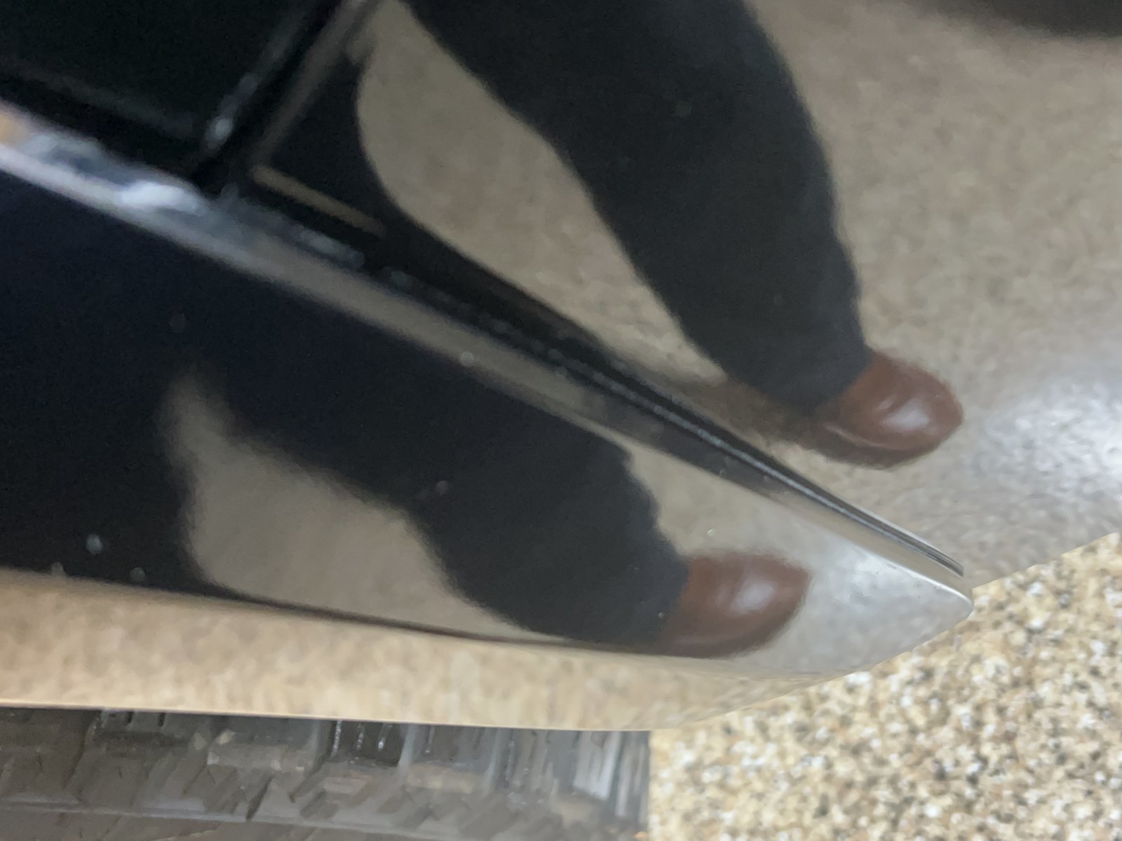

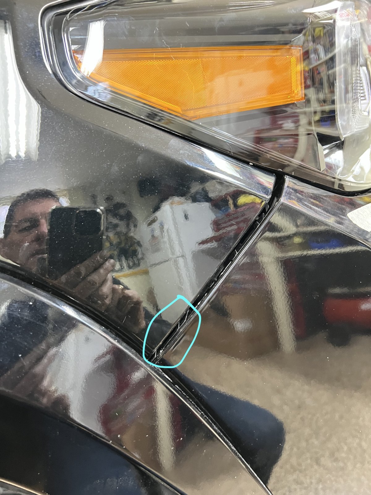

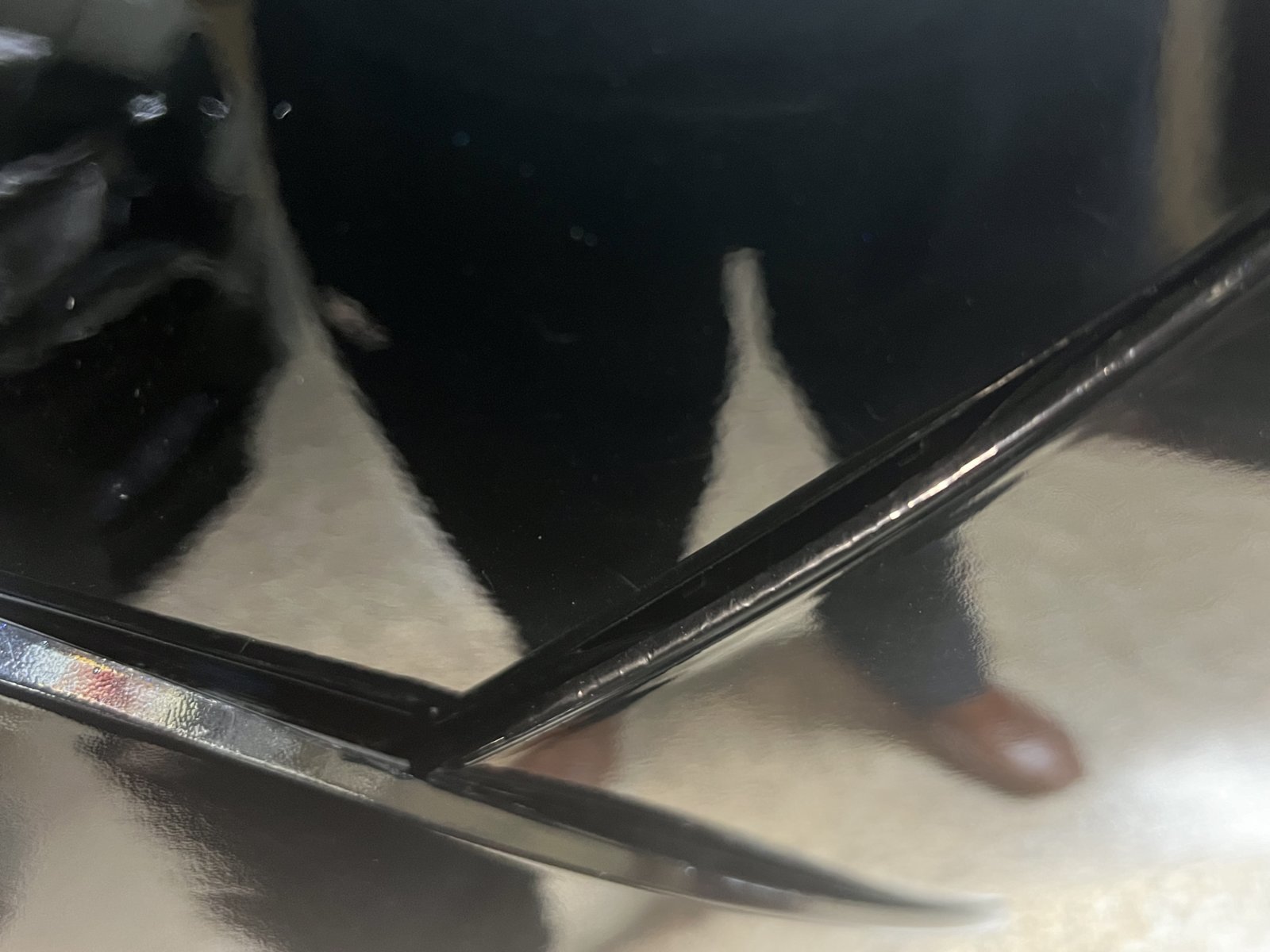

    Here are a couple of pictures that shows the gap between the bumper and fender on the passenger side.
    Not sure why the bumper does not snap back into place. I know there is a clip that fits between the fender and bumper that is held in place by the same bolt for the headlight. Not sure if this clip is the problem.
    Might have to make a trip to the body shop to have this fixed.
    Looking for any suggestions.

    Mines not that bad. :rofl: It's been a minute since I've done this install, but can you lift up and re try pulling the bumper cover towards the fender?
    Kind of looks like the plastic piece here is in the way. Like the bumper needs to come over the top of it before it'll click into place.

    I tried that a couple of times. Seems there is nothing for the bumper to hook on to.
    Appreciate your help.

    Went to the local body shop and asked them if they could help me out and get the bumper snapped back into place. Checked it out and said no problem. Said one of the tabs on the clip was bent, used a small pick on the tab and popped the bumper back into place. 5 minutes and everything was good and no charge. Life is good.

    Awesome. Looked like something bent but hard to see. Glad it’s resolved. Glad no cost. Drop them a sixer or something to spread the cheer.
