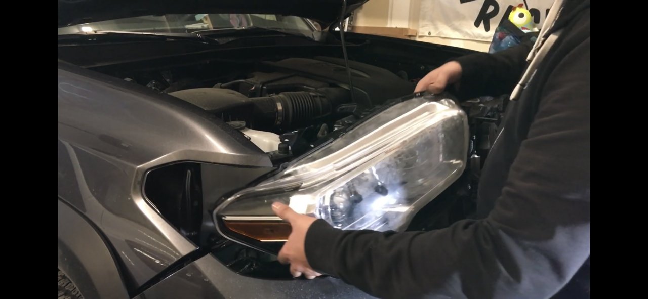

    It is not a straight push pull, the bottom slides in and out sideways the whole assembly slides out towards the grill and opposite for the install , if you can do it straight push pull please send me a video of it I would like to see what all breaks.

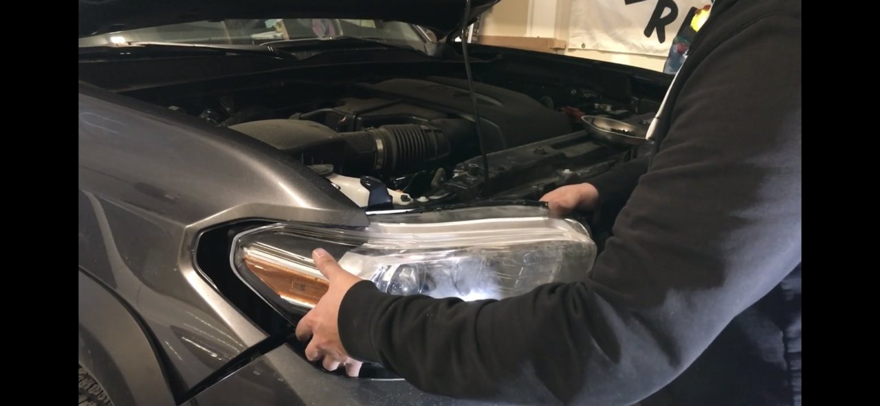

    7CED7200-78EA-4332-BD88-7520E32A754C.jpg I know my video is not all that great but watch Chloe’s and you can clearly see her pull as I did towards the middle or grill. I will screen shot a part from her video.

    Screen shot from Ashton’s video

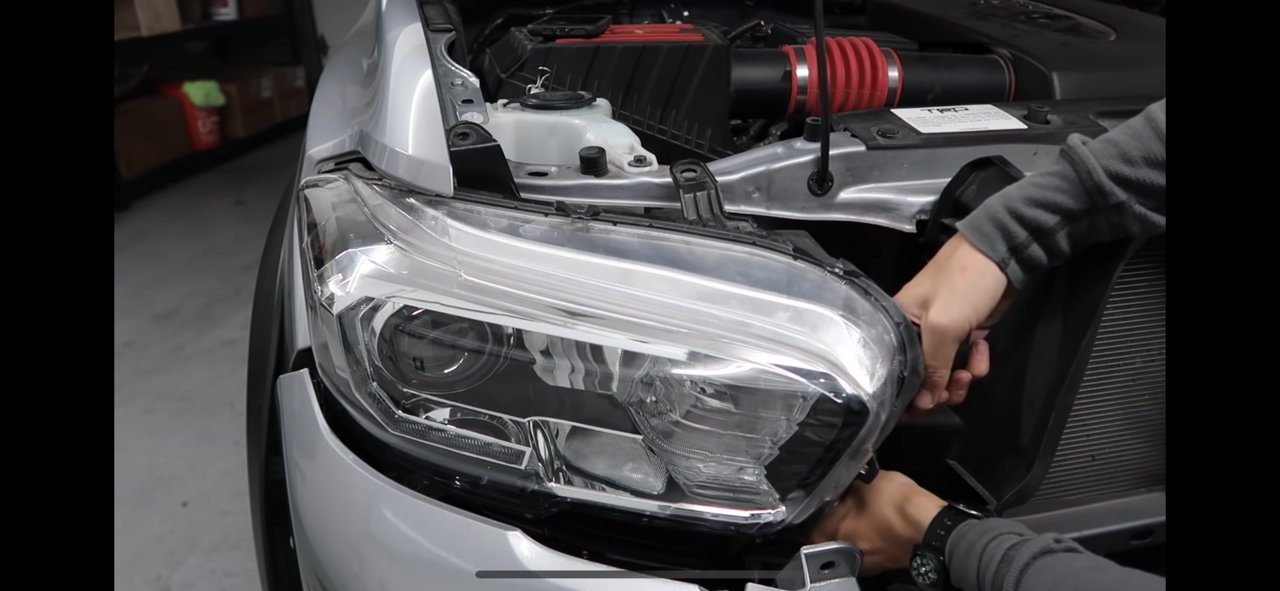

    Screenshot from my video
    Lol I am not worried about it…my install went great.

    You could definitely push up and then slide. I am definitely not a expert as I only have done it once. I am sure there are multiple ways to get them out but I will stick with slide out slide in method.

    I just looked at the area in question...looks like it slides out and the tab on top keeps it in-place. Not too much lift of that tab is required to slide out the joining section. Good thoughts about waiting until the weather is warmer for brittleness...although, the plastic looks like it won't break off easy since my truck is less than a year old...but I will still be careful.
