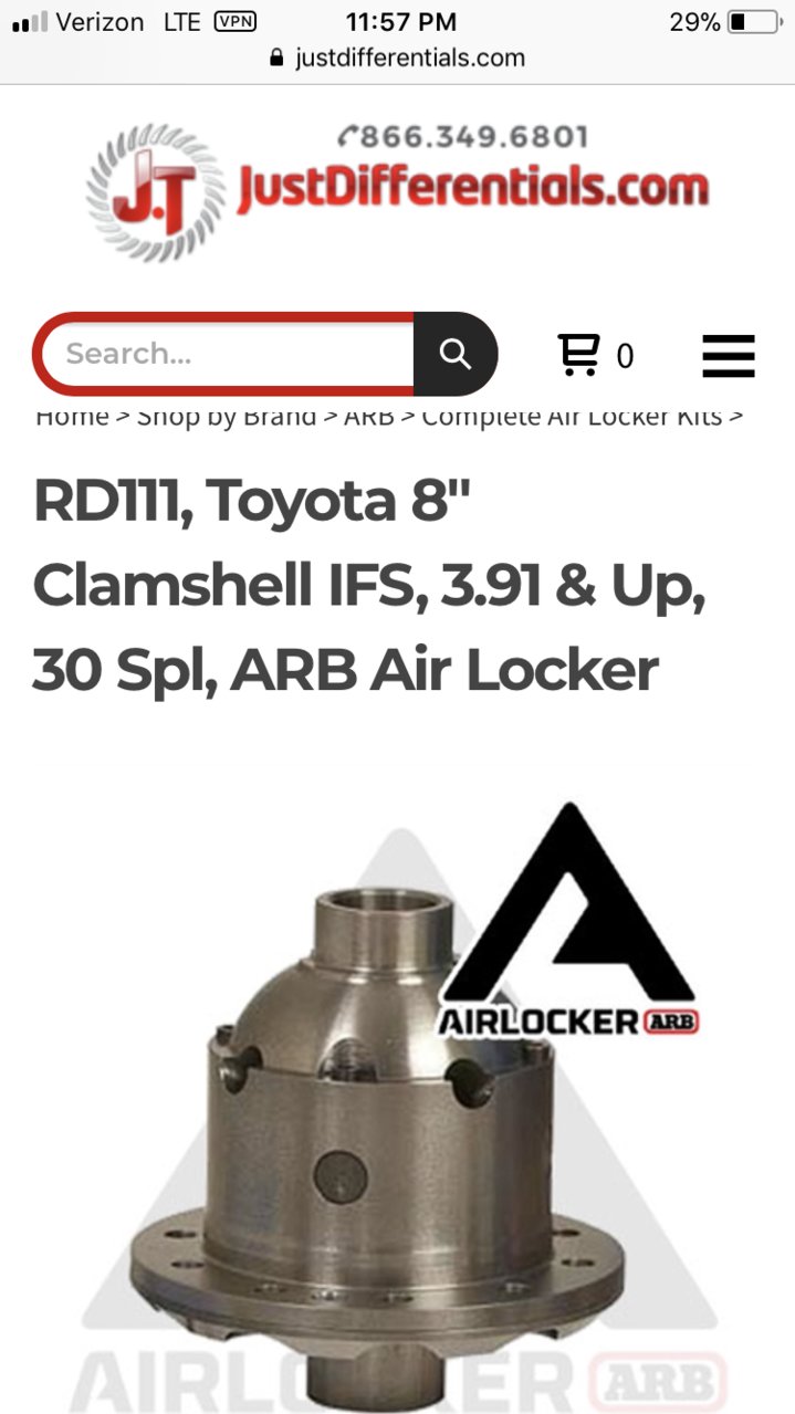

    DO TACOMAS HAVE A FRONT LOCKER? STOCK?

    No.

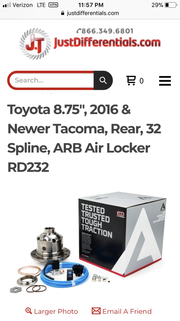

    Like ferntr said, they don’t come with front lockers. These are two of the more common air lockers front and rear aftermarket. You could even get a rear and have 2WD locked.
