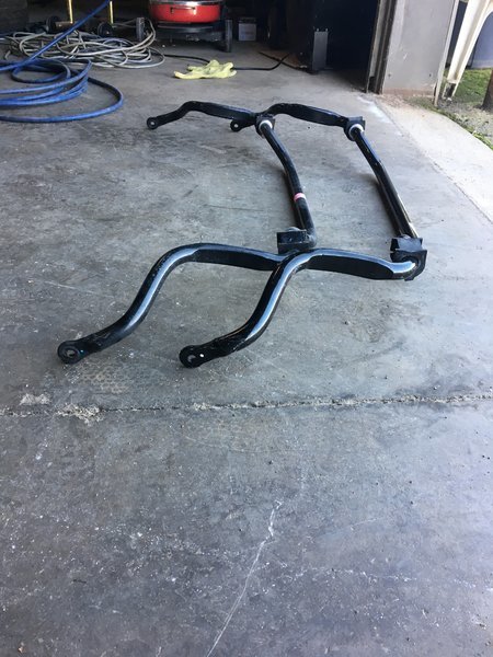

    Installed today, pics of he TRD Pro and the Off Road sway bars
    TRD Pro on the right

    I think the sport is also 30mm ... you'll get less flex with the pro bar

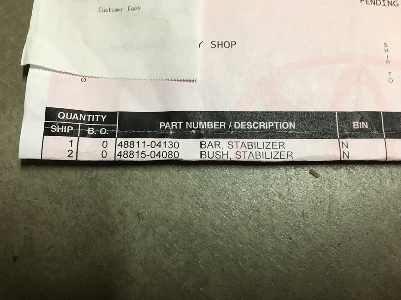

    what's the part number of the sway bar for the 17 TRD Pro?

    Just came to post up confirming I measured my SR's bar @ 30mm. So it looks like only the TRD Off Road has the special snowflake 28mm bar. Makes sense considering everyone who test drives one vs a Sport it says it "leans" more.
    • TRD OFF ROAD: 28mm bar
    • TRD PRO, TRD SPORT, LIMITED, SR, SR5: 30mm bar
    @tzwilliam , looks like you paid a fair price for it so no harm. I'd feel bad if someone had talked it up as the "TRD PRO Exclusive" bar and charged you more money for it.
    I know there's a formula to calculate the effective added spring rate but you would need to measure it. Since you have your OR bar laying around, would you be so kind as to measure it up for us?

    Yeah, I paid less than 175.00 for the 30mm sway bar and bushings, wasn't too bad.
    I also have the TRD Pro shocks on all four corners and TRD Pro front springs which could have been designed/tested as a package using the 30mm sway bar, the truck now feels more solid and does have less lean in the corners.
    Next time I go to my warehouse, I will get those measurements.
