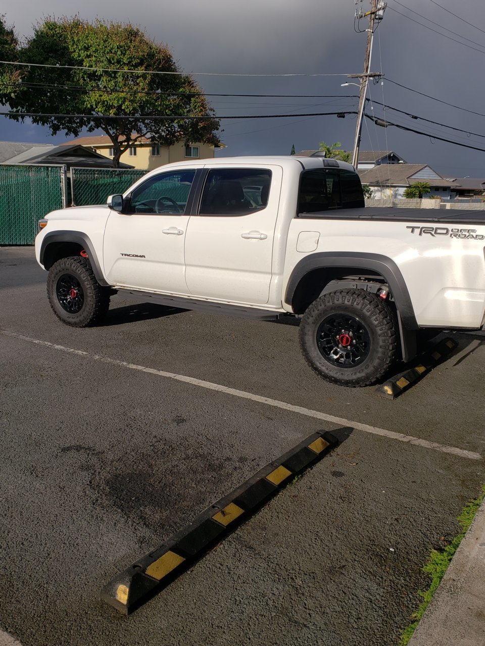

    Thanks guys. I figured they would but didn’t want to buy them and it be some sort of weird offset issue. Did anyone who have them add spacers? I was thinking of doing 1.5’’ would make it sit flush but have an aggressive look. Also thinking I could fit 34s?

    the pro wheels seem to stick out more than the or wheels......IMO

    I don't know about spaces, but with 34s, you're gonna need to lift your truck up 3" and do some trimming. Otherwise, you'll have rubbing issues

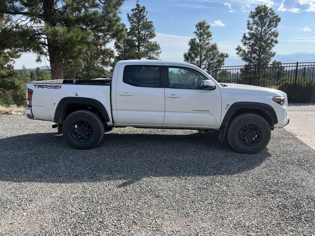

  13. Oct 16, 2024 at 1:03 PM
    Dbarffish
    Dbarffish Well-Known Member
    Jan 30, 2019
    #281279
    703
    Doug
    Montana
    2024 dcsb TRDOR blue crush
    Stock
    Old thread - but I just mounted the Pros on my 23 OR and had some issues getting one wheel on due to a little bit of paint on the outer edge of the axle shaft. It seems the Pro wheel is a slightly tighter fit there - it has a flange that my OR wheels did not. Scrape that paint and clean it very well and it mounted correctly. Maybe this saves someone some angst!
