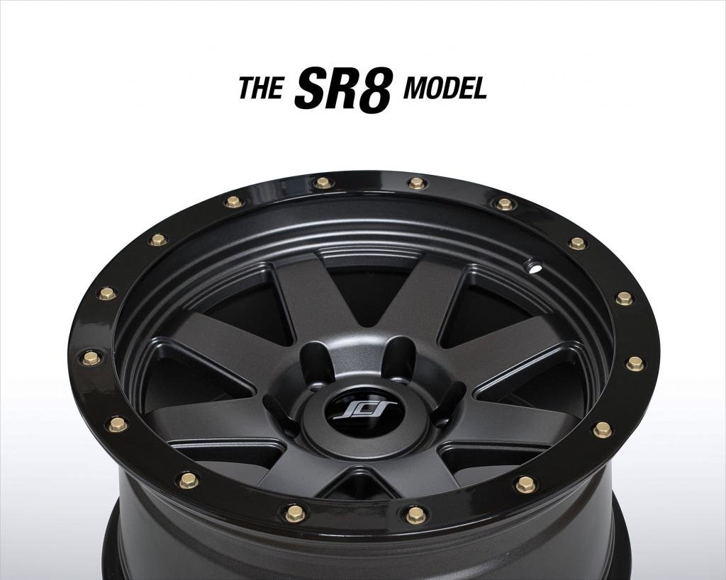

    Another vote for SCS.
    It may be a while for me, but I've had my eye on the SCS SR8's. They have a 16", and 17" version. The 16's weigh 22 lbs, and the 17's weigh 24 lbs. They are also a hub centric Toyota specific wheel, with a 106.1 mm center bore (the same as factory wheels, which is pretty rare in an aftermarket wheel). And they are reasonably priced. Lots of guys are here are running SCS. The one caveat is that the 16's are 8", and the 17's are 8.5" wide. There aren't many aftermarket wheels in 16/17" narrower than 8" width. Maybe time to (Assuming your running 245/ somethings) think about tires as well.
    Here's the thread: https://www.tacomaworld.com/threads/scs-sr8-wheels-16x8-17x8-5.358288/
