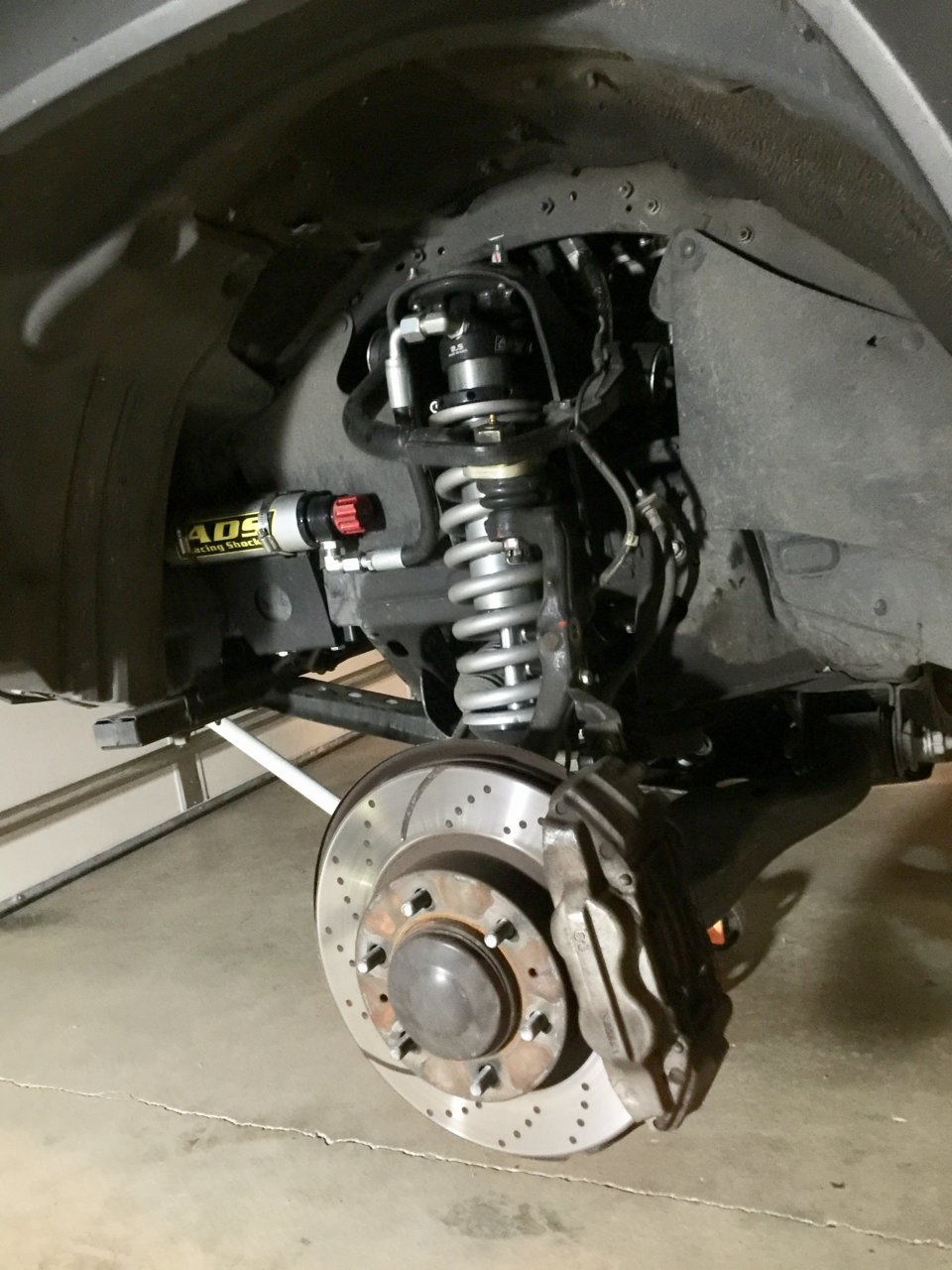

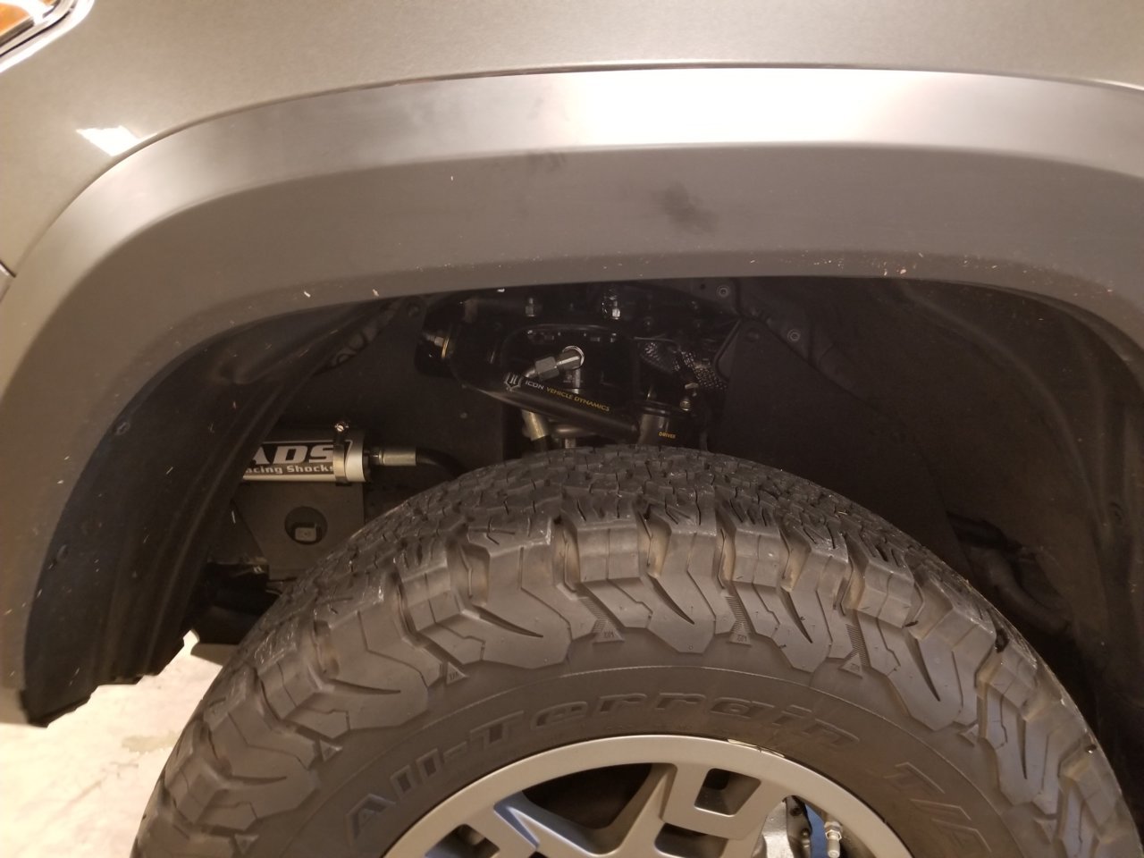

    As to your question, I have a 2017 OR. I swapped out the suspension for the Pro suspension and later (1.5 years) replaced that with extended ADS.
    The Pro suspension is awesome and provides about 1" lift in front over the stock OR. I would have kept it, but I added too much weight in front, skid, winch, bumper, sliders, etc, and it isn't adjustable. So, I swapped them for ADS, which are amazing.
    As others have suggested, I'd recommend ADS, Kings, Fox, or similar. It will cost more, but they are somewhat future proof, when it comes to other truck upgrades.
