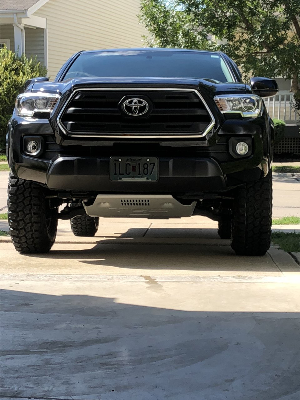

TRD Pro Skid Fit on a 2016 SR5 4WD 2.7?

    It should. The frame is the same. You need t o remover the thin piece of metal. The skid plate replaces that.

    IIRC you will also have to remove the front air dam.

    Fit perfectly. 20 minutes and done. Thanks.

    Yep, probably one of the easiest things to do... providing an immediate impact to the taco's appearance. nice. did the same with my offroad.

    Did you buy it then install it when someone told you it would fit? That was a super quick response.

    Yep. Read responses. Picked it up at dealership. installed in my driveway.

    Op...When you take it in for an alignment the skid plate needs to come off. The skid plate is in the way of the toe and camber adjustment.
    Firestone didn't know, the dealer did.
    Dealer alignment $110
    Firestone lifetime alignment $135
    (they will remove it...just tell them)
