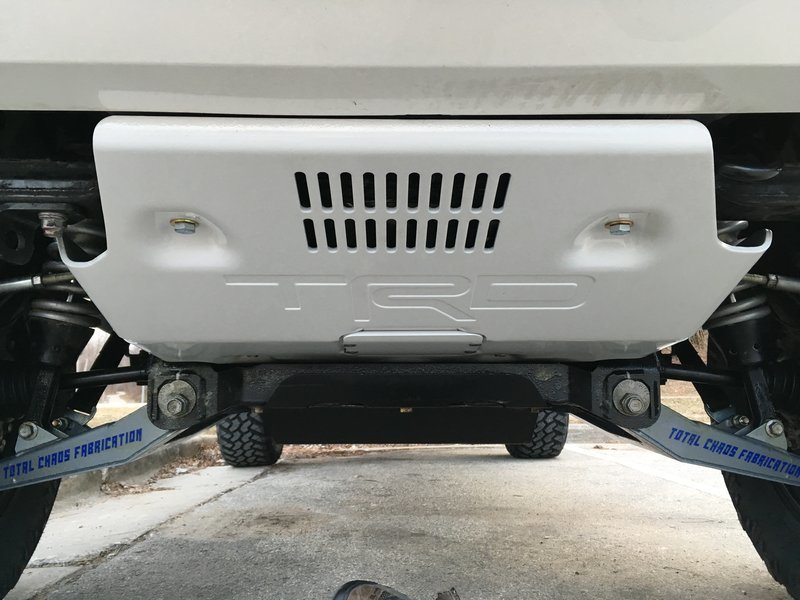

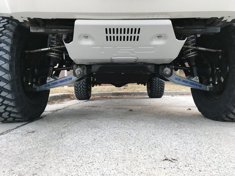

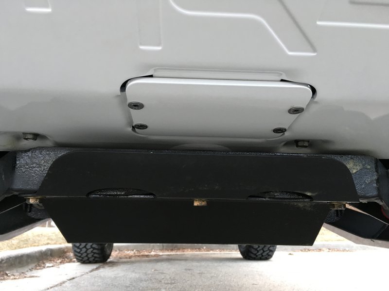

    Finally got the skid plate on in conjunction with my 6" BDS (DB) lift. They had to cut the back end off where it met the drop bracket and fabricated new mounts. (Using metal tube spacers to try to have the intact skid plate didn't really work, because there were huge gaps between the plate and truck)image.jpg image.jpg image.jpg

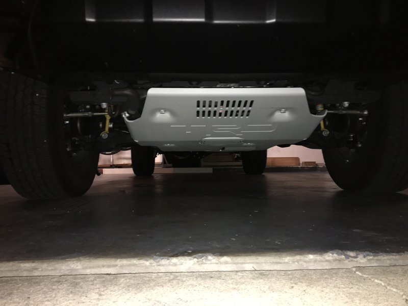

    Installed tonight. Truly a piece of cake. The PDF that's back in the thread was a life saver IMG_7699.jpg
