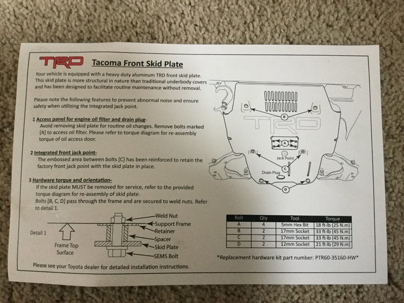

    Just installing mine now - onto my TRD Sport. It looks like you leave the 2 factory skid mounting brackets on (front only for Sport) and replace 4 of the bracket bolts with those on the skid plate. These bolts don't go into the same holes as the factory skids and are much beefier. Those that have installed, what did you do? Seems they should stay to help reinforce the frame between the two mount points.

    Got the instructions and confirmed the brackets stay - attached

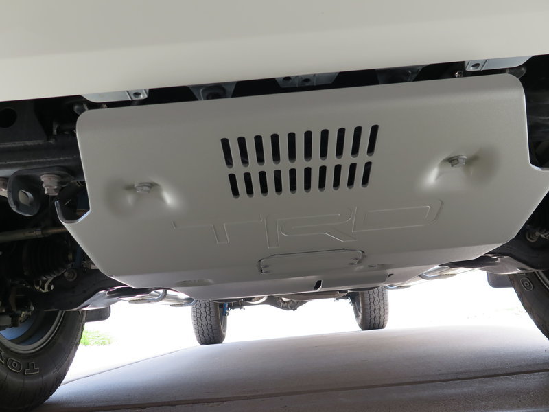

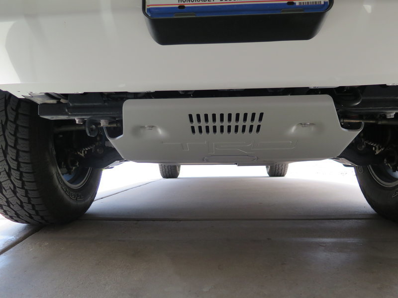

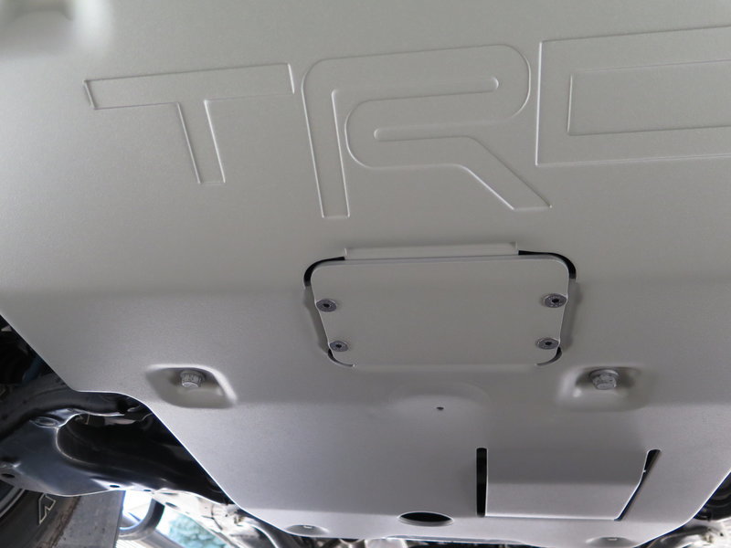

    A few additional pics for those interested.

    I will add, per the instructions this is designed such that you can use the front jack point with skid plate in place (area right behind access door). I'd say it's pretty stout.

    Did you guys use a Torque wrench to torque them down to spec ?
    Or just use a socket wrench until they were tight?

    Crap I don't have a torque wrench

    Harbor Freight, they always have extra 20% of coupons and are cheap to begin with. Mine was calibrated the same as my mechanic neighbor's that cost much more.

    A good torque wrench is one of your best investments if you're going to be wrenching. It gets pretty costly once you start stripping threads/snapping bolts.

    Mark,
    Can the aero molded fairing below the front bumper remain with the new TRD skid plate installed; looks like you removed your fairing? Thanks, Mike
