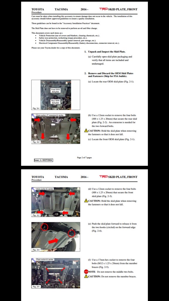

    Bolt her on, 22 ft/lbs, you're welcome ;)
    What am I missing here, not trying to be a dick. I unbolted my tinfoil factory OR, layed down on creeper, threw Pro plate on chest rolled under and bolted up. I heard otherguys used paintcans to hold in place.

    You do need to remove some bolts other than the stock offroad skid plate. But you should be able to see which ones with a little common sense.

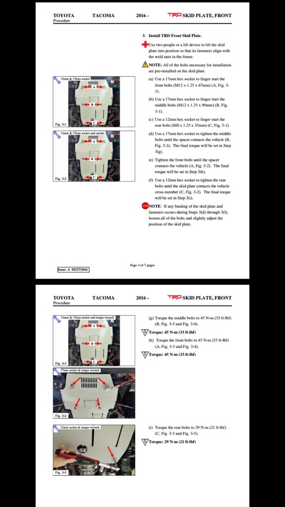

    Don't over torque it. I broke my shoulder and had an accessories guy install my bumper, and he stripped the center weld nuts inside the frame where they cannot be reached. I had to install helicoils. No more than 20 ft lbs, although Toyota says 33.

    Be sure to torque the bolts to spec. I had someone install the bumper and over-torqued beyond the 33 ft lbs recommended and the weld nuts broke the weld. I've had to install helicoils and 14mm bolts.
