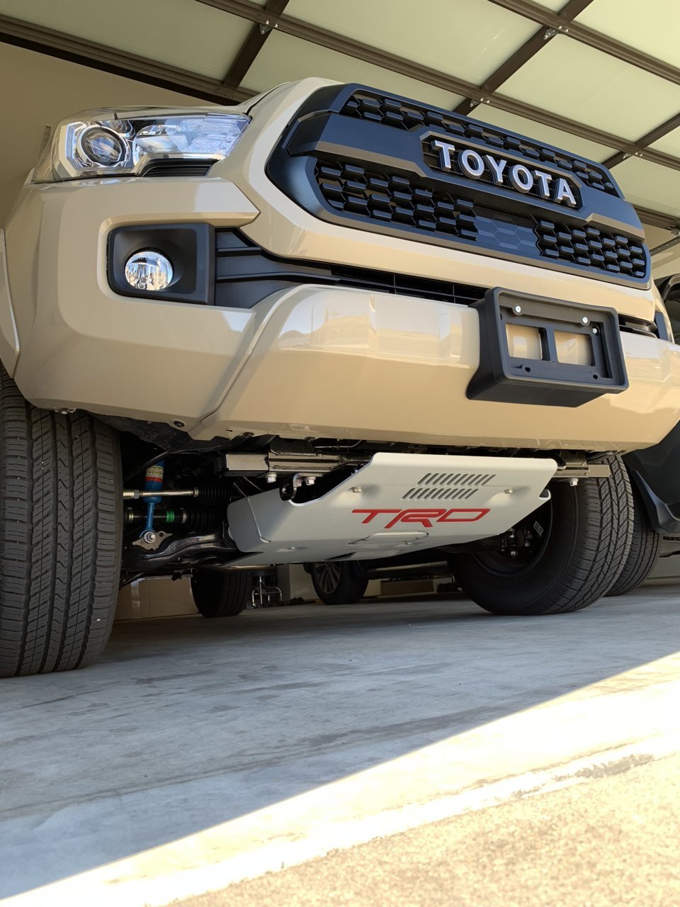

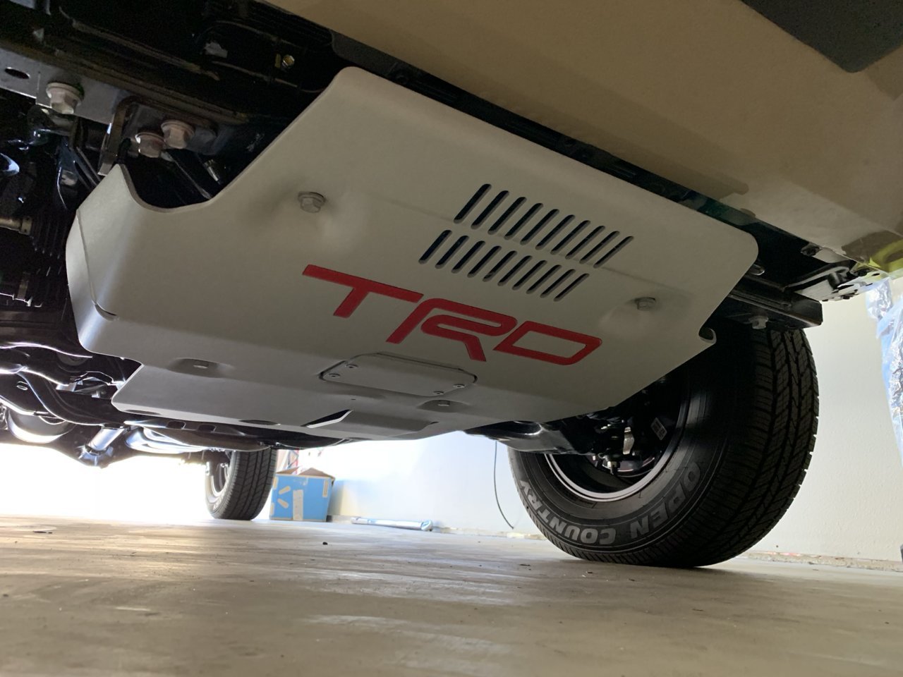

    Tufskinz inserts arrived today and my skid plate is finally complete!

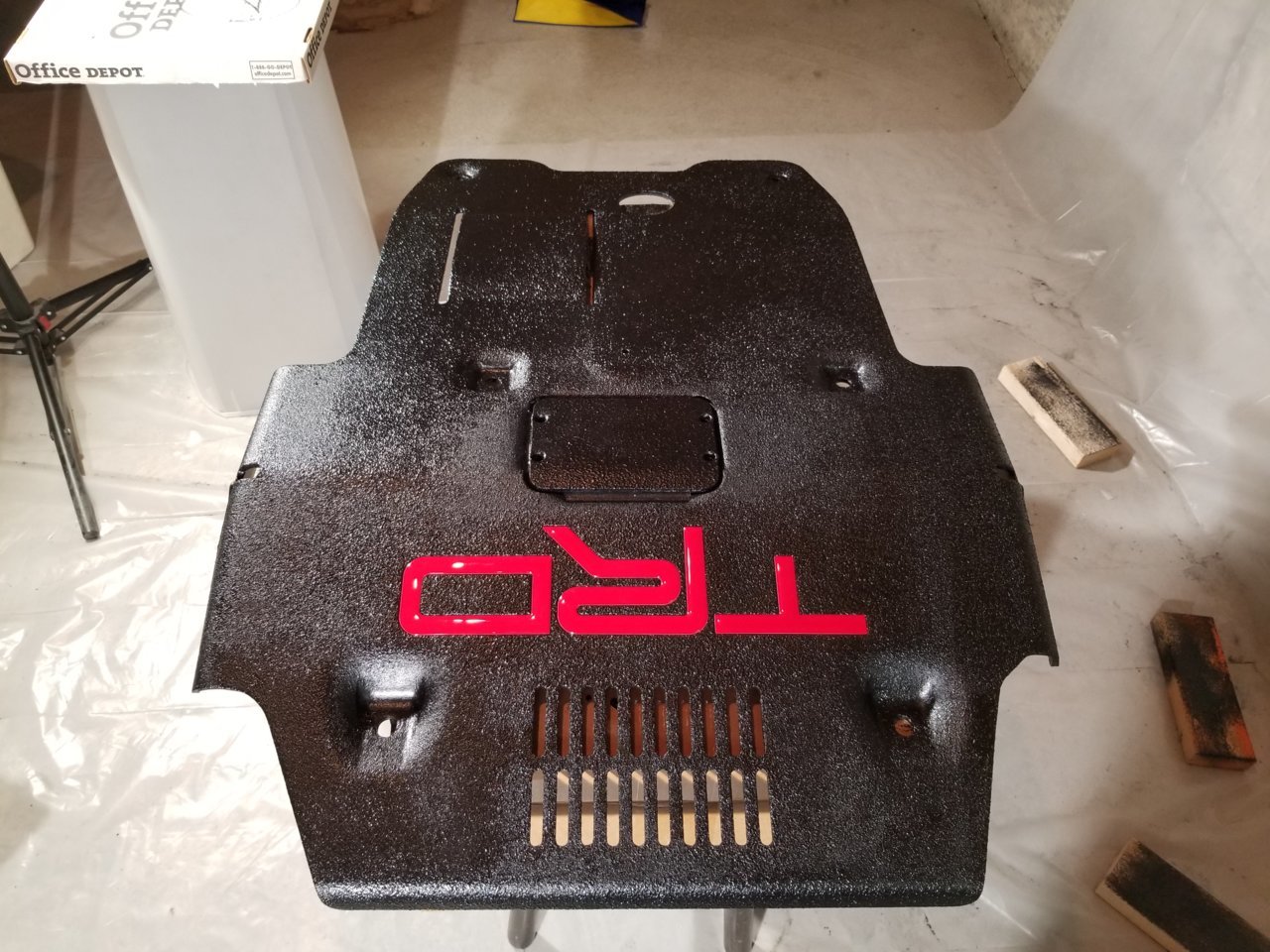

    Used bedliner on my skid and added some @TUFSKINZ
    Turned out pretty good. Hopefully this holds up better than spray paint.
