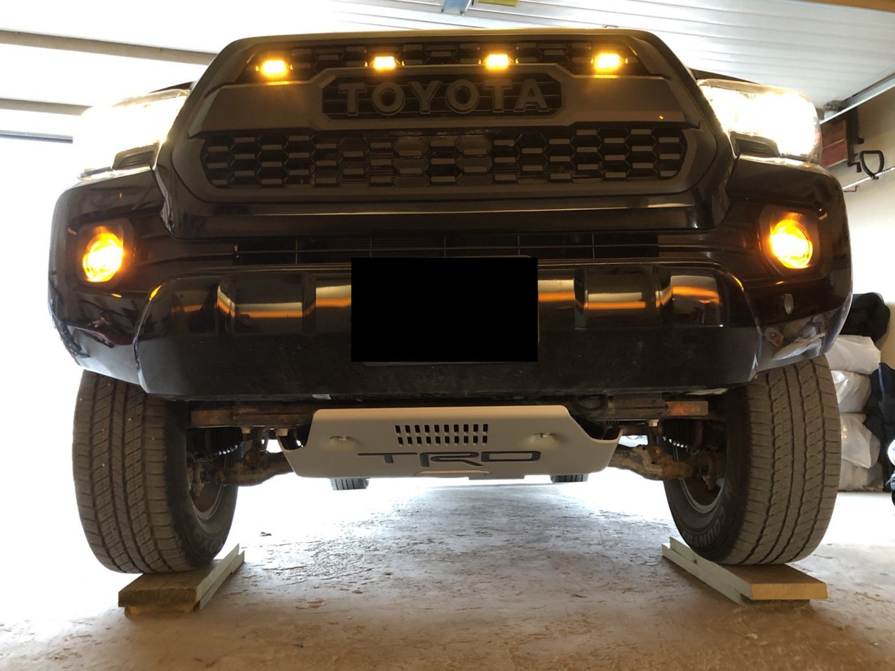

    I tried to install my skid plate on my sport tonight and had to give up. The two previous unused back holes were in rough shape. Felt almost like they were about to get cross threaded, which would be hard to do as these bolts have long centring pins. But if those weld nuts get damaged I’m fucked big time. I’m grabbing a tap tomorrow at work. Way too much of a risk here to try to power through all that dirt and rust. Even a bit of WD-40 didn’t help much.
    ODSC1[QUOTED][OP] likes this.
  3. Apr 28, 2021 at 7:14 PM
    #83
    Blue Hooligan
    Blue Hooligan Well-Known Member
    Dec 10, 2008
    #11447
    884
    Winnipeg
    2017 Black Tacoma TRD Sport
    Update: I ran a 5mm tap through the weld nuts and couldn’t believe how much shit it took out of there! Finally got it on! Here’s a tip, use a box or something to balance the back of the skid plate when installing it. I watched 3 YouTube videos and everyone of them had some dude trying to balance it on their feet.

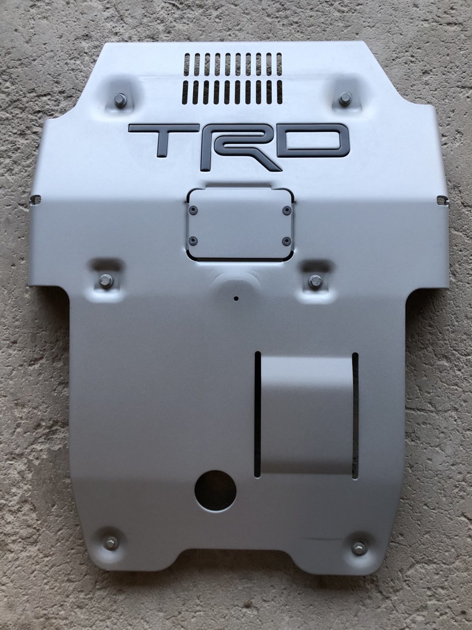

    Haven’t read through the full five pages.... but these points can be considered:
    1. Good idea to raise the front of the truck another 8 inches or so with a ramp
    2. Use a friend
    3. Use a wheeled car jack with a section of 2x4 on the rounded part to hoist the skid plate up into place
    4. A friend is helpful!
    5. Use an impact to remove the existing bolts
    The longer 17mm bolts are in the middle.
    The shorter ones are for the front.
    12 mm in the rear.

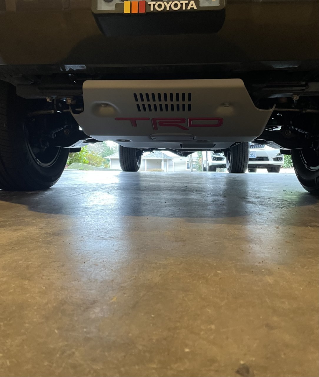

    I have a 22 Limited and installed my TRD skid plate today successfully thanks to the advice in this thread and the plentiful videos on YouTube!
    The part that confused me the most during my install was that all of the videos and instructions I’m seeing online showed TWO factory skid plate pieces that needed to be removed.. I located and took off the front one just fine and crawled under my truck for a long time trying to find the back one, but it wasn’t there!
    After realizing that I don’t have a 2nd piece to remove; I went ahead and installed the new skid plate and everything screwed in fine.
    But I’m still wondering why my truck didn’t have the rear plate originally?
