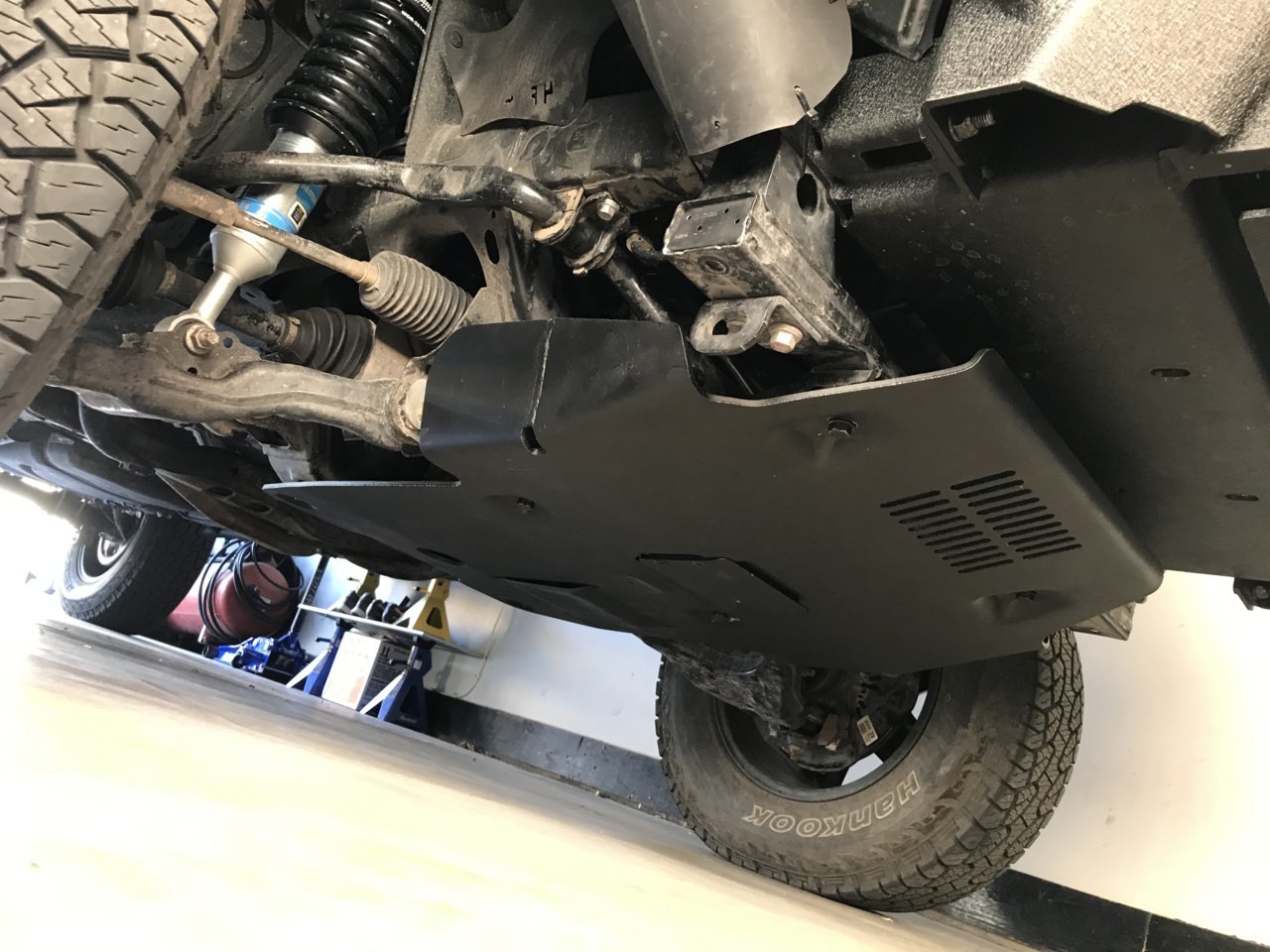

    Seems the bolts are in the wrong location as shipped, at least to me. After I figured out where to put the long bolts and the short bolts, it was smooth sailing. I will say, this thing will bounce off more than a few rocks and keep on doing it's job. Here, it is hanging out in the driveway.

    Awesome, thank you! When you say the bolts are in the wrong direction, are they pre installed in the bolt holes?

    Yep, the one I got, the bolts were held in place by those flimsy washer thinges. Would have been easier to figure out my self where the bolts went to start with. Only 6 bolts, if you use a couple of friends or stands to hold it up there in place you will figure it out easy enough. I would love to tell you where where the short and long bolts go but damn if I can remember. If. you get one, shoot me a Pm and I will reverse figure it out for you. One side one bolt at a time should be fairly easy to figure out.

    Medium length bolts with short spacers in the front. Longest bolts with longest spacers in the middle. Shortest bolts (or reuse the ones from the original skid) in the back.

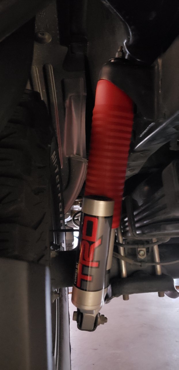

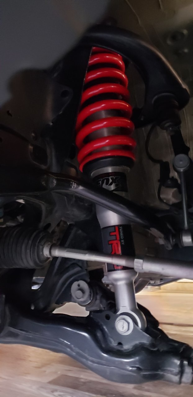

    Thanks 265 70 17 ko2s. I installed pro fox shocks front and rear that I got from a TW member. It leveled it out perfectly. 20210319_190818.jpg 20210319_190848.jpg
