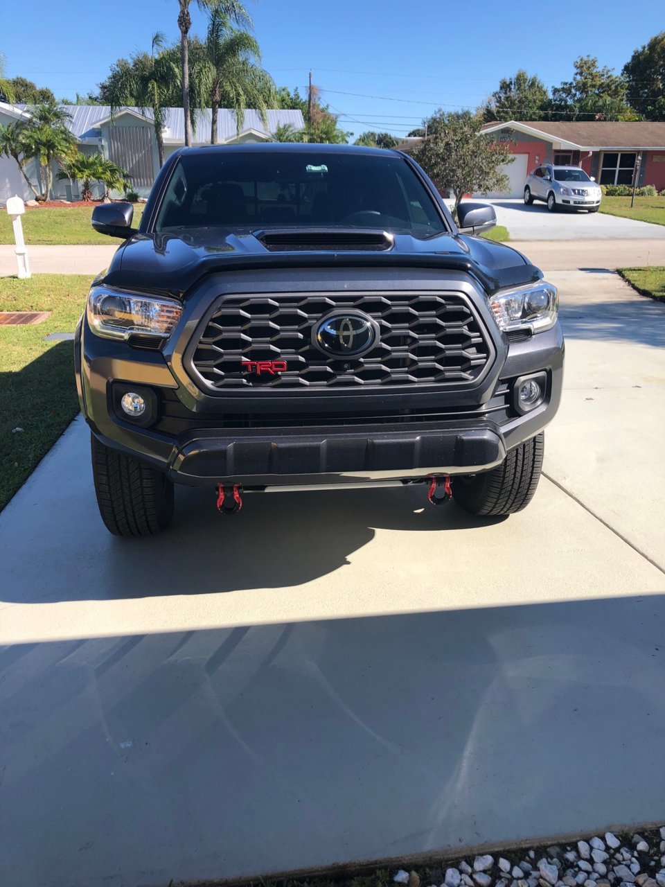

    Ed, if it's any consolation, it took my wife till the 3rd drive with me after it was installed to notice. Even then, the only reason she noticed at all was because of the red D-ring hooks dangling off the front. Just don't let her approach your truck from the front at a distance and you'll be fine :anonymous:
    And I will second what @Chicken_Taco said about the TRD Sport - mine fit just fine with the air dam off.

    Just for good measure I added a TRD badge to the grill this morning.....red to match the TRD lettering on the skid plate and the D-ring hooks...

    Looks good man!
