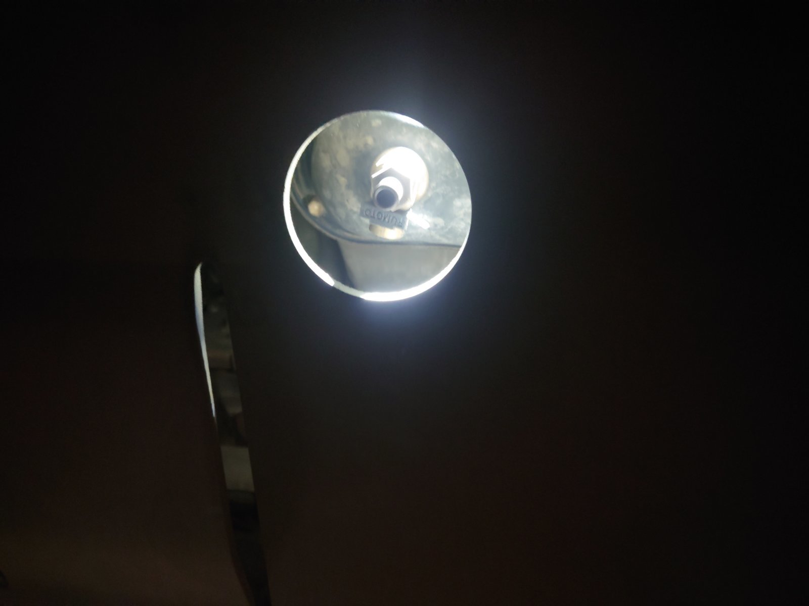

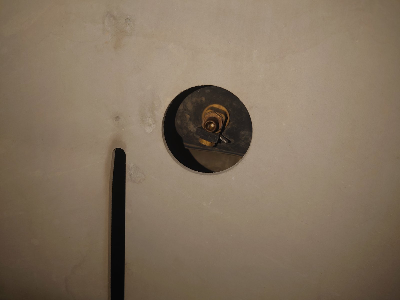

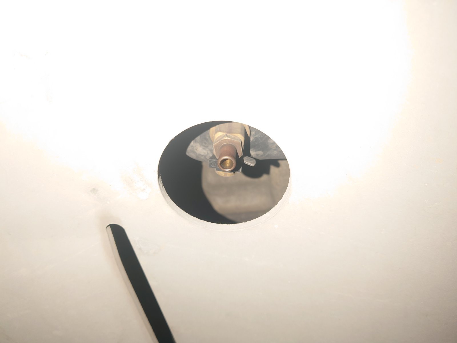

    2017 QS DCLB TRD Sport
    There is 1.5 inches of clearance from the valve's OD to the openings ID. And an inch from the tip of the valve to the bottom of the skid plate. This is the F133N, with the long nipple. So if you have the short nipple version, you would have 1.5 inches of clearance all around.
    I have had my Fumoto since 2009/10, and was on my Corolla then. In 2017, I totaled the car, yet the Fumoto still kept all that oil in.
    Since then I transfered it to my Taco, when I changed over to the F133N, it went to my roommate's Corolla Cross. Still going strong after 24 years.
