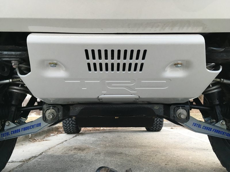

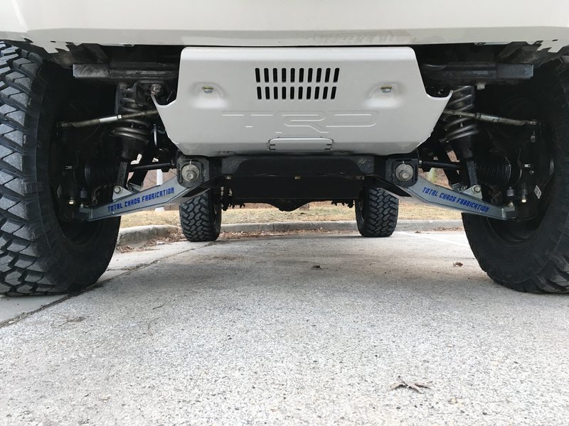

  14. Jan 29, 2017 at 6:03 PM
    Vero
    Vero Well-Known Member
    Apr 9, 2014
    #127334
    97
    Milwaukee
    '10 lifted TRD Off-road and '17 TRD Sport w/ 6" BDS
    4" Lift on '10; 6" lift on '17
    Finally got the skid plate on in conjunction with my 6" BDS (DB) lift. They cut the back end off where it met the drop bracket and fabricated new mounts.image.jpgimage.jpg image.jpgimage.jpg
