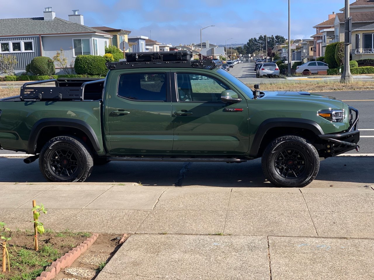

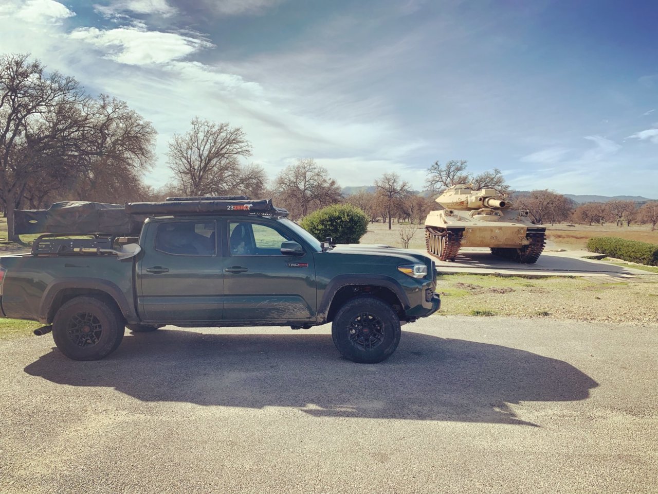

    KindaSortaGood
    KindaSortaGood [OP] Well-Known Member
    Aug 21, 2019
    #302933
    67
    2015 M3, 2020 TRD Pro Taco & Lots of black buses
    Will more than likely need to find a solution.
    My rear was sagging like crazy earlier in the year when I loaded all my gear up (before bumper & sliders)
    I'm guessing around 350-400 lbs total of gear on the back
    Grindstone likes this.
