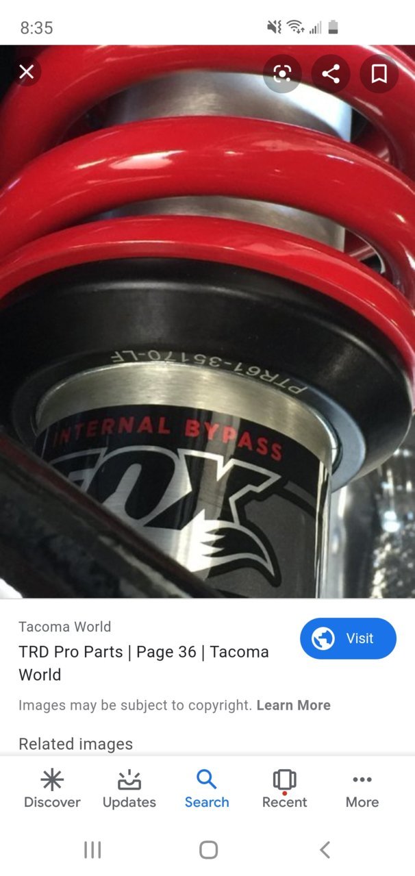

    If you look on the bottom of the spring perch on each side it says what side its for

    2018 Cement Tacoma TRD Off-Road
    I think you might be mixing them up. Shouldn’t the one with more pre-load/compression go on the drivers side?

    As @5nahalf mentioned. (For future interests)

    On the rear is on the reservoir, front its on the spring perch.
    [​IMG] [​IMG] [​IMG] [​IMG]

    08 SR5 4x4 V6 IndigoInkPearl ACLBFTMFW
    Well, lookie there, the “LF” is left front and “RF” is right front. :D

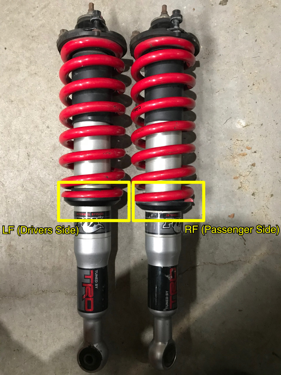

    For anyone who’s wondering, I labeled the corresponding sides. The LF strut seems to be under slightly more compression than the RF. I did not take these apart, but I’m assuming that either a spacer is used under the spring perch for the LF strut or the LF strut just has a higher spring perch to put a little more pre-load on the spring to counter act the “Tacoma lean” mentioned earlier. The mounts appear the same.
    Yes that would have helped! Lol! Though you definitely don’t have to remove the bolts from the lower ball joints and loosen the lower control arm bolts. I removed the castle nut from the upper ball joint, popped off the stabilizer link from the knuckle, and unbolted the sway bar bushings which allowed me to rotate the entire sway bar 180 degrees out of the way. It was a piece of cake. The camber never was changed by loosening the LCA bolts and was perfectly in spec when I was done.
