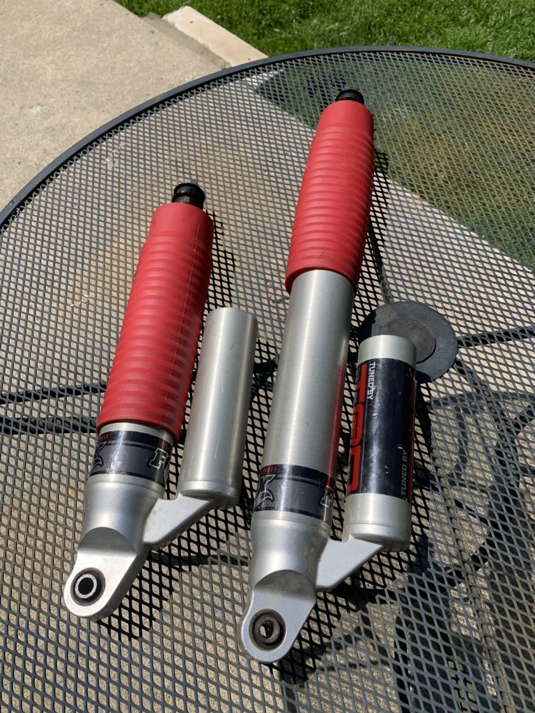

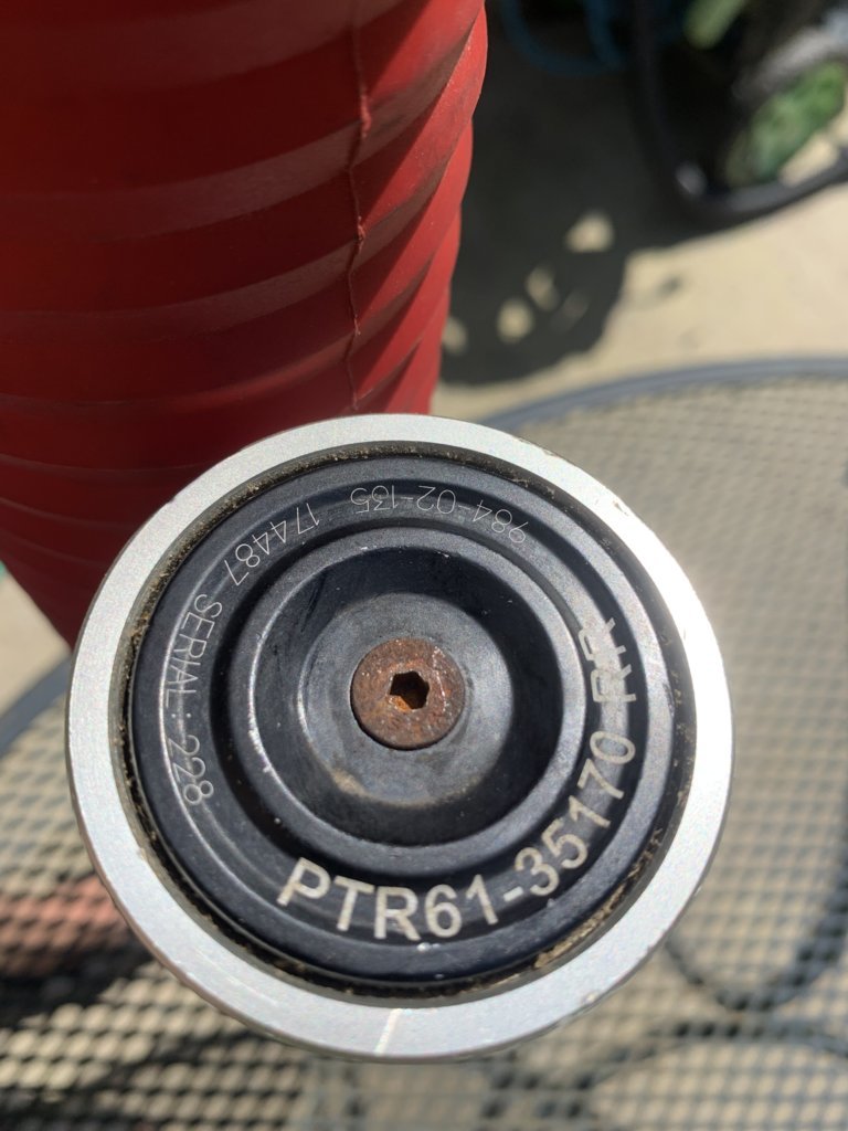

    2015 TRD Sport doublecab
    Picked up a free set of rears. Worth rebuilding? Also- will they work on a 2015 TRD Sport?
    Thanks for any help!

    Thanks! 2015 TRD Sport doublecab. Still running Bilstien 5100 (i think)on the front. Will these work at all on this truck or should i fix and sell?

    oh i havent spent a dime yet. these were a freebie- fronts are stock- pretty sure thats 5100s?

    Stock bilsteins are a narrower shock than any of the aftermarket stock replacements from bilstein (4600,5100,6112,8112 in the front).

    yeah they're a little...soft?
