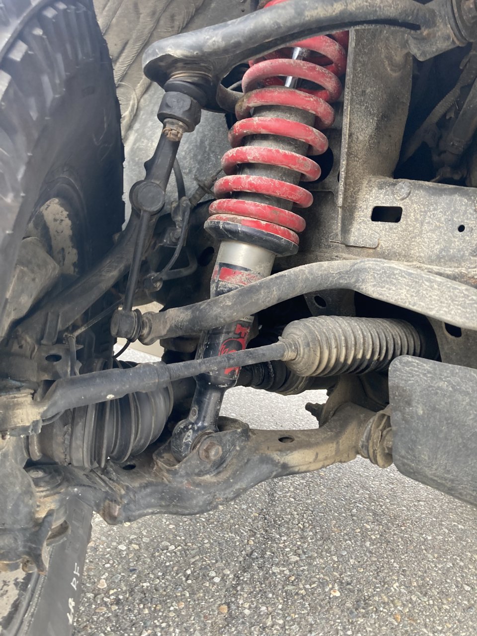

    If you are talking about the 3rd Gen TRD Fox front coilovers and rear shocks.
    Short answer is: YES
    Just keep in mind that the spring rate is slightly different.
    You will gain manufactured 1” + different spring rate of 0.5-1” = 2-2.5” in height.
    I installed a pair for the fronts.
