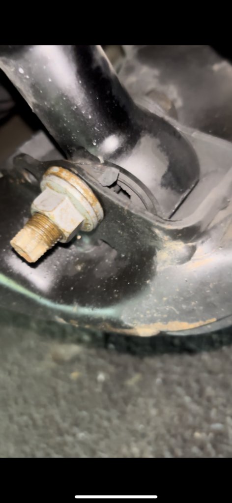

    I just got a 2020 trd pro with 110,000 miles on it and of course the front lower mount bushing on both front shocks are destroyed. Not sure if I can replace the bushing every place is telling me to replace the whole strut and you can’t buy the bushings. Should I buy new Fox suspension from Toyota or get the OME BP-51’s. Also if Fox sells the bushing I’d do that too! New to the Tacoma world here for the help

    Those lower shock bushings are definitely replaceable, if you find the appropriate size. However, at that mileage, I would estimate a full rebuild is coming soon. There are members here that will rebuild them for you, but the cost of service and shipping is likely prohibitive.
    I personally would avoid BP-51's. They are overly expensive and notorious for leaks. A good budget friendly option would be Bilstein's and they'd likely perform similar to the OEM Pro's.
    I would NOT buy OEM Pro's from the dealer... pissing money away. Look on your local FBMP for low mileage take offs.

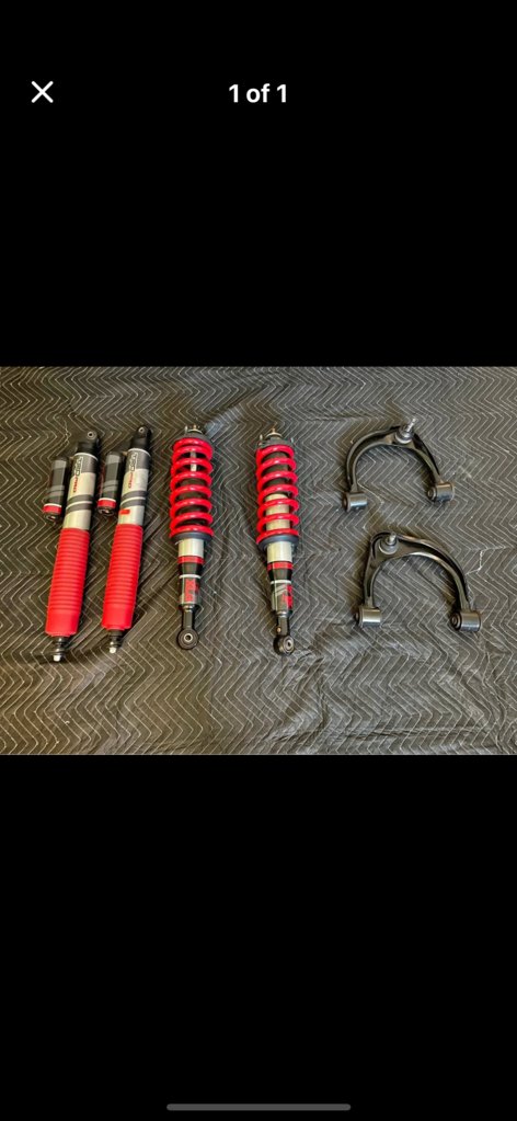

    I see these for $1200 with 40000 miles never been off roaded on.

    The UCA's add no value, so I would negotiate those out of the deal. At 40k, those aren't "low" mileage, but are a good option for the right price. I would probably only pursue those for sub $1000.
    I would also get a quote from @memario1214 (awesome vendor) for the Billies mentioned above. A lot of people like the performance of the Bilsteins and they will likely serve you well, if you've enjoyed the Pro's.

    Rebuild you IBP shocks and replace the bushing. Don’t downgrade.

    I would love to but no shop and myself can find the bushings. Do you know where I can buy them?

    I know I want to keep my shocks but I need to replace the bushings and they’re impossible to find

    The bushing is a Toyota part # embossed in the rubber. Xxxxx-A0001

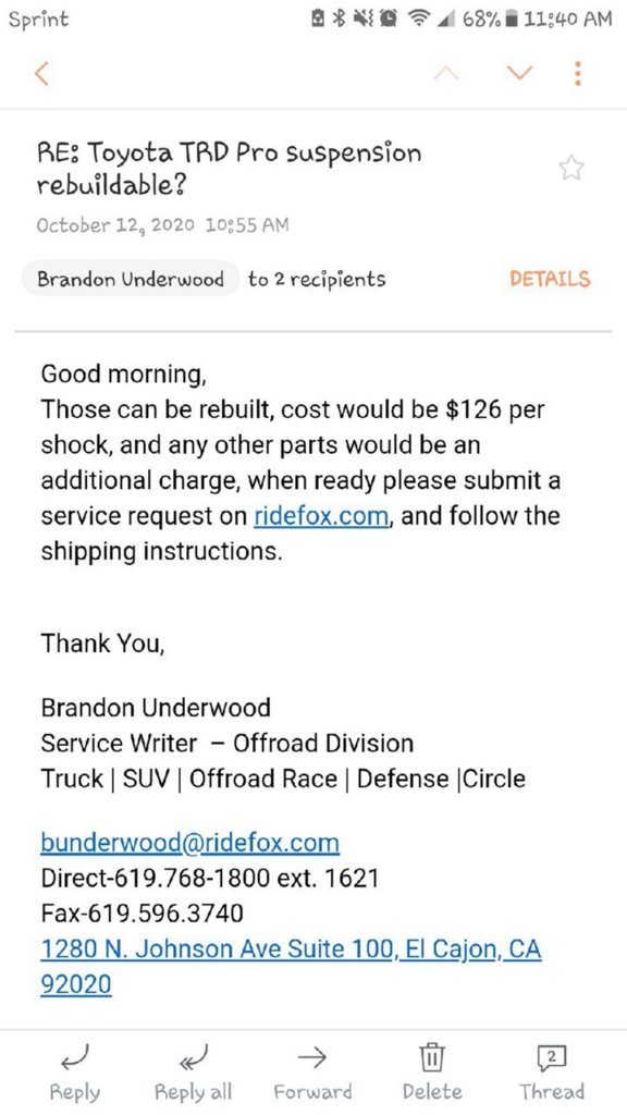

    Eh... calling them "rebuildable" isn't exactly accurate. They can be modified, to be rebuildable, but it requires tapping a schrader valve into them, so they can be recharged.

    Does Fox rebuild them or only others? When Fox rebuilds, do they install the Schrader valve?

    I could be wrong, but I don't believe Fox considers them rebuildable, and will not rebuild them. I'm fairly certain it's only the home jobbers.

    Perhaps, I stand corrected...
    https://www.tacomaworld.com/threads/replacing-original-trd-pro-fox-shocks.703540/
    Old post though...
    I still don't think it makes financial sense... cost too much and your truck is on jack stands while you wait.
