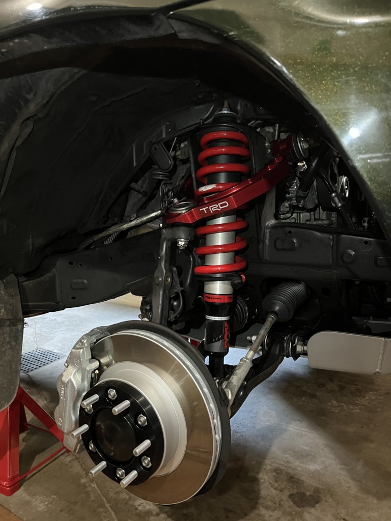

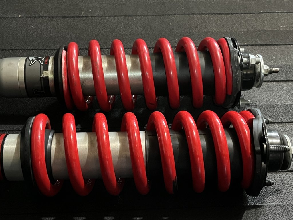

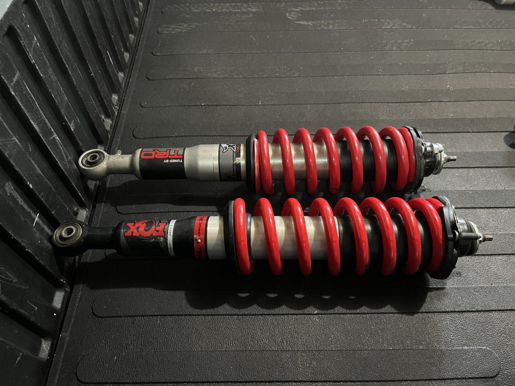

    I think it was a MY22-23 thing - whenever it was that they had the red forged UCA's (my guess is they needed a bit of geometry correction and coil clearance - otherwise, what a weird place to dump development costs..). I didn't measure exactly but they looked to be about 1/2" or so longer when extended. P/N on these guys is PTR61-35220.
    They're pretty firm on the lighter 2G AC (something like 200-300# vs. a DCSB 3G?), I didn't put many miles in the earlier setup, but the butt sensors say it was more plush/compliant. I'm keeping the MY17 setup just in case I want to revert back as I have only put about 1000 miles on it; it's fine on the street but want to do some time off pavement before coming to any final conclusions.

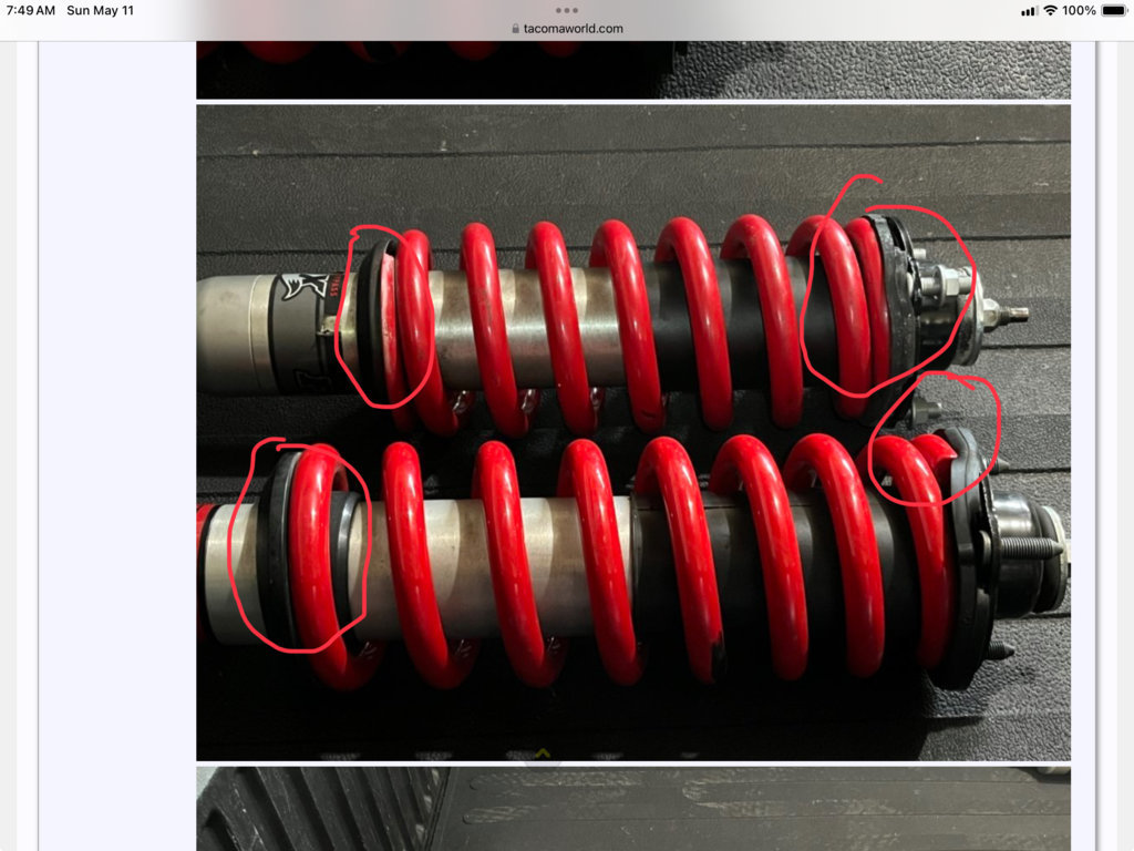

    You'll also notice that the earlier model year springs are grounded flat vs the newer being rounded.

    Did they change that before MY22 or were the springs ground flat up until then?

    It was a MY19 to MY20 change.
    I think the flat ground ends were breaking off prematurely in some rust belt areas so they went to a full coil. The full coil has been known to create some squeaks but doesn't break.

    Interesting. Did the update to the springs only affect the ends and they're otherwise the same as the earlier ones?
    Now that I am actually looking closely at the pictures, the newer versions look substantially different..much longer installed length, appears to be progressive rate with tighter coil spacing on top. Wire may be thicker as well but could be the brighter red paint; I didn't measure that (yet).
