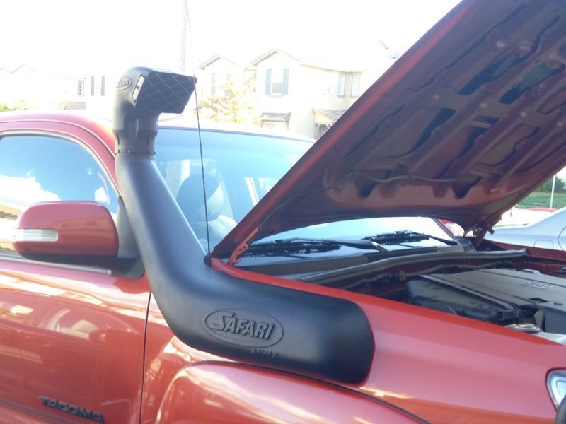

    Just finished putting this bad boy on

    Next thing you know you'll be chopping fenders and body mounts and putting 35s on. Come to the dark side...we have cookies.

    It was tough drilling those holes. The old lady was freaking out. But I like it and it came out great.

    Drilling the holes was easy on mine. Getting the uppermost nut on the stud took several mother-effers though.

    Right. My arm was tired, my back was sore, dropped the washer and nut - I don't know how many times and after another beer, I finally got it.

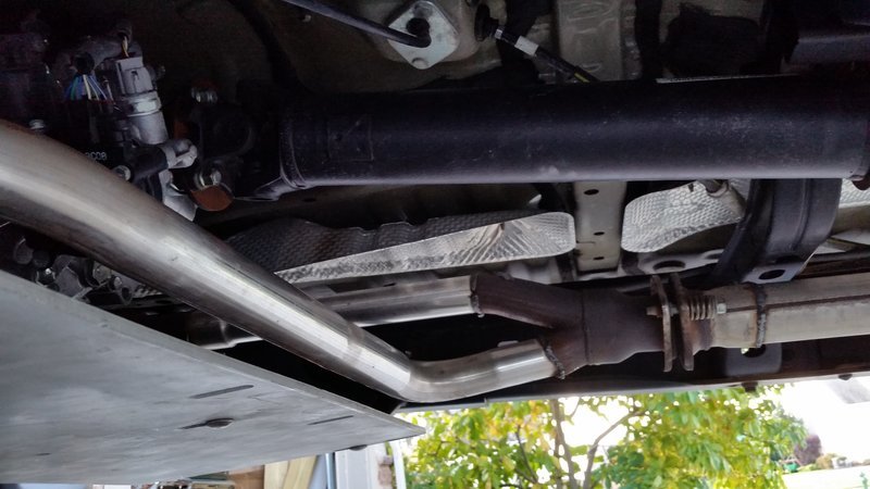

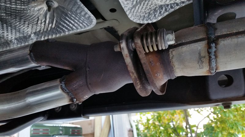

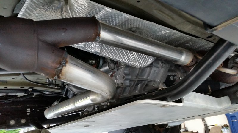

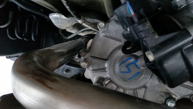

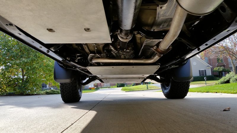

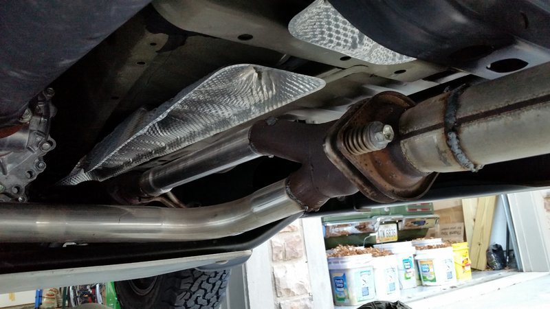

    Here's some pics of the exhaust cross-over relocation. Not the neatest welds, but I'm happy with it. The crossover is now just under the trailing edge of my transfer case skid plate. Also, the interior drone associated with the TRD exhaust has been dramatically reduced. I read another post somewhere that claimed this benefit, and I can confirm. It really did quiet things down inside the cab. No idea how or why, but I'll take it. Sounds the same outside. I'm going to coat everything but the muffler from cats to outlet with POR-15 high temp coating and then add two 1-foot bolt-on heat shields where the driver's side pipe bends 90-degrees to go past and around the transfer case and actuator. I won't be driving more than a couple of miles until this is finished, but there's at least 3-4 inches between the pipe and actuator - and that's the part I'm most worried about.

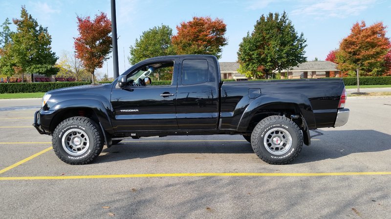

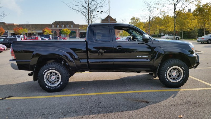

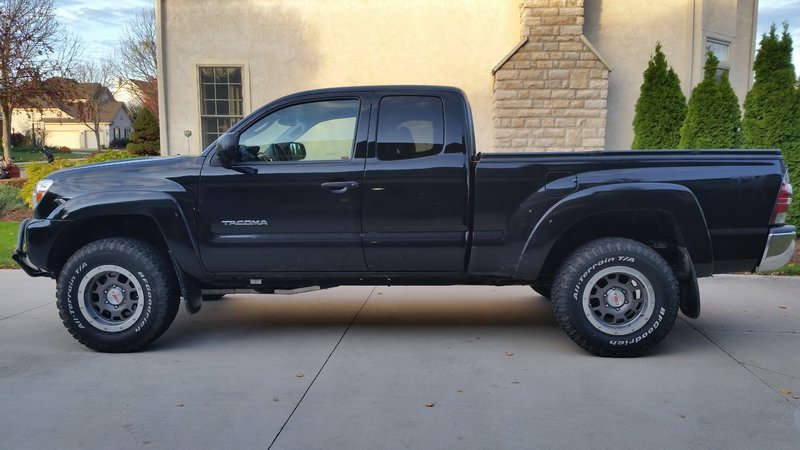

    Here's some before and after shots going from factory spec to the new 265/75/16s and the Wheeler's helper springs. It's settled a little since yesterday, but I still think it's too high, and certainly more that the advertised 1.5 inches. I'm going to wait to hear from Wheeler's and give it some time to settle more before making any changes. If it stays this high out back I think I'll just add the Baja-specific 1" front spring seat spacers from Toytec and another 1" rear brake line bracket spacer and call it done for awhile.
    Before
    After
