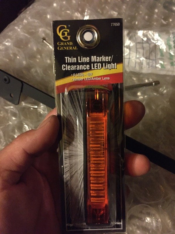

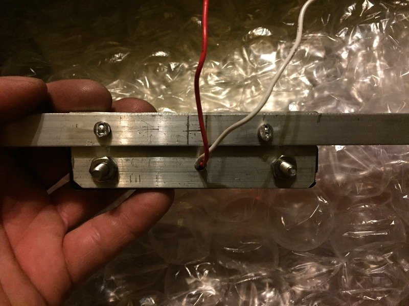

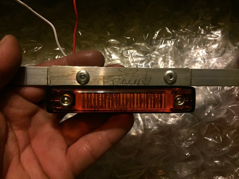

    On another note I finally got done with this Raptor light mod. Took me a while since I made a bracket to hold the lights instead of physically attaching it to the grille b/c I didn't wanna feel sick having to drill into the grille haha. The only thing that I did to the grille was trim off enough to where the middle light would fit in(see pic). At the same time I also installed the Switch-Pro SP8100. That's where I can control the on/off.
    I got 3 of these from Amazon. Everything else is miscellaneous on how you'll be installing it your way, ie. wiring, switch etc.
    5F6A88D5-7243-4BA1-AF43-C1D22CDC6895_zps_c031ebf7b980e4e56d1e9e0ee2f632b7a6d99ecb.jpg

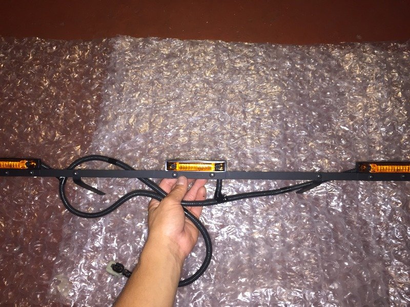

    This is what I came up with. Kind of overkill but I wanted something stealthy and stock/clean to look at.
    D041C3A4-A1F6-4421-96B6-32EDA6C19030_zps_732a889b19d65b43b43c47f55fbe6c9406f2ffd5.jpg

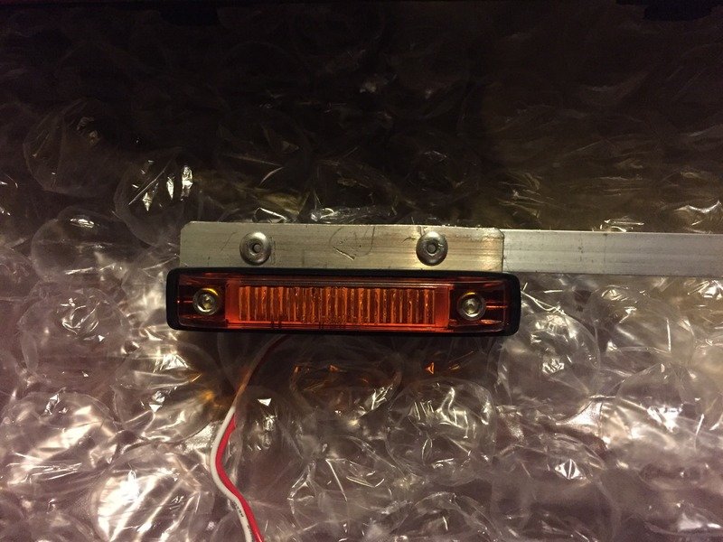

    How each light is attached.
    D0ED8482-7983-459D-BF32-28F68638A3F8_zps_ab4b8a59d8cad7df39cc1cb5cec79b33e30b46ec.jpg

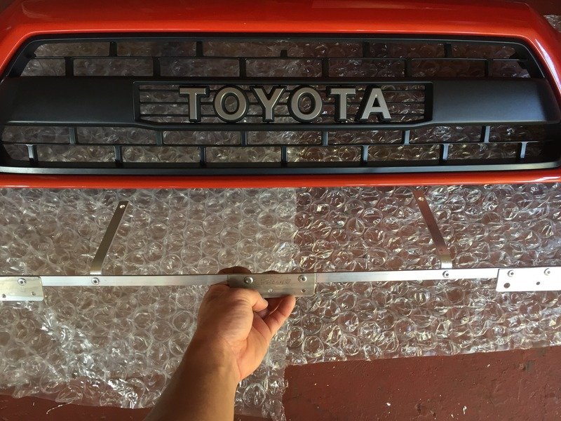

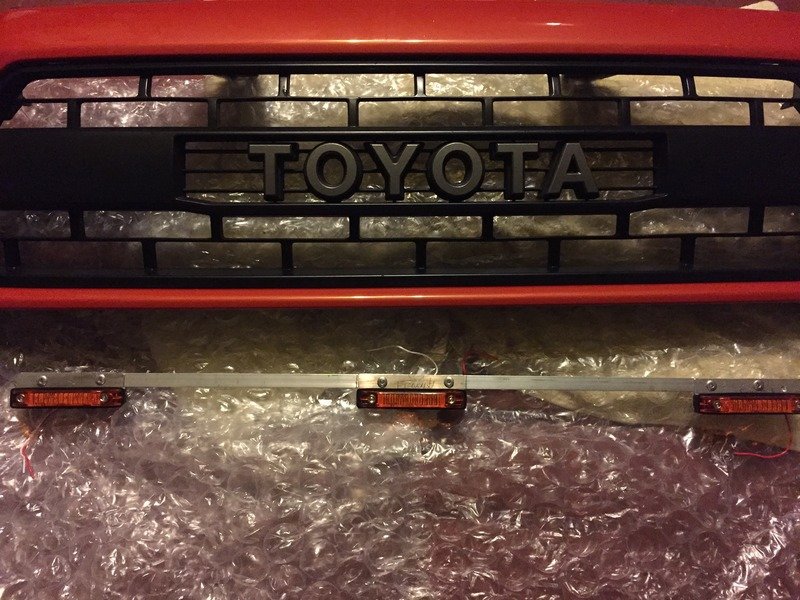

    Final bracket. You can see the 2 vertical bracket from it that'll attach to 2 existing holes on the grille. If you look closely at the grille, you can see the notch that I trimmed(top, between the Y-O)

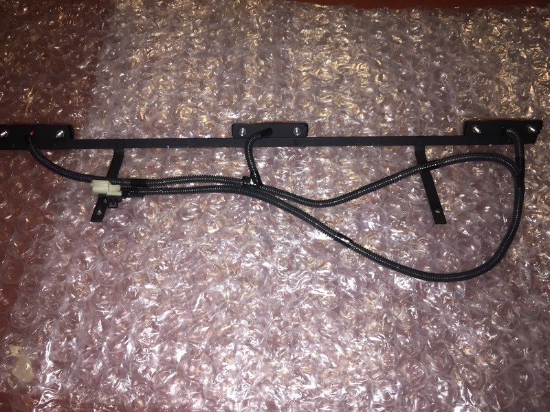

    Painted it flat black. Installed the wiring with a connector.

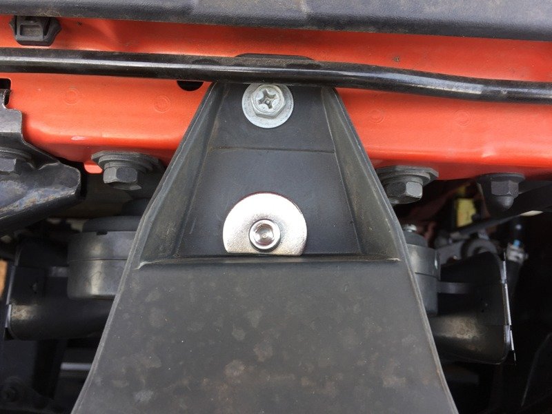

    Existing hole that's used to attach the vertical bracket. Left and right side of the grille.

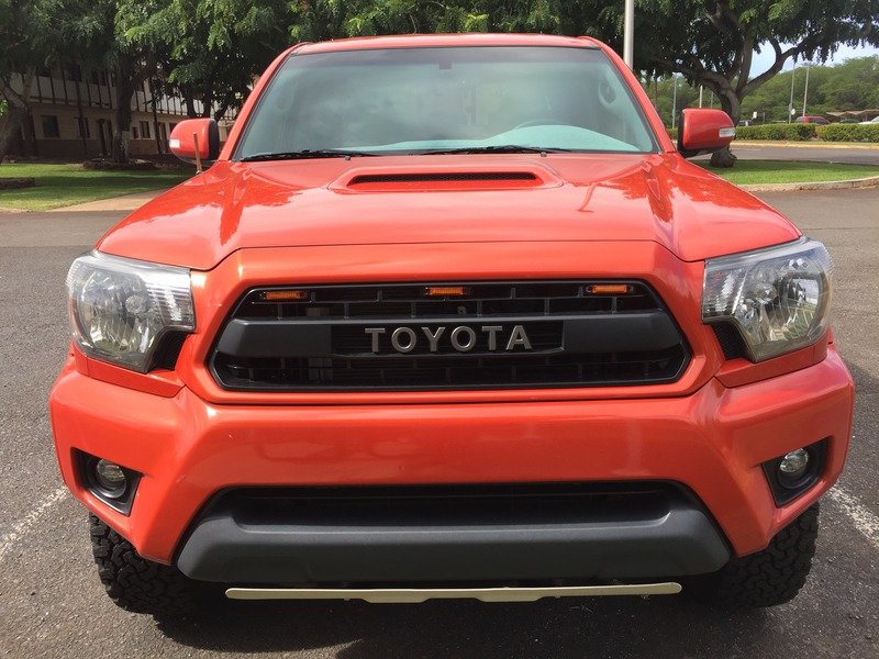

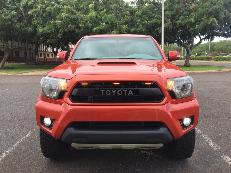

    How it looks.
    Off
    D8C877AE-B4A0-42F1-877C-4D238F35ADBB_zps_274bdff6c9790b4a149f977fcd5368b01eb82d81.jpg
    With DRL's and fog lights on. Not overly bright but bright enough to be noticeable. Love the way it came out. Subtle but at the same time not to over kill on the light output.

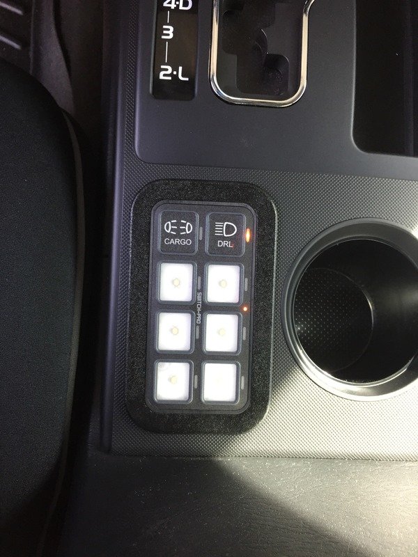

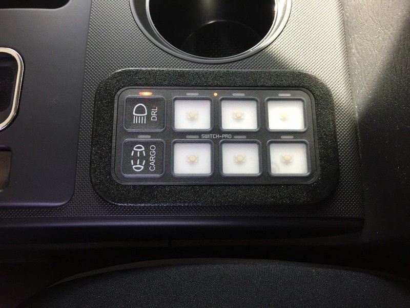

    Switch-Pro that I installed.

    Nice, clean install. Did your shifter surround/cup holder piece come in black or is that something else you did?

    Thanks.
    It's from a base model. Part# 58805-AD010

    That came out really clean bro, great job !!!!
