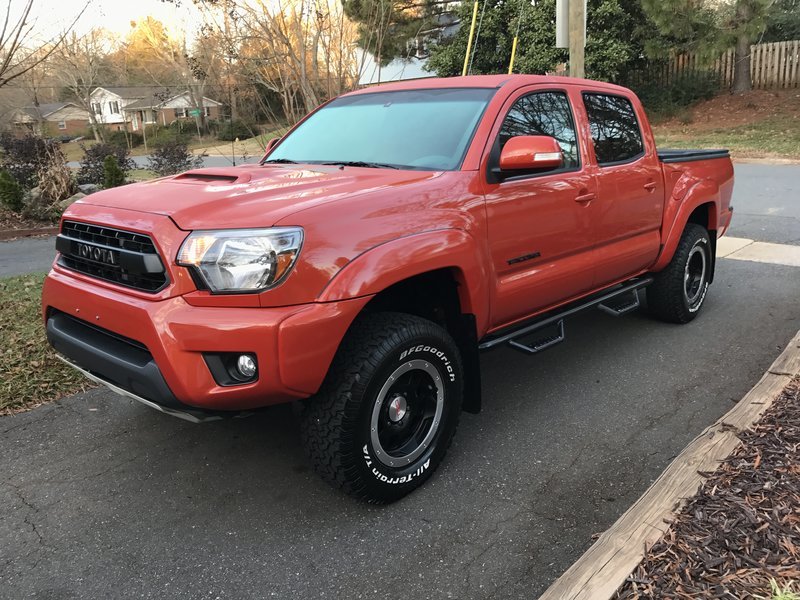

    Congrats man. That Inferno though :thumbsup:

    Congrats! Definitely the best color :thumbsup:

    Solid choice man, when I heard about this truck being released in 2015 I was a little bummed. Damn she looks good!:thumbsup:
