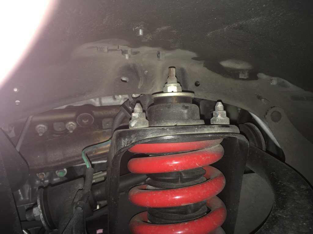

    I planned on doing the toytec spring seat spacer.....but know I may end up doing the 1/2" top plate like Dave did....

    Is this measurement center of the hub to bottom of the fender? My stock Baja is 22.5" drivers side and 22.75' passenger side. Below is a picture and the top looks the exact same.

    Yeah I have a 1/2" spacer on top.
    I don't see why those wouldn't work. Worth trying.
    Easy to install, and they've worked well for me for quite some time now.
    Yeah the spacer under the bucket on mine is what keeps it protruding through the top so much. I didn't think about that when I posted earlier.

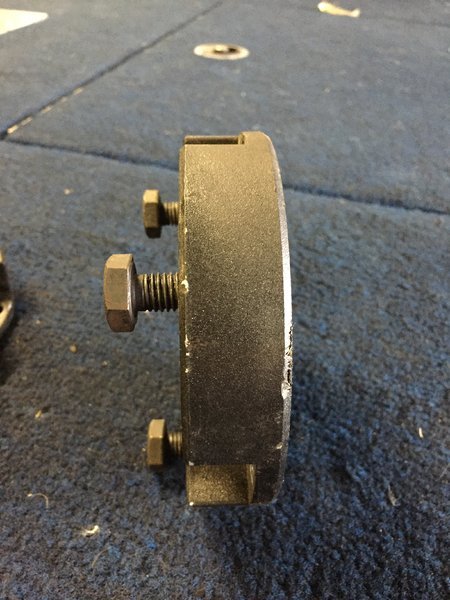

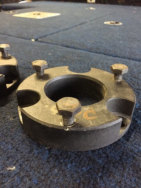

    So how much lift did the 1/2" spacers give you? I have the 1/4" and 1/2" front spacers for the front and did a shackle flip lift for the rear but I will get my Alu Cab explorer cap next month so the rear will drop a bit again. Any way would like to see how much these spacers really lift the front? Thanks in advance

    I couldn't give you a number honestly. Stock Pro plus 1/2" spacers clears 35s with 2.5" of sheet metal and 2" of flare cut away.

    I have 30000 mi on mine with armor/winch and mine isn't sagging like that. I wheel pretty hard too.
