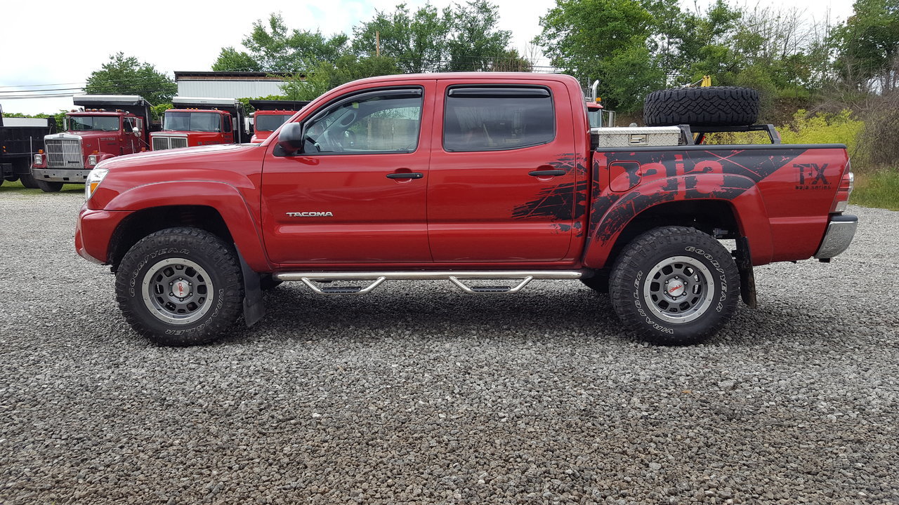

    The Tacoma is already SOA. Like it states above a lot of us get Firestone ride rite airbags, myself included. I just installed a set of used stock leafsprings with Wheelers 3 leaf add a leaf and it gave me 1.5" lift over stock in the back.
    This is with the newer used oem leafsprings and wheelers 3 leaf add a leaf setup without the airbags installed.

    I just reinstalled the airbags today add I only needed 4psi in them to touch the water at cradles, I put 6psi just for minimal air pressure like you're supposed to, gained a moth 1/4" lift in back.
    This picture is before the newer leafsprings and ad a leafs. This is how bad my stock leafsprings were.
