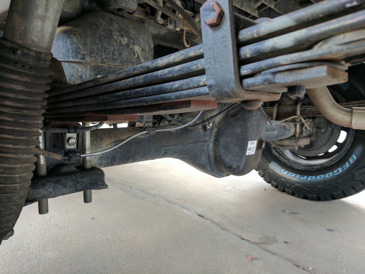

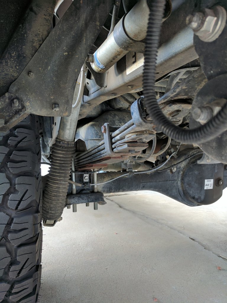

    So I have a 2012 baja, and wondering what leaf springs I have in the back. I thought they were the TSB plus overload, but looks to be two springs added, with overload removed. Cannot find any part numbers or stapms.. Can a second gen baja post some pics of their back springs, or educate me as to what I have? Thank you for the information!!!

    Thats what im thinking.. Measurements are 23.5 midhub to fender on driver rear, and 24 passenger. Whats stock baja height in back?

    From looking around, seems I'm about 1.5 above stock trd of. I wonder if these are the icon aal? without the lower overload?

    Looks like Icon or Wheeler's AAL with overload removed, and that height sounds correct for that setup. The new leaves are the thinner ones, and the thicker ones are stock.

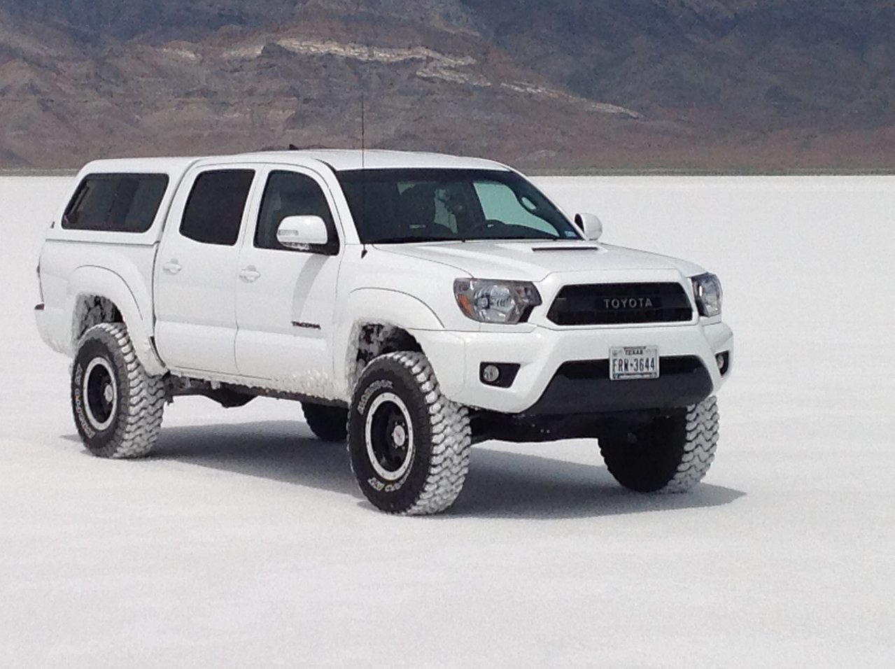

    Another fill up!?!
    IMG_0351.jpg Howdy-
    Just returned from a 4100 mile excursion thru the west, San Antonio to Yellowstone and back. We did Bonniville salt flats, Ouray and Engineers Pass, all awesome places. I don't think I would have enjoyed it as much without my SPC upper control arms as these 2nd gens are a "castor disaster" from the factory. Stays in the lane now with very little attention and no discernible tire wear-- just thought I would share the info.
