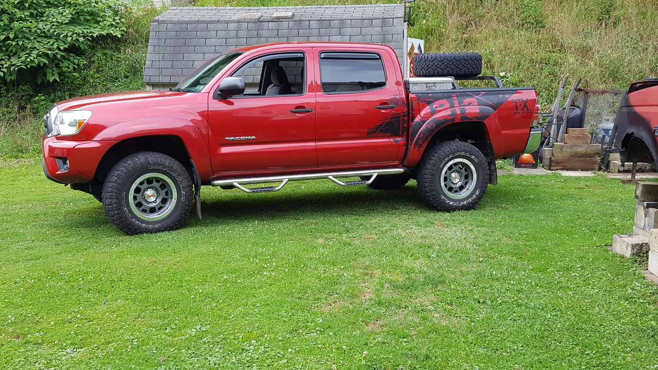

    MidnightRebel07
    MidnightRebel07 If you're gonna be a bear, Be a Grizzly !
    Jun 22, 2013
    #106831
    2,773
    Jerry
    Northside of Pittsburgh, Pa.
    2013 Tacoma BAJA T/X dcsb
    Ironman Foam Cell Pro suspension, Anso black headlight housings, l.e.d. headlights, black taillights, Demello steel front bumper with highlight 7" l.e.d. round lights, Diode Dynamics Amber SS3 Pro lights, Hooke Road steel rear bumper with Nighlight reverse lights, Hooke Road roof rack, Ultima Aluminum toolbox, Weathertech floor mats, EGR in channel ventshades, Snorkel, K&N air filter and cabin air filter, 265/75/16 Cooper ST Maxx, Firestone ride rite airbags, Bentrodders bed reinforcements, too many other things to remember.
    Looks like Wheelers 3 leaf add a leaf with the factory overload removed like it should be setup. I have them on my 2013 Tacoma BAJA as well.

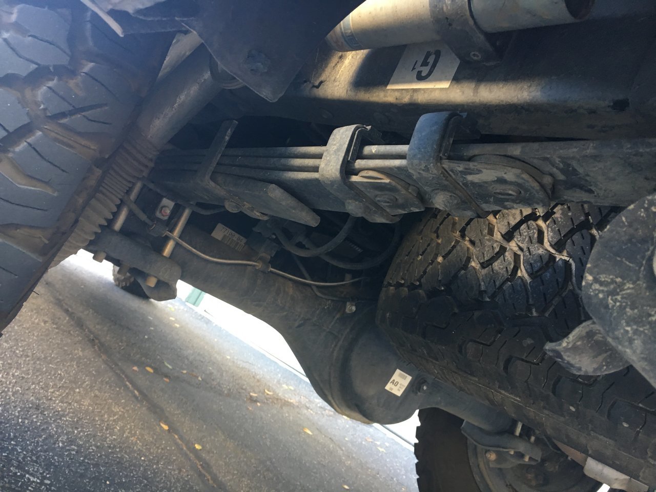

    abqnurse80
    abqnurse80 Well-Known Member
    Mar 27, 2017
    #214544
    987
    Nic
    ABQ, NM
    2012 FJ Cruiser
    Bilstein 5100 all around, first clip front. AVS window visors, BFG AT KO2s. JBL.
    What are the stock leaf springs for a second gen Baja? Are they just the tbs springs? Higher? Anyone can show me a pic? Thanks!
  7. Jul 14, 2017 at 6:00 PM
    #2707
    oni06
    oni06 Well-Known Member
    Jul 1, 2016
    #191029
    3,261
    itaro and abqnurse80[QUOTED] like this.
  8. Jul 14, 2017 at 6:19 PM
    #2708
    abqnurse80
    Mar 27, 2017
    #214544
    987
    Nic
    ABQ, NM
    2012 FJ Cruiser
    Thanks @oni06 !! That means my overload leaf was removed and some kind of 1.5 AAL from Socal Supertrucks. Will be replacing with more progressive and stout alcans soon!!

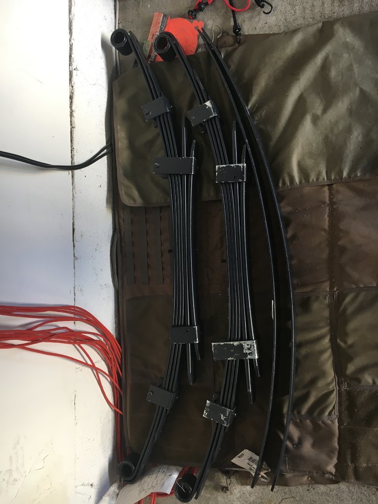

    oni06
    Jul 1, 2016
    #191029
    3,261
    I'm pulling mine off soon and installing these once the rest of the parts come in.

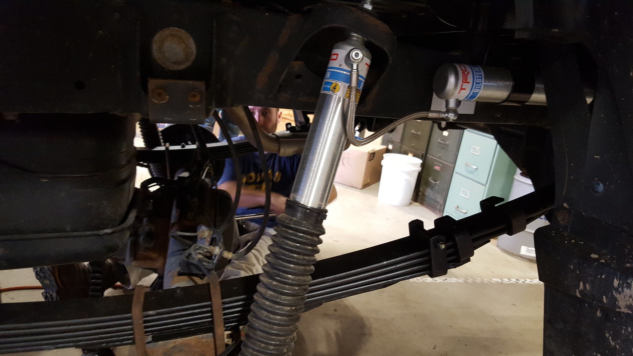

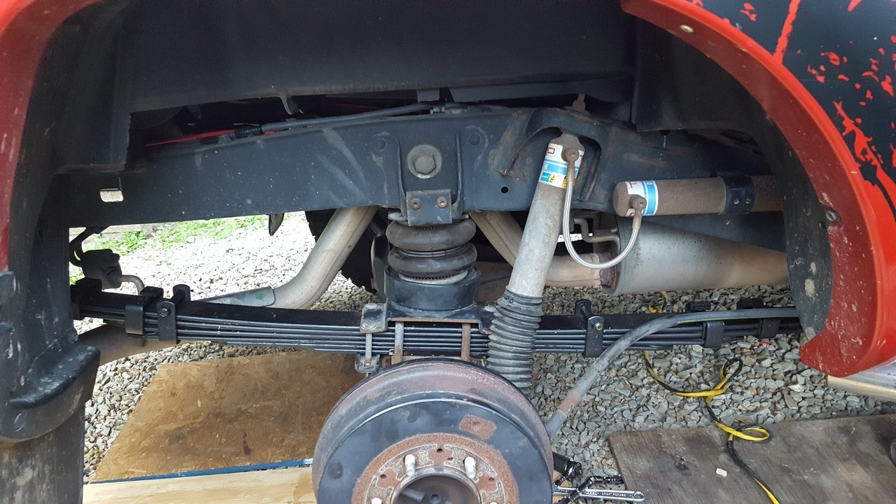

  18. Jul 16, 2017 at 4:22 PM
    #2718
    MidnightRebel07
    Jun 22, 2013
    #106831
    2,773
    Jerry
    Anyone else swap out their 5160's for regular 5100's on their BAJA?
    I had the driver side 5160 blow out and the dealer replaced it under extended warranty (common sense would tell you to replace both sides but not the dealer). My 2013 only has 35k miles on it. So I ended up buying two new regular 5100's for the rear and installing my newer set of leafsprings with Wheelers 3 leaf add a leafs and put my Firestone ride rite airbags with daystar cradles back on. My truck now sits 1.5" over stock height in the rear (with just the leafsprings, not the airbags). Sold both 5160's to another member for $225 shipped. I'll get longer shocks when I get a full 3"lift kit down the road.
    If you've replaced your rear shocks what did you change them to?
    Last picture was right before swapping shocks.
