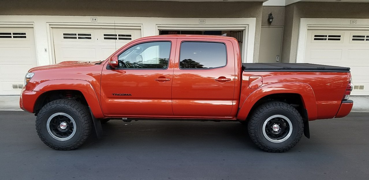

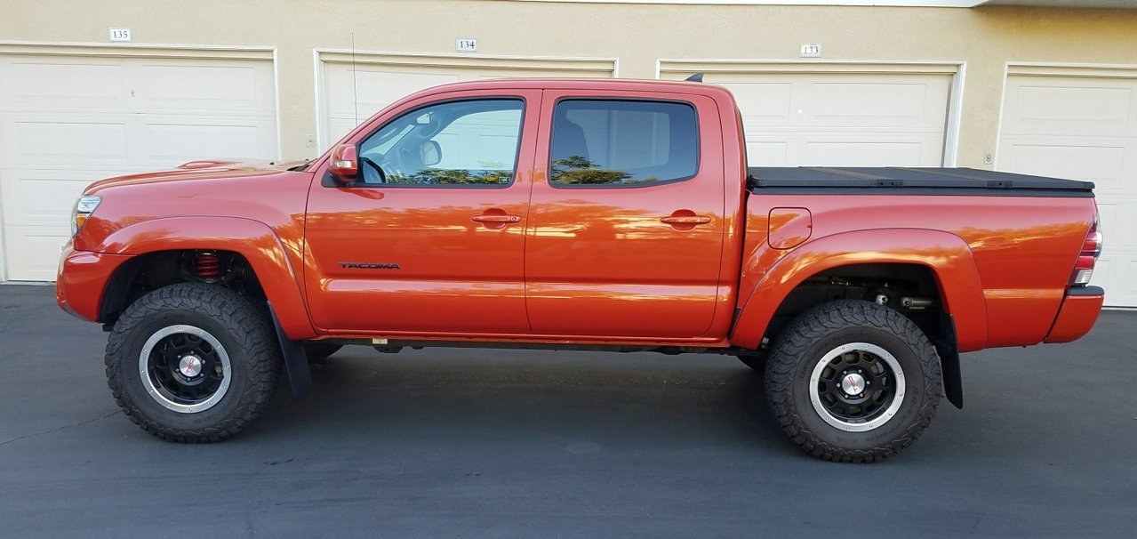

    I wanted to say thanks to JuanitoBunito for encouraging me to lift my 2015 TRD PRO. I installed the ToyTec 1/2" Front Top Plate Spacer Kit in the front and the ToyTec Progressive 3 Leaf Add A Leaf Pack in the rear with the overload removed. I love the look and it seems to ride pretty much the same.
    The only little issue is that now I feel a very minor shutter or vibration from the rear upon slow take-off from a stop. I don't feel it if I floor it from a stop,before lift.jpg after lift.jpg just from a slow take-off from a stop. Anyone else have this issue? I ordered the ToyTec carrier bearing drop kit and the solid steel axle degree shims. I'll have these installed once I receive them and hopefully that will help or eliminate the shutter/vibration.
    Here's the before and after lift photos.....
