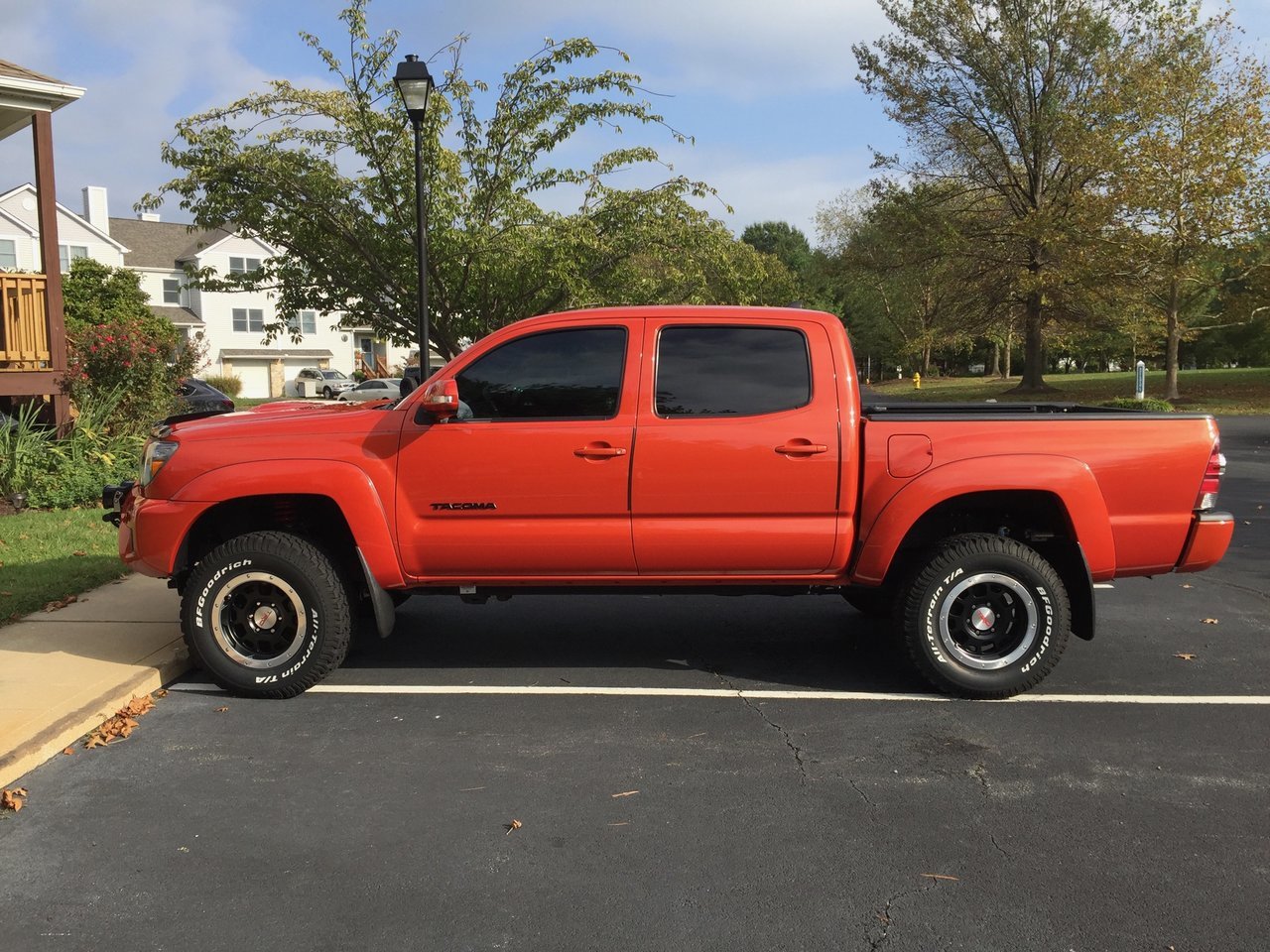

    Here is how mine looks with the Icon 3 leaf progressive add-a-leaf pack and I left the over load leaf in

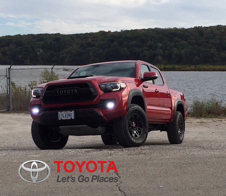

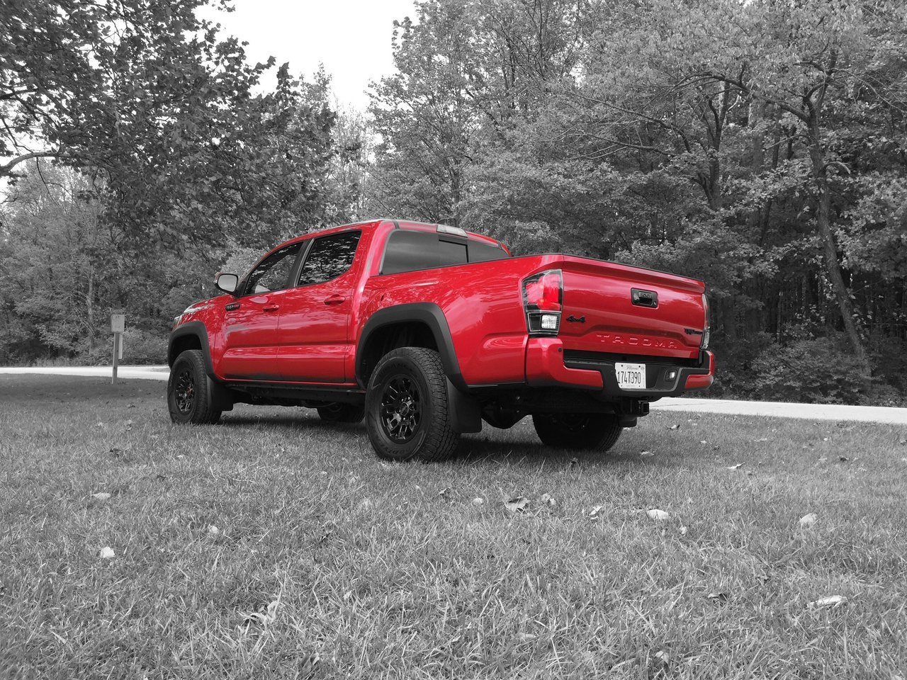

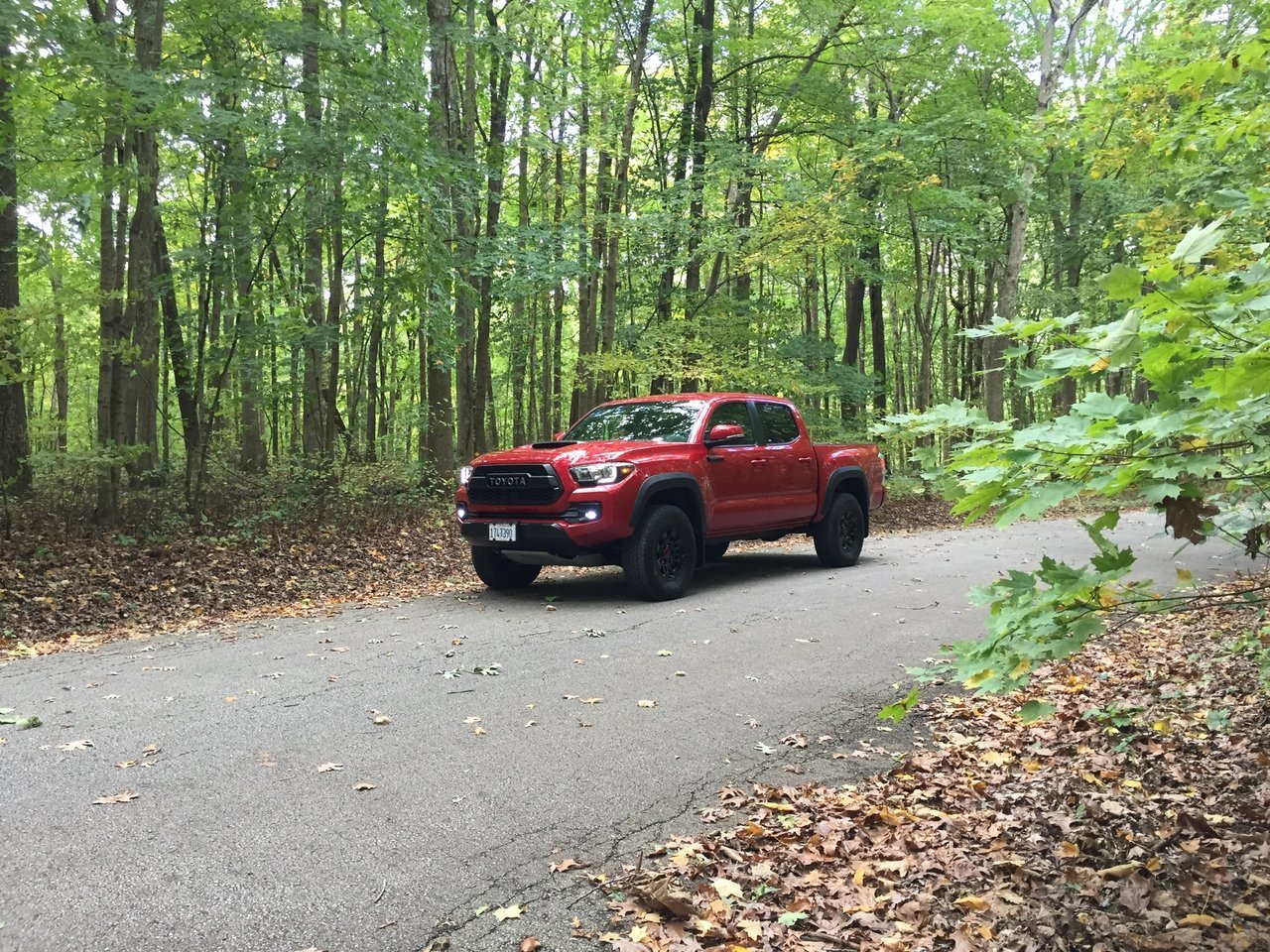

    E7B0DC11-8BD2-4B4B-9871-953C043C2D36.jpg Just found this thread, figured I’d post pics of my Taco Supreme. No mods to speak of. I just ordered a TruXedo Lo Pro last night. Merry Christmas to me!

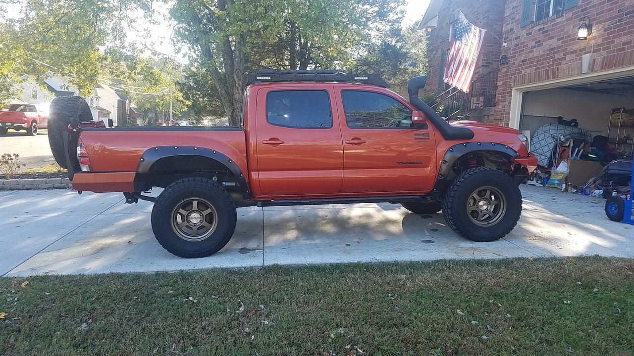

    You'll regret the AAL if you have extra weight. That's why I went to Dakars from the AAL. Granted I have a lot of weight with a high clearance bumper with swing out, spare, and two jerry cans. I did the equivalent of the new Dakar HD with the extra leaf and one overload removed. You would probably be fine with the standard Dakar pack and could add the extra leaf later if you needed to. You could also look into the AllPro Expos.
    This is with 35's, some trimming, and the spacers up front and loaded Dakars out back.

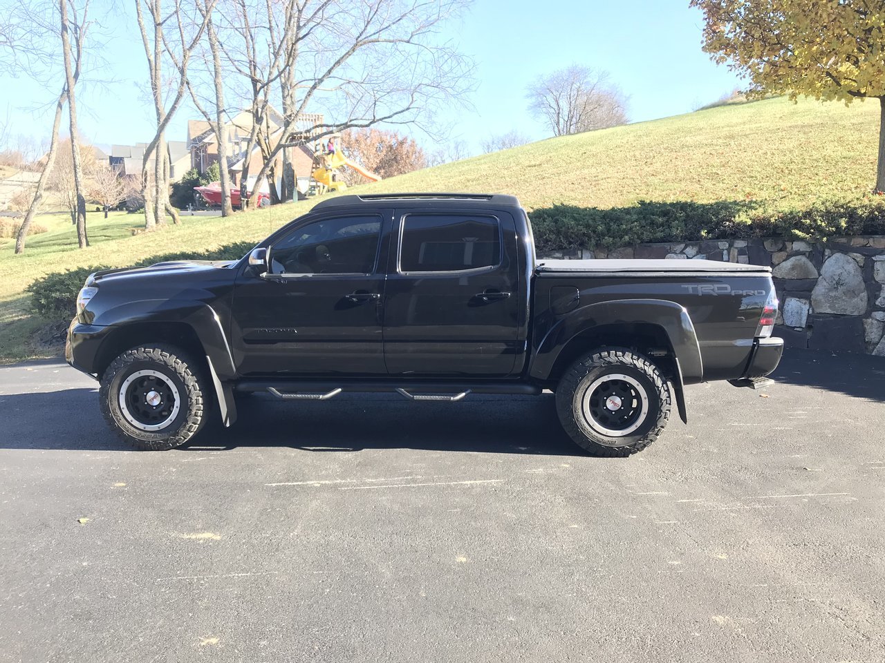

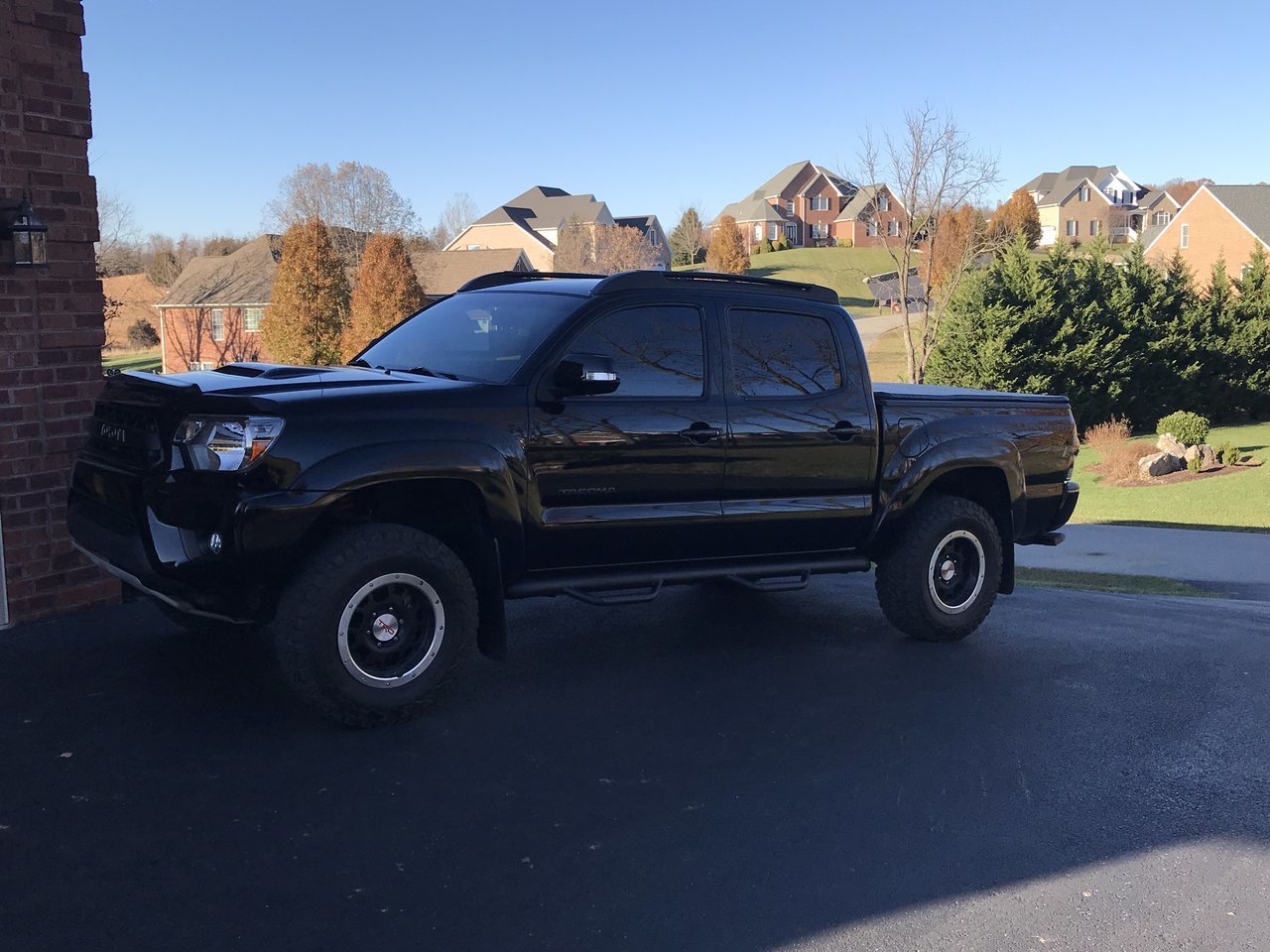

    Finally installed my Firestone Ride Rite airbags and Daystar cradles. Running 5-7 psi, it sits perfect. Oh, and I am horrible about taking before and after pics.
    Before:
    After:
    Sitting in driveway:

    Looks great. How is the ride now?
