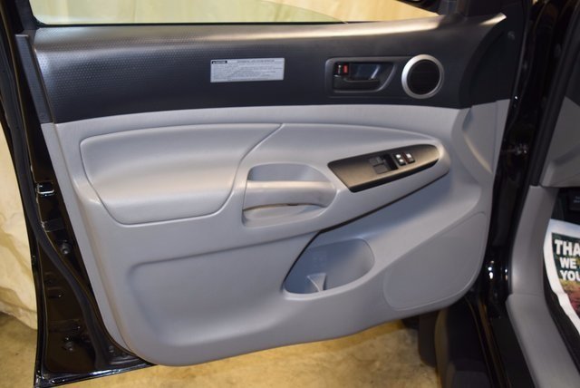

    Saw a pro with this sticker on the door? What is it? Does anyone else have this sticker on their door?

    I have that on my 2013 Baja

    Same here.

    My 2013 Baja had a rear locker operation sticker there.

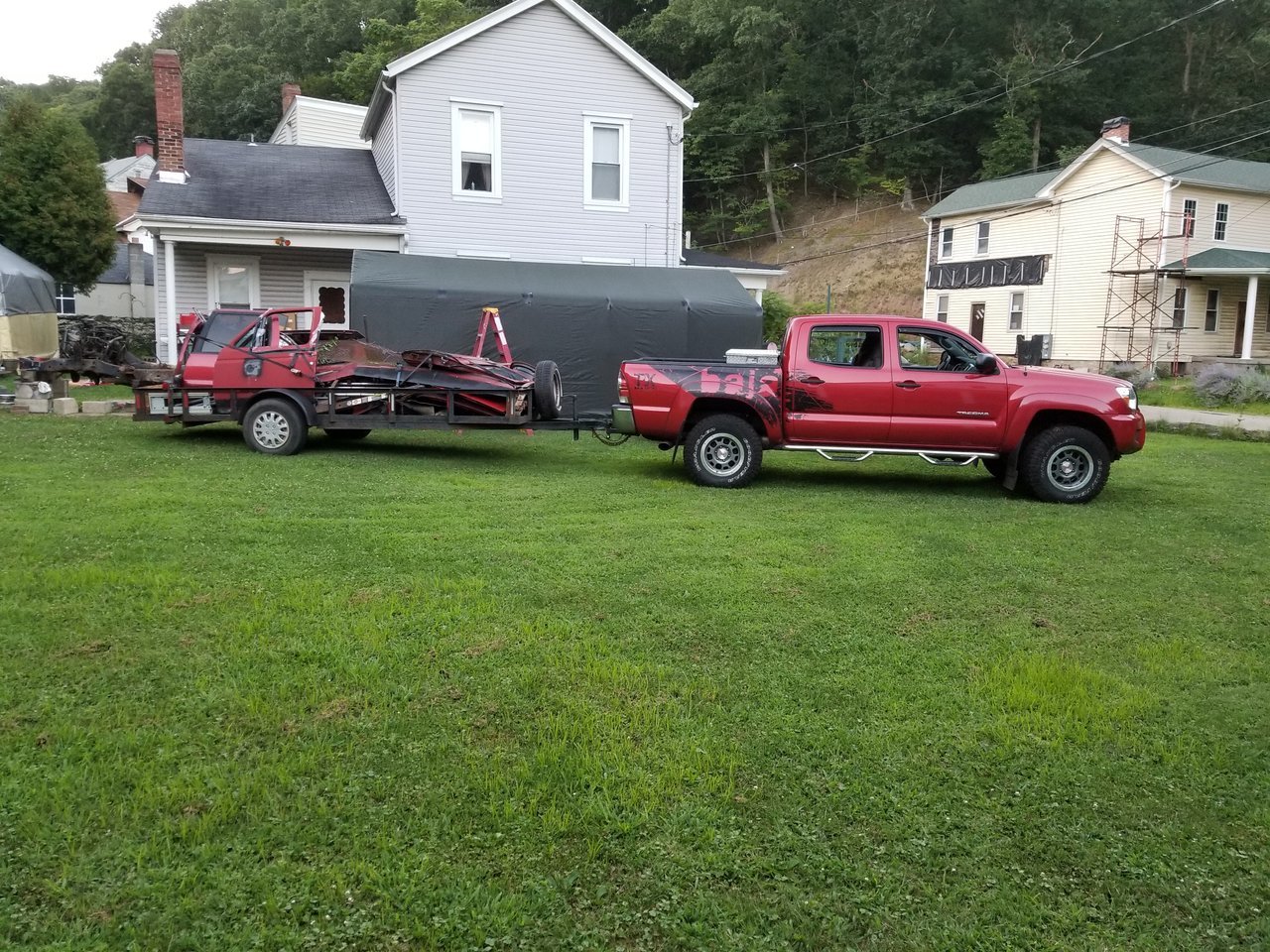

    I have Firestone airbags with daystar cradles and stock leafsprings (with the stock overload removed) with Wheeler's 3 leaf add a leaf installed. I haul and tow a lot so I like having both. I got them barely used for next to nothing so I couldn't pass up the deals. If you haul or tow a trailer you'll definitely want both for added rigidity and strength.

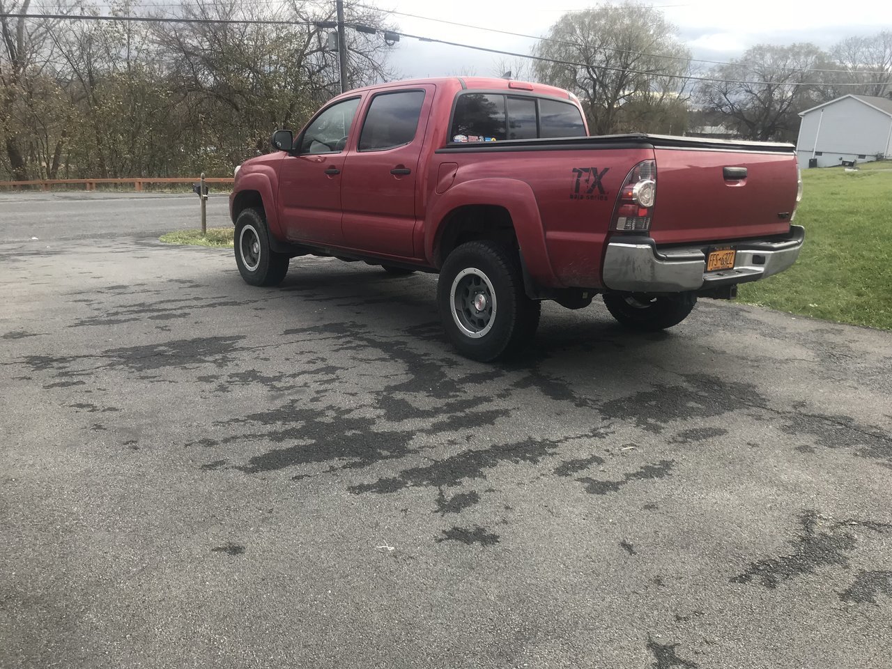

    Well an AAL is under $100 and took about 2 hours to put in (im a crappy DIY mechanic), never have to worry about having air, leaks, etc. Airbags and fullleaf sets are $400-800. Eventually the answer is a new leaf pack, but a $90 AAL buys me a year or so and keeps the bed level.
    I’ve only had about 400# in the bed since putting the AAL with the overload in, it barely moved and I would expect it to be dead level with 1000# on the back.
    This is what it looks like with the AAL and the overload in:
