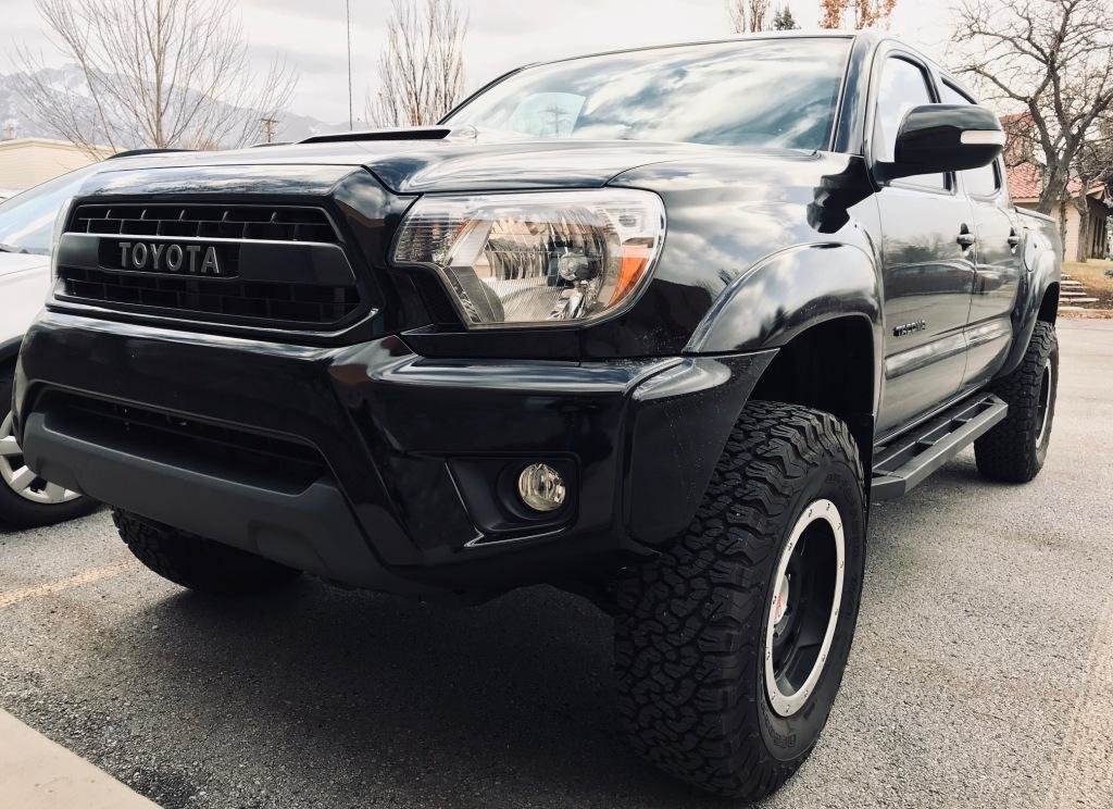

    Just put the wheels spacers on last night. So here it is with the Toytec top plate, 3 leaf AAL, and Spidertrax with 265/75s.
    Still very mild compared to some of y'all's rigs. This thread is full of terrible influences ... I need to stop following it before my bank account is empty. (I'm looking at you @Coot83 @JuanitoBunito @BVita and @Dave41079.)
