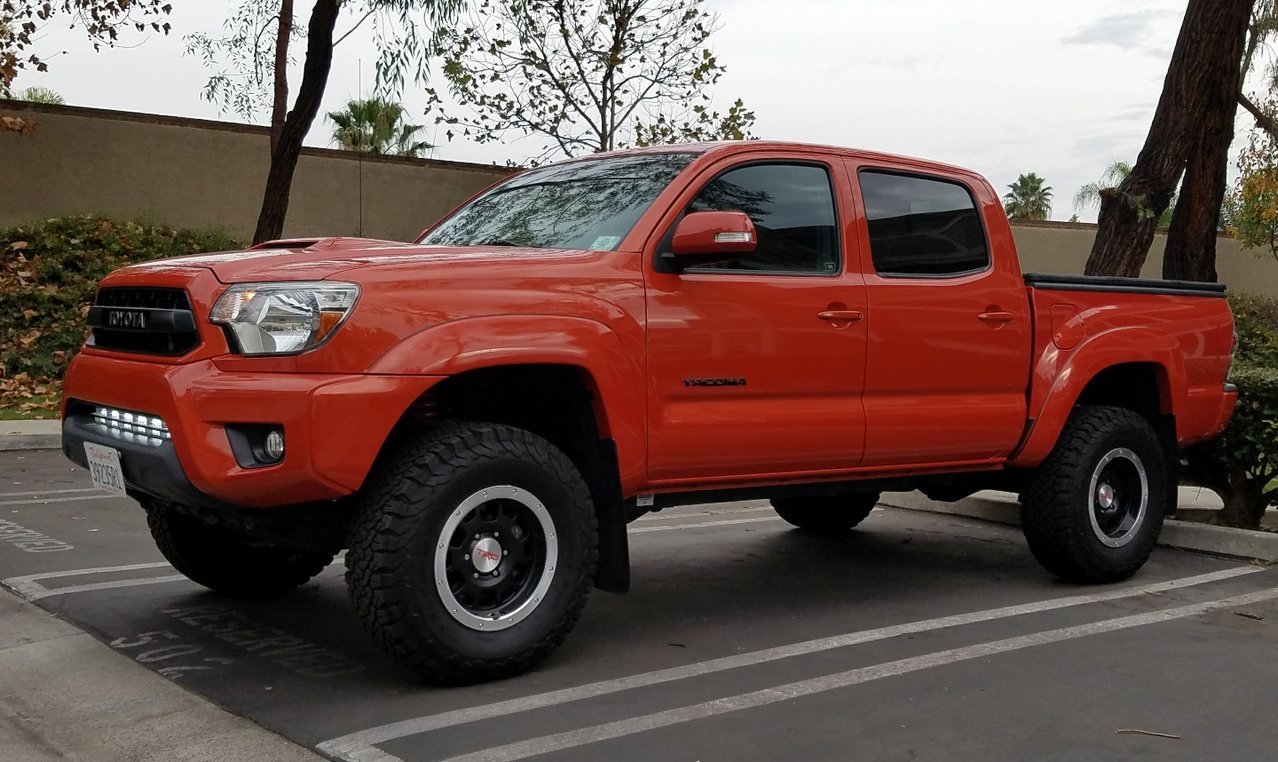

    I installed the ToyTec 3 leaf progressive AAL and it rides great....a tiny bit more firm then stock but nothing too bad. I removed the stock overload leaf. My PRO came with a factory 1.5" lift up front (I believe) and I added a .5" top plate spacer so now the front has about 2" of lift. With the AAL in the rear it looks pretty level although I haven't actually measured it......but I do love the look now and the ride is superb!20180103_143239_resized.jpg
