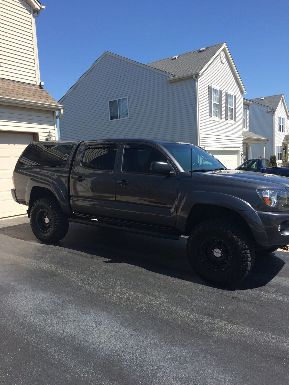

    2013 Tacoma TRD Sport 4x4 DCSB
    2" Lift
    Well, thats good to know. Wonder what length coil I need then for 1.75-2" of lift?

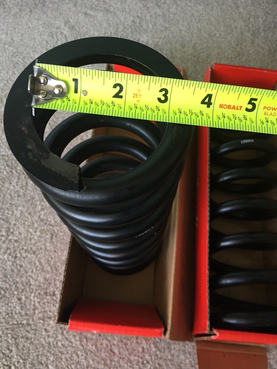

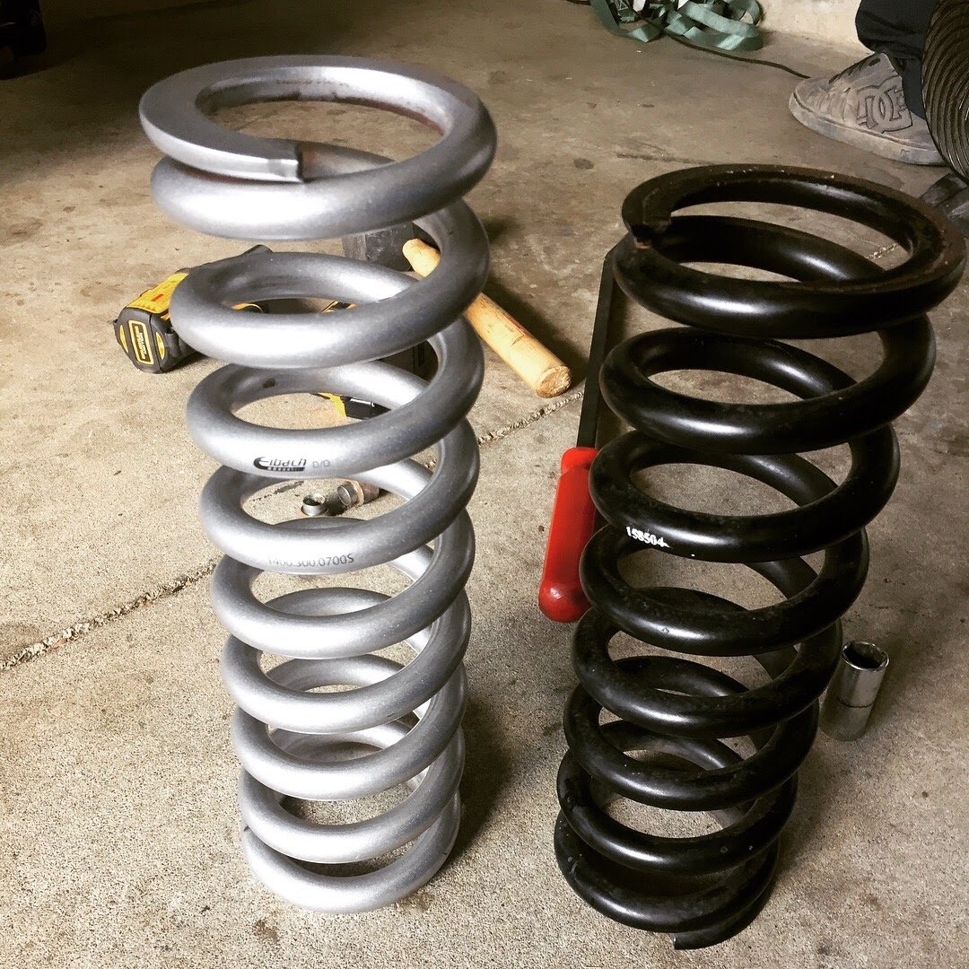

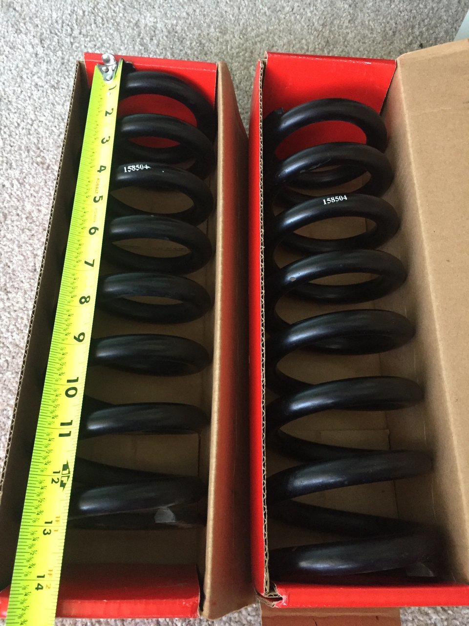

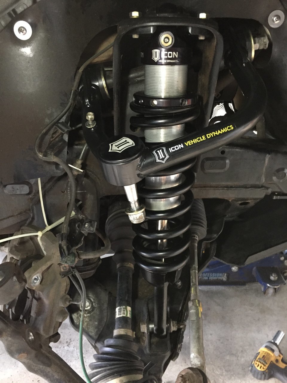

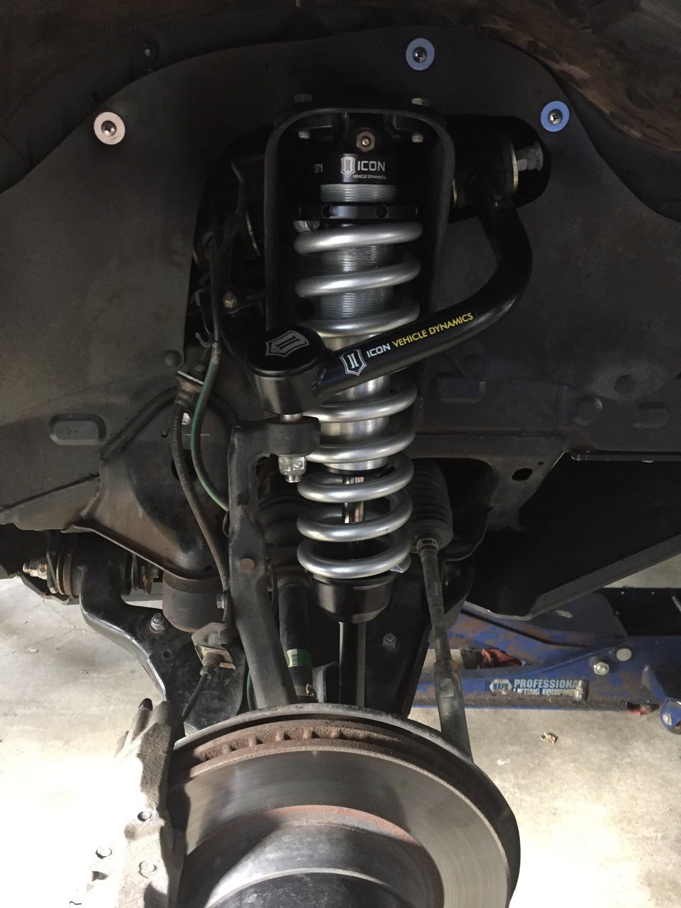

    From my experience, it was the length of the coils and adjustment of the coil over assembly. The spring rate adjust the ride. Meaning, how soft or stiff...how much the nose takes a dive when you break hard...or how much roll you get when you turn at speed.
    I went from the TRD Baja/Bilstein suspension to an Icon extended length system...both had 650 lb spring coils. However, with the added weight of a plate bumper, dual batteries, air compressor, and winch in the front, it felt too soft for my liking. I was able to get a hold of a set of coil springs off an ADS coilover assembly.
    The difference was the Icons were 13" long and 650 lbs, and the ADS/Eibach were 14" and 700 lbs. I had to adjust the Icon coilover assembly to account for the longer coil springs, otherwise I would have been front high with the dreaded taco squat/lean.

    ADS/Eibach coil spring in silver on left, Icon on right
    Icon measurements, 13” x 3”:
    Icon coilover assembly, 13" at 650 lb (note the preload):
    Icon coilover assembly with 14” and 700 lb coil springs:

    Also, I rub on the inner fender on the driver side front when it bottoms out. I do have 285’s but was wondering if anyone else has this problem?

    14' Tacoma sport
    TRD pro suspension, TRD baja rims w/duratracs, rock armor side steps & tonneau cover
    http://toyteclifts.3dcartstores.com/112-620--ToytecEibach-front-coil-lift-springs_p_14.html
    Probably these would do the trick or try a spacer. By checking out your pic it doesn't look too bad I was thinking of doing the same to mine I was wondering if your running an AAL for the rears?

    I have not. No need to change out my CV axles as of yet.
    My lift is less thatn 3", as well.
