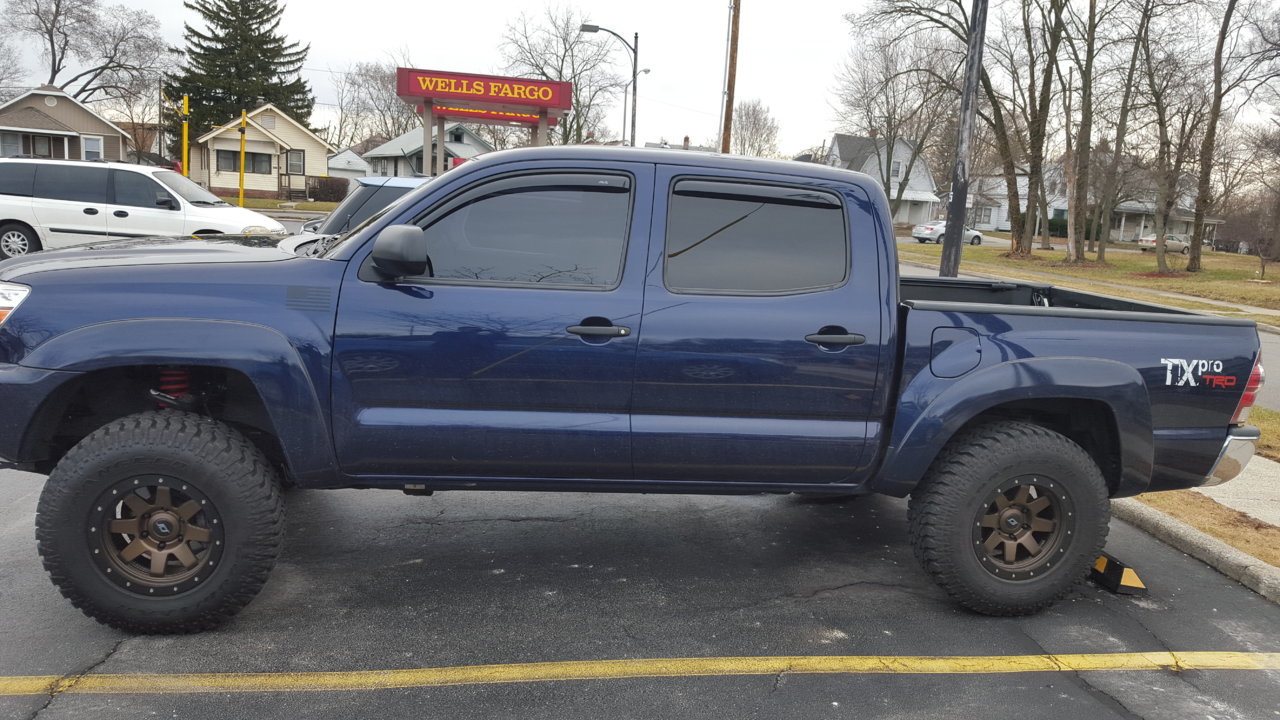

    added a 3/4 top plate spacer, aal going in once I have some free time. on the mean time full bro lean going

    Damn rod I know the feeling there. Dude I think your build thread was one of the first ones I started chatting in. Looks like the scs wheels replaced the red beadlocks!

    Yup I remember, good old red only lasted a couple of months on, until I realize it did not go well with blue lol. I painted the rings black after that and kept it that way for some time, happier now with the SCS Wheels. They have been on for about a week now and couldn't be more please.
