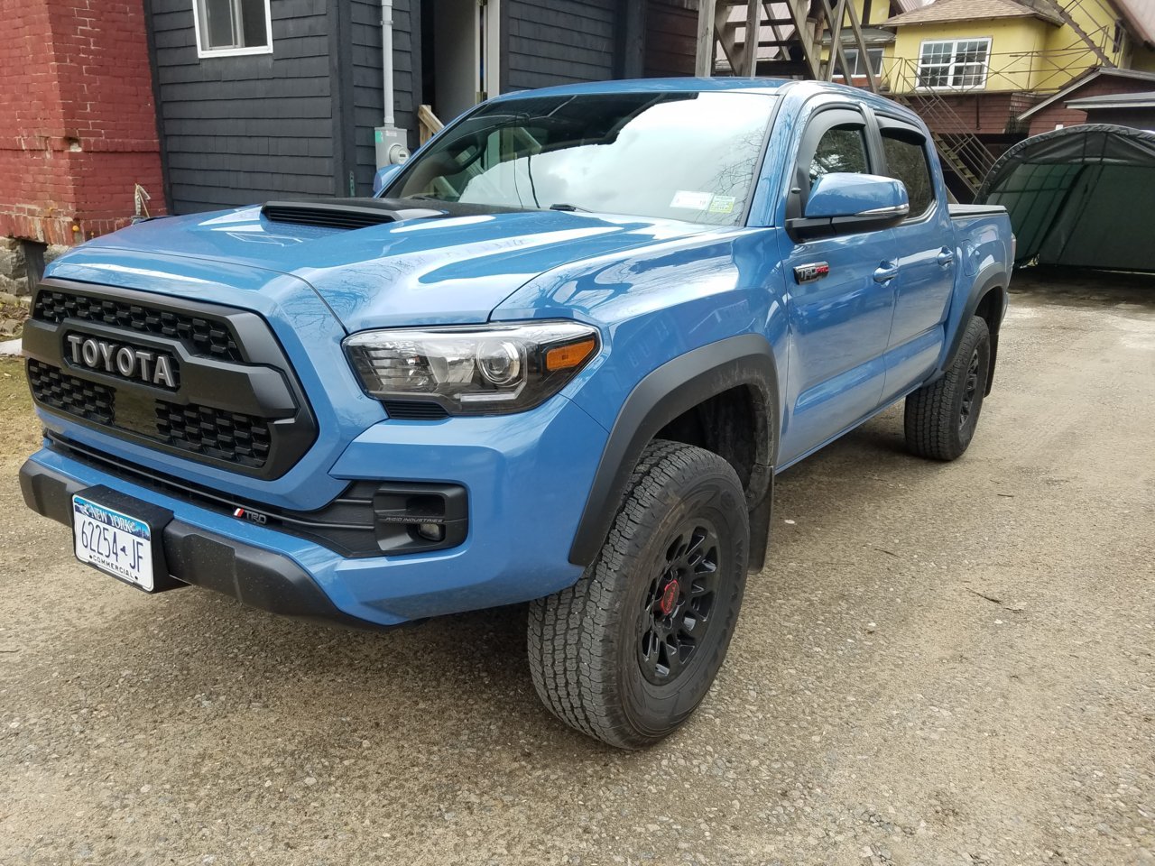

    Here's my 2018 TRD PRO. Traded my 2012 SR5 in for it. Absolutely no regrets. What an awesome and beautiful truck.

    Baja
    I fuckin love that color. I believe I seen one on this island passing by and I nearly snapped my neck
    Scott W[QUOTED] likes this.
