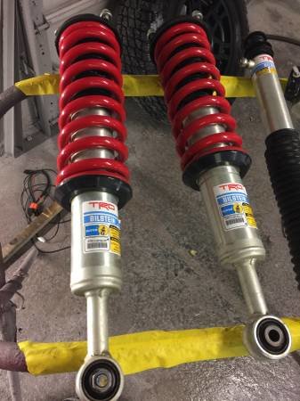

    I think you are right. Both my fronts look to be on the lower ring where the drivers should be on the second (higher) one. I found this picture of what they should look like.
    So that being said, how hard is it to fix this assuming they are actually on the correct sides and don't need to be switched?
    Uninstall and disassemble and move snap ring up one then re-install. Probably need an alignment after as well...
  17. Aug 12, 2018 at 6:02 PM
    #4197
    Black Taco
    Black Taco Well-Known Member
    Jan 14, 2010
    #29356
    1,962
    Rob
    WPB, FL
    TOYOTA
    No mods whatsoever!
    Yes, and yes. Problem solved.
