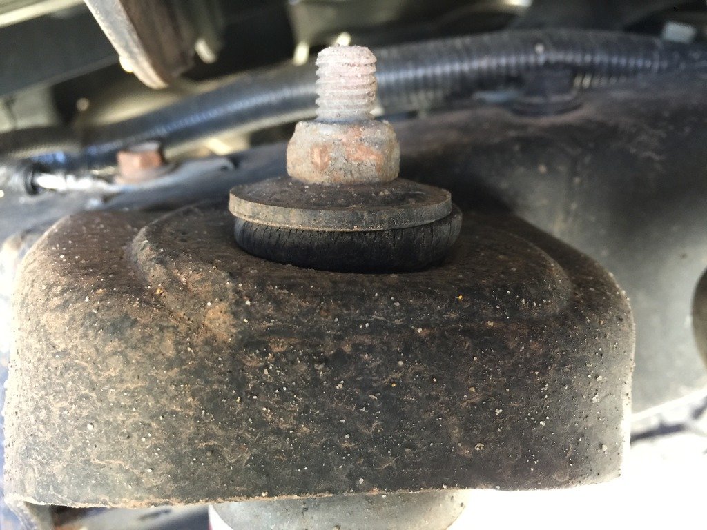

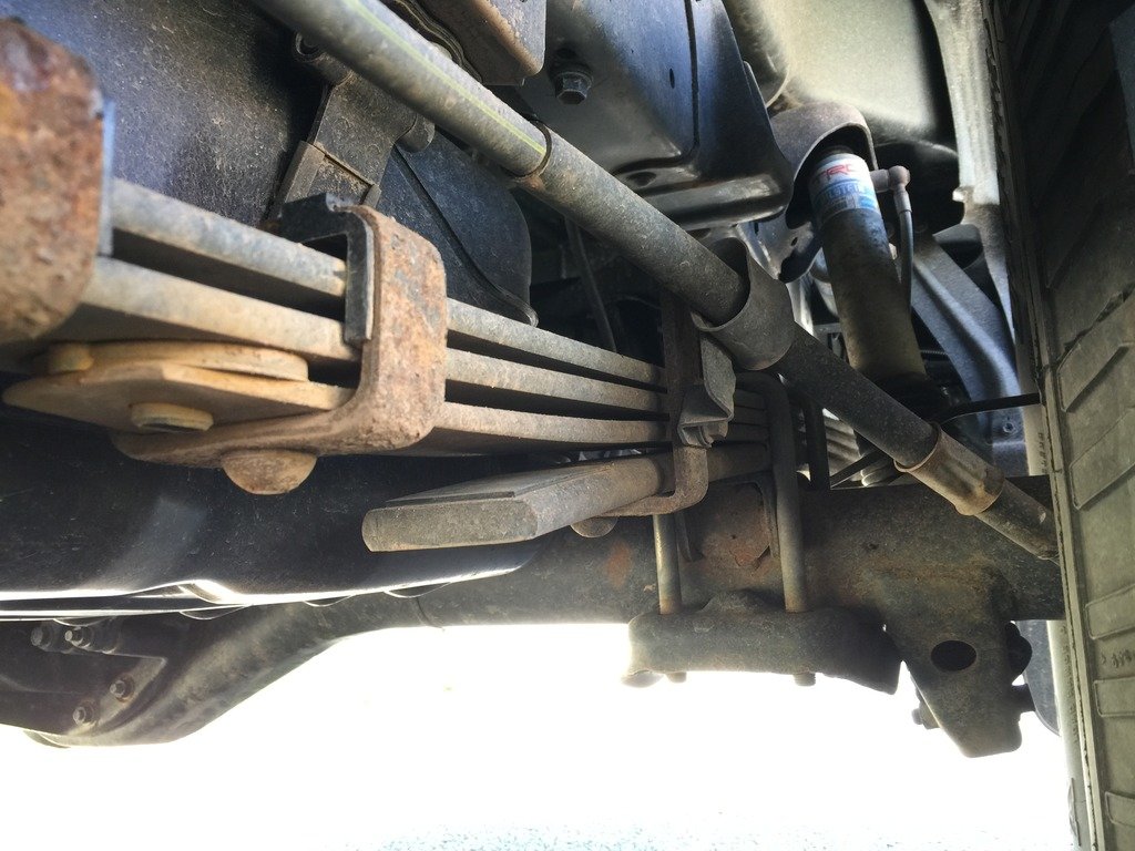

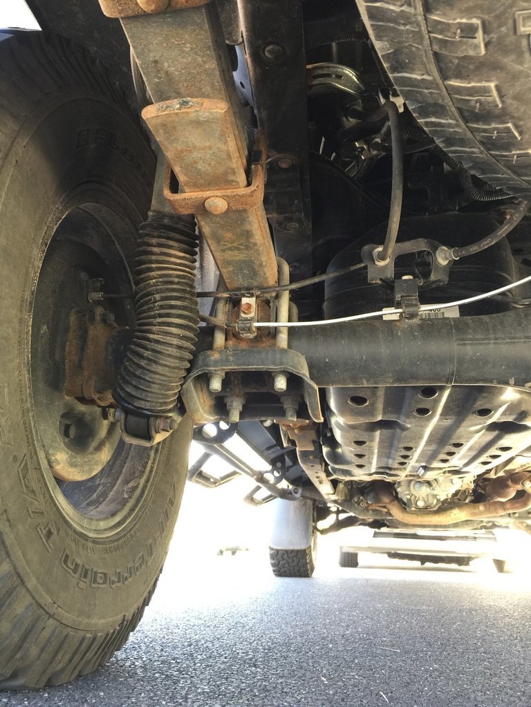

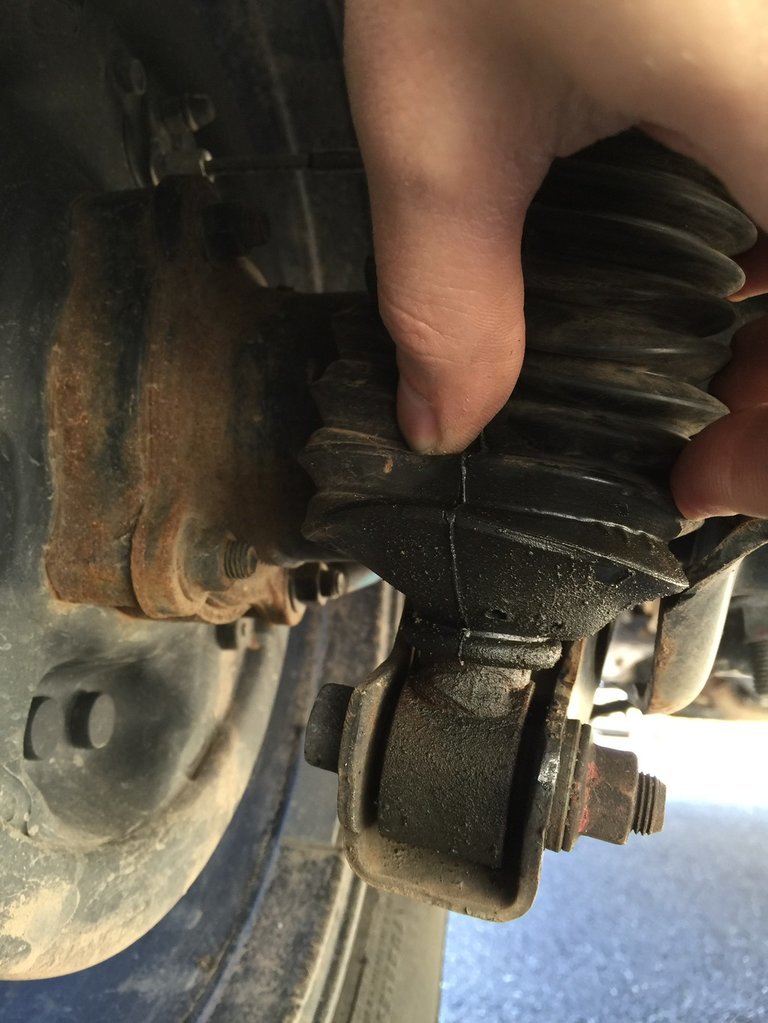

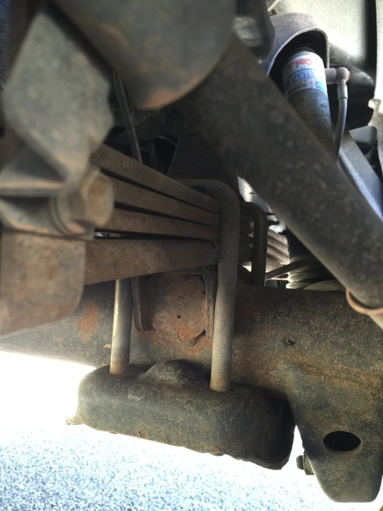

  17. Jun 18, 2015 at 2:33 PM
    #457
    MilesToEmpty
    MilesToEmpty Well-Known Member
    May 30, 2013
    #105224
    345
    Charles
    Frederick Co, MD
    '13 Baja TX
    Wheelers Progressive AAL, Firestone RideRite airbags.
    tacoma3_995fd3221f9b9466bfd3a94646ebe3a9a62b177e.jpg[/QUOTE]
  18. Jun 18, 2015 at 8:24 PM
    #458
    EatMyTacomaDust
    EatMyTacomaDust Well-Known Member
    Apr 22, 2011
    #55366
    1,080
    2014 "Black Beauty" Baja DC 4x4
    ICON 3" LIFT, Console Vault, Tailgate Security Clamp MOD, SuperBumper Crash Attenuator, TRD Front Skid Plate, Wet Okoles - 1/2 Piped, Undercover SE Tonneau
    Completely UNACCEPTABLE. How many miles you got???
  19. Jun 18, 2015 at 8:42 PM
    #459
    JuanitoBonito
    JuanitoBonito Que Pasa
    Dec 29, 2013
    #119422
    9,194
    Juan
    CHI-TOWN
    2024 Raptor
    Yeah....that doesn't look good at all
