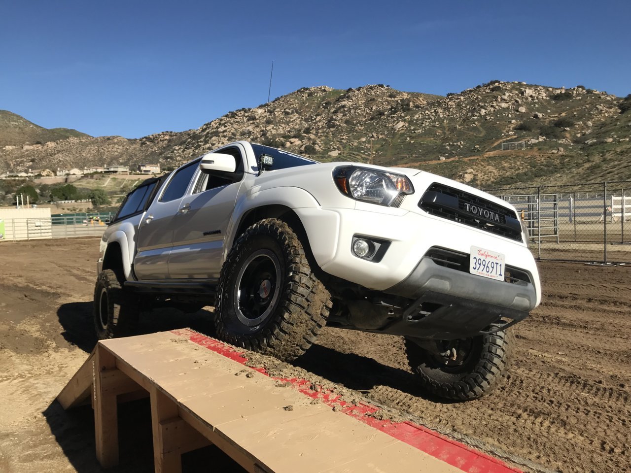

    @Tonk 2014 hope Toyota helps with labor!
    Stuffed the suspension today, everything is looking good. Now it’s time to get some spring hangers and a shock relocation kit for more travel!
