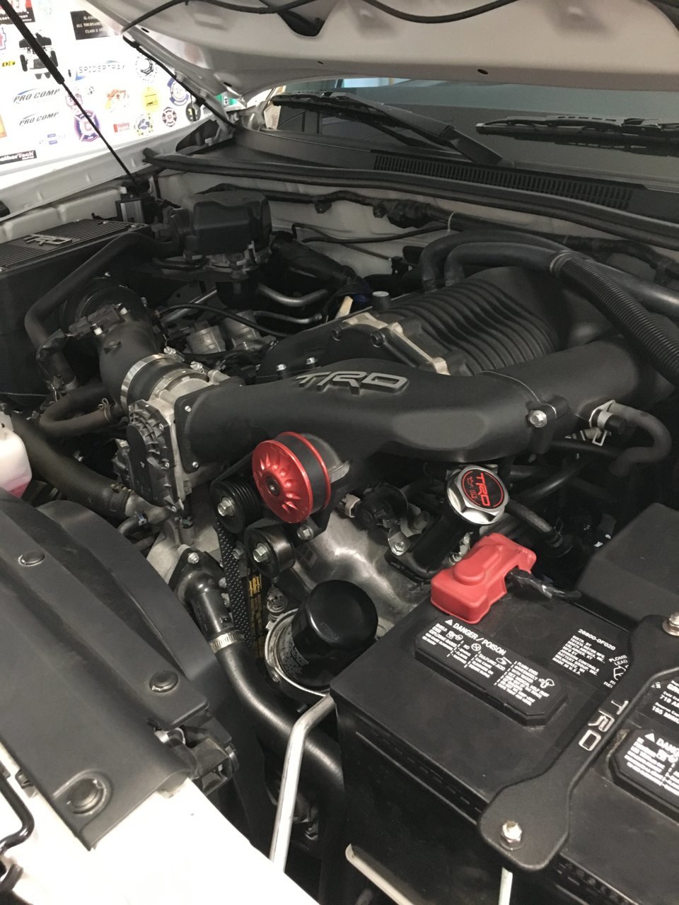

    Yea for sure! Let me just finish up the final version. The current tube is too short. I’m not sure if I’ll cut it in half and add another coupler, or get a 45° elbow instead of the 90° that’s on it.

    I would maybe add a mesh grill or screen to the front of the intake to keep bugs and other road debris from making it's way in there.

    It’s not exposed to the air head on. The lip of the rad support goes down in front of it and then the air goes in. Nothing but dust will get through. Rain won’t even be an issue.

    '15 TRD Pro Super White
    Volant 38640 ram air scoop
    90° 4.5” to 3.5” silicone elbow
    3.5” “hump” straight coupler
    I used a 3.5” x 6” long intake pipe that is too short in my opinion. I’m going to cut it and add a 3.5” straight coupler.
    The intake elbow and scoop opening aren’t exactly straight dead on. So, I’m not convinced a longer pipe will fit nicely. That’s why I went with another coupler that will have some give to it.
