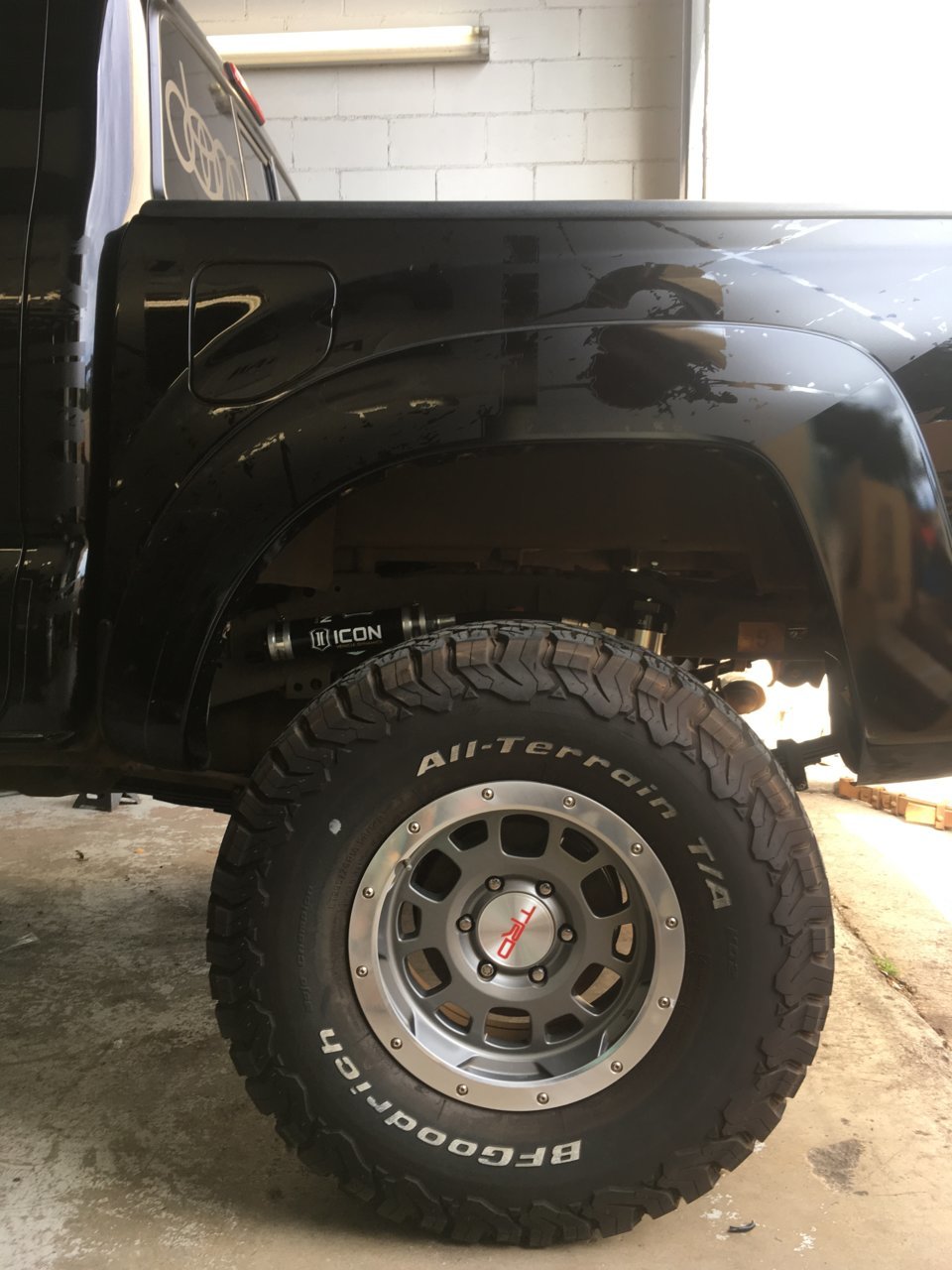

    Baja
    Icon RXT leaf pack(option 1) and RXT rear shocks with remote reservoirs are on! Shop currently working on the fronts
