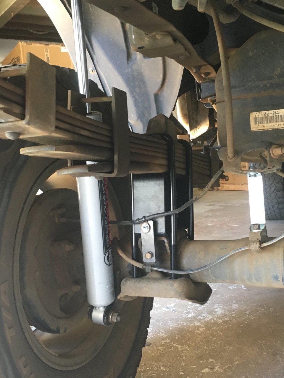

    U-bolts trimmed about 3/4" down to line up with the top base of the bumpstops.
    And I saw a block party for some seriously long u-bolts:

    Damn those are big lift blocks. That's a good way to brake leafsprings.

    You can see it bending against the arch. I don't want to be near that truck at all on the road or anywhere

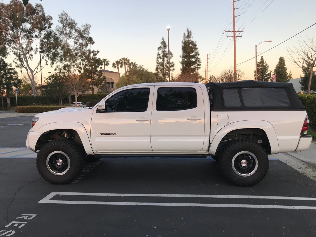

    Chopped the stock overloads into mini blocks and installed them last night :cool:

    Looks great, but why not just keep the entire overload leaf for the extra spring support? Or did you chop and stack?

    @JacksonTacoma I have a progressive aal, just wanted the additional height from the mini block :)
