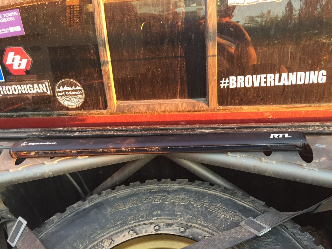

    More pics and specs of your tire mount, broham?!
    Coot83[QUOTED] likes this.

    I will snap a better pic tomorrow...its just a basic kartek 3 point harness to strap the wheel down on the bed with a bike lock threading through the wheel so it doesn't get jacked. Works well when flying through stuff.

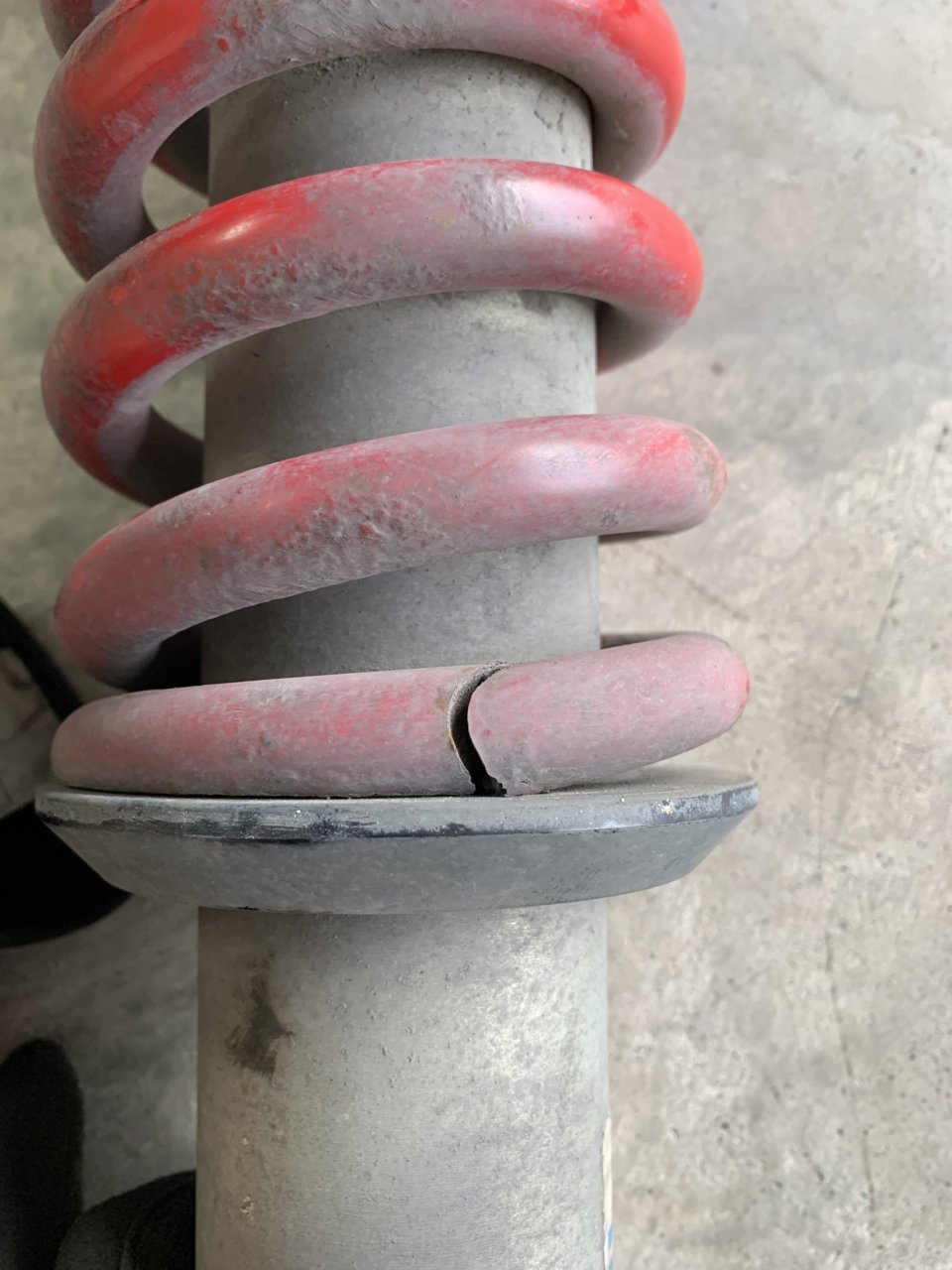

    MYKOSPRO
    MYKOSPRO Well-Known Member
    Sep 12, 2018
    #266082
    340
    Houston, Tx
    15’ TRD Pro
    This problem happened to me. I recently replaced my LCA due to seized cam bolts and while I had it apart I was going to install the 1” Baja spacer. After having the shocks off the truck I found that the coil had cracked. My pro has 58k and I purchased it with 40k. So not sure when it happened or what caused it. Truck was from the east coast so maybe the salt?
    I’m now in search of replacing the coils. Since this kit is discountined, I find it hard finding just the coils for sale. I’ve come across used icon coils for sale which seem to be a good replacement due to it being 13” length and 650lb spring rate.
    Would these be a good replacement? Also, what kind of lift would I achieve if i installed 14” king coils, as it seems these are more popular being sold used. I’m not quite ready to upgrade suspension as it seems my original shocks are still in good condition.
    Here’s a photo of the cracked coil.
    13txtaco and BVita like this.
  12. Apr 26, 2019 at 10:48 AM
    #5252
    BVita
    BVita Mall Cruiser
    Jun 30, 2014
    #133048
    3,971
    Standard 600# eibach coils should work?
    If someone else wants to chime in. lol
  13. Apr 26, 2019 at 10:55 AM
    #5253
    JacksonTacoma
    JacksonTacoma Well-Known Member
    Jul 25, 2017
    #224953
    1,185
    James
    Jackson, MI
    2015 S/C TRD Pro
    Magnuson SC, 2.5 pulley, hptuner, FPR mod, AFE Intake, URD longtube headers, JFR Y-pipe, 255 Deatschwerks, 76mm TB, Banks 3" exhaust, cam gears
    I thought the TRD coils were just rebranded eibachs? Could be wrong idk
  14. Apr 26, 2019 at 10:59 AM
    #5254
    BVita
    BVita Mall Cruiser
    Jun 30, 2014
    #133048
    3,971
    Thats what I thought, I just don’t exactly remember if they were 14” aswell
  15. Apr 26, 2019 at 11:01 AM
    #5255
    JacksonTacoma
    Jul 25, 2017
    #224953
    1,185
    James
    Jackson, MI
    2015 S/C TRD Pro
    Same break where mine did and one other guy I know of.
  16. Apr 26, 2019 at 11:36 AM
    #5256
    JuanitoBonito
    JuanitoBonito Que Pasa
    Dec 29, 2013
    #119422
    9,194
    Juan
    CHI-TOWN
    2024 Raptor
    What springs did you replace them with
  17. Apr 26, 2019 at 11:43 AM
    #5257
    boostedka
    boostedka Well-Known Member
    Sep 29, 2011
    #64367
    6,061
    James
    NM
    2013 DCSB 6MT, 2004 4runner
    I have some new FOX coils. 13"x3" 600lbs. If they'll work and your interested I can sell them to you for cheap.
  18. Apr 26, 2019 at 11:56 AM
    #5258
    JacksonTacoma
    Jul 25, 2017
    #224953
    1,185
    James
    Jackson, MI
    2015 S/C TRD Pro
    The dealer replaced the broken one with that OE TRD Pro spring. I was able to find another TRD pro one online and had both replaced.
    I know they were not easy to track down
  19. Apr 26, 2019 at 11:58 AM
    #5259
    JacksonTacoma
    Jul 25, 2017
    #224953
    1,185
    James
    Jackson, MI
    2015 S/C TRD Pro
    Not sure about the Baja Springs. There may still be plenty out there
  20. Apr 26, 2019 at 12:32 PM
    #5260
    JuanitoBonito
    Dec 29, 2013
    #119422
    9,194
    Juan
    CHI-TOWN
    2024 Raptor
    Found the Baja springs for $99. This is the cheapest I’ve seen them.
