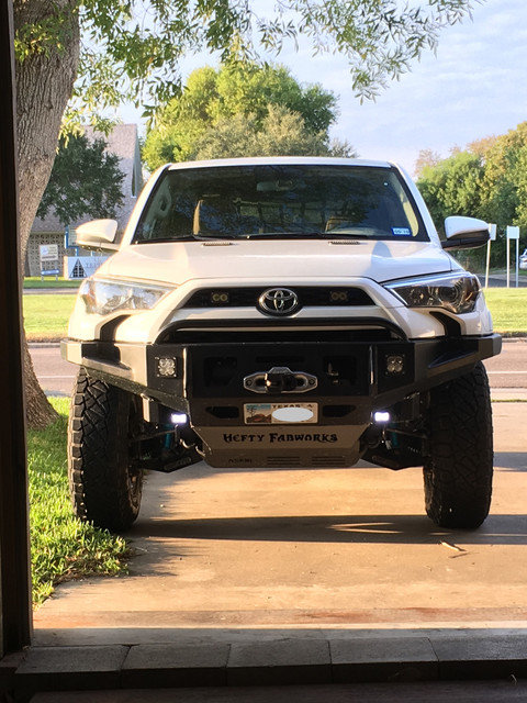

    Pic below on my 5th gen the cut off is awesome but the KC's have the same cutoff with far more throw. These things are tiny and they fit in a nice little pocket on my 5th gen so they are well protected and help a ton with the crappy azz 5th gen headlights while staying DOT! They should fit the SR-M mounts for a tacoma I am pretty sure this is the same light. https://www.rigidindustries.com/sr-m-series-sae-fog-light-pair-902533.html

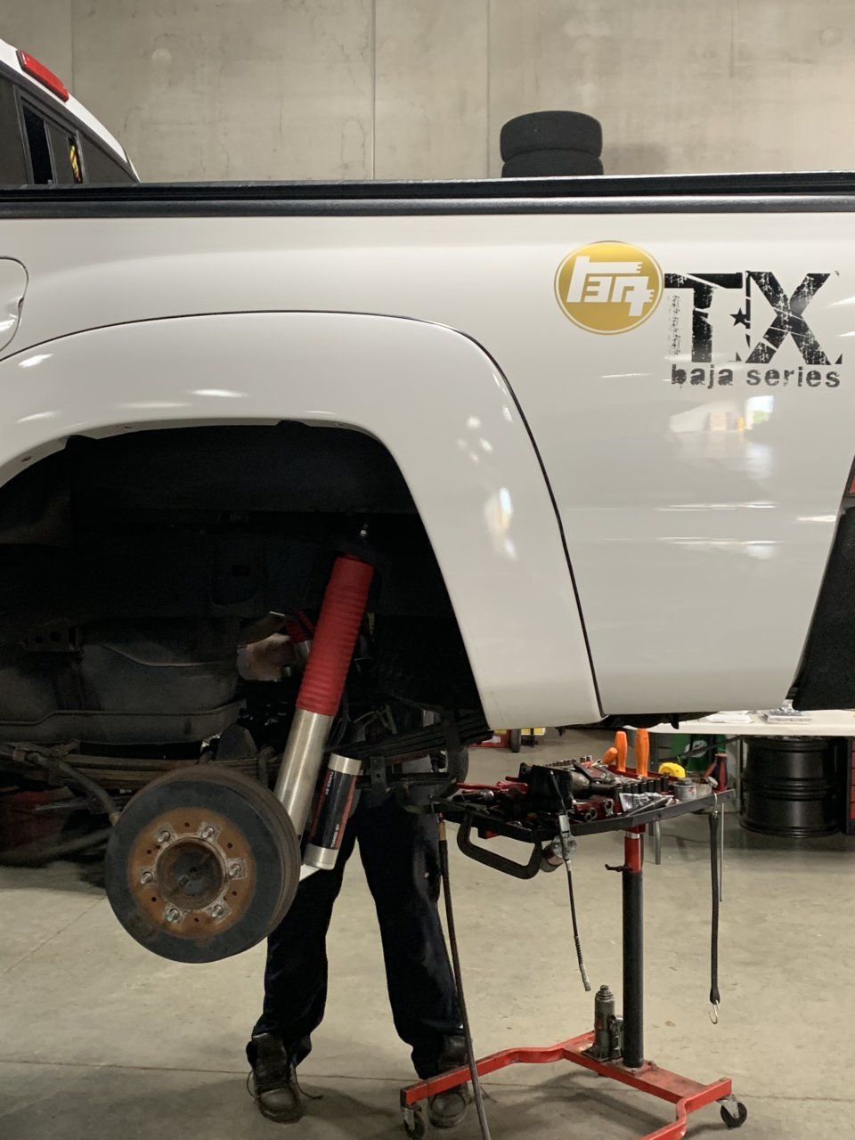

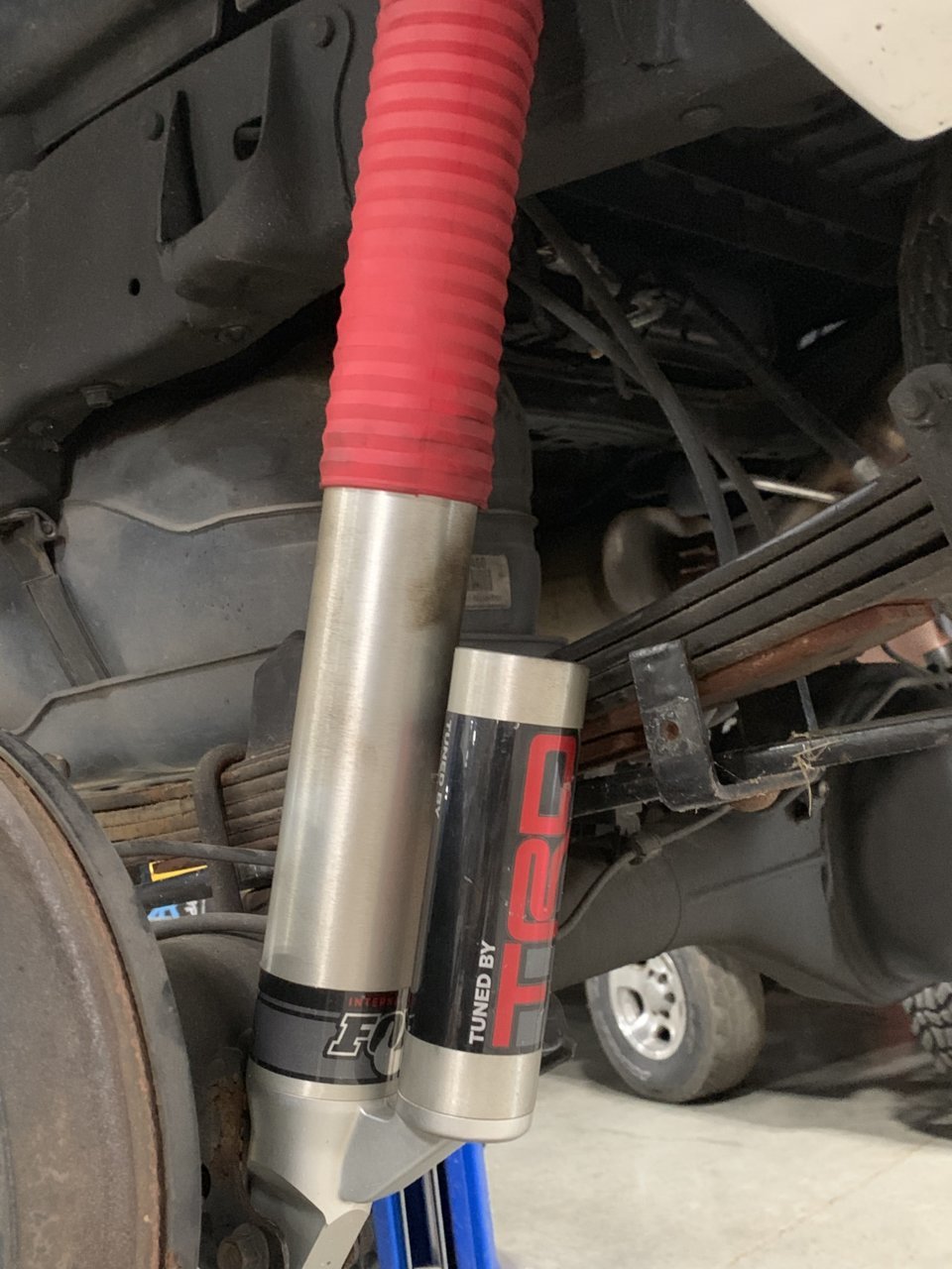

    I did a little something today......
    - swapped out my 1/4” top plates for 1/2” top plates. It raised the front from 2.25” to 2.75”
    - swapped my worn rear Baja shocks for the TRD Pro 3rd gen rear shocks I’ve been holding on to.
    - added my overload spring that’s been in my shed since I took it out.
    - then I found out they had current stock in of ICON Uca’s with the delta joint.......so I said fuck it, slap em on.

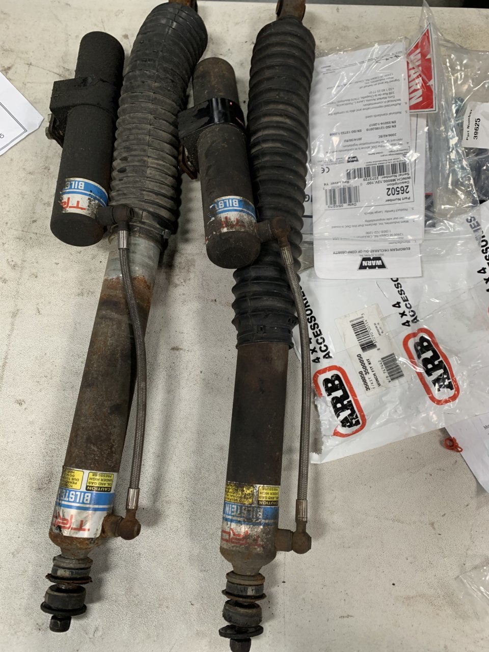

    Very cool! How many miles did you get out of your Baja rears?

    Lol!! So my truck has 42k and change on it. The rear shocks still had life. No leaks or change in ride. However, the ones I have don’t have the rubber lined steel line that feeds into the resi. That being said, I didn’t want to gamble through one more winter.....even though I hit everything with fluid film to protect everything. .......see pic.

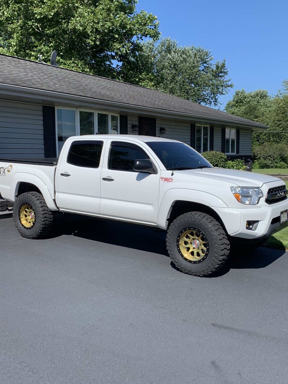

    just a few things.

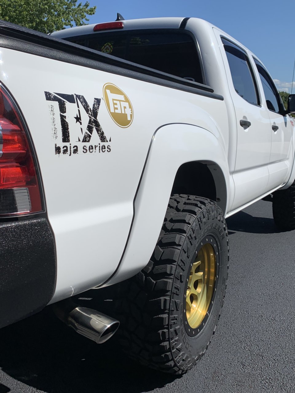

    Where can I get a gold Toyota sticker like that?

    eBay. Search “gold Teq decal”

    I have been waiting for some one to put the 3rd gen pro suspension on and see how it is.
