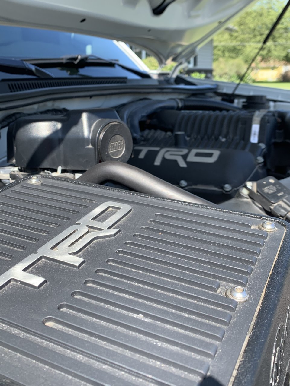

    I’ve heard many times that the rich TRD tune alone is indeed safe for a 2.7. I believe you are correct about your elevation as well. To play it safe confirm this with roostfactor. Or someone with a blower, a 2.7, and that lives in your area. I know there are a couple individuals.

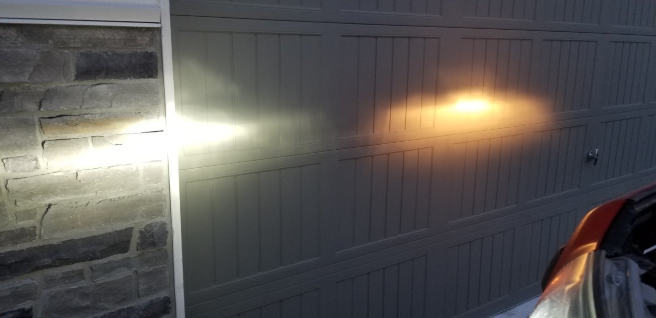

    These piaa headlights are crazy bright!

    I'm running the TRD Baja suspension with TRD Blower and TRD tune with a 2.7 pulley. It is safe with an upgraded fuel pump. I'm running a 255lph pump.
    You'd be surprised how not bright they project. You typically get a lot of glare to oncoming drivers and loss of distance projection, but up close on a wall the whiter light looks brighter, but typically isn't if running a quality halogen bulb.

    I’m also running a 255 walbro. For me it’s a must as a safety. His elevation is his way out of doing the fpr and possibly the fuel pump. Personally, I’d still do the fuel pump then wait and see how afr’s looked to see if he needs the fpr. Is your elevation similar to Salt Lake City?

    Agreed on the fuel pump as a precaution. No, my elevation is much closer to sea level compared to Salt Lake.

    Your more at my level. I personally am not very knowledgeable when it comes to elevation and boost loss or gain. Basically because I’ve never experienced it. It wine interesting to see if Ryan would not need those mods due to elevation........I’d still do the fuel pump though

    I'm eyeing a 255 pump with the URD fuel filter relocation kit, better safe than sorry.
    When I asked about pulleys on TRD tune--

    I’d definitely do the fuel pump like I said before. That kit is nice because it exposes the filter for an easy swap if needed. Pulley wise, I’d do just a 2.7 without fpr. I like to play it safe. I personally wouldn’t go smaller to just start running into other fueling issues......why mess with that headache. When you get your pulley, get a quickchange from smoothflow. That way you can swap sizes Incase you ever want to go back to 2.8or if you did want to dabble with a smaller one.

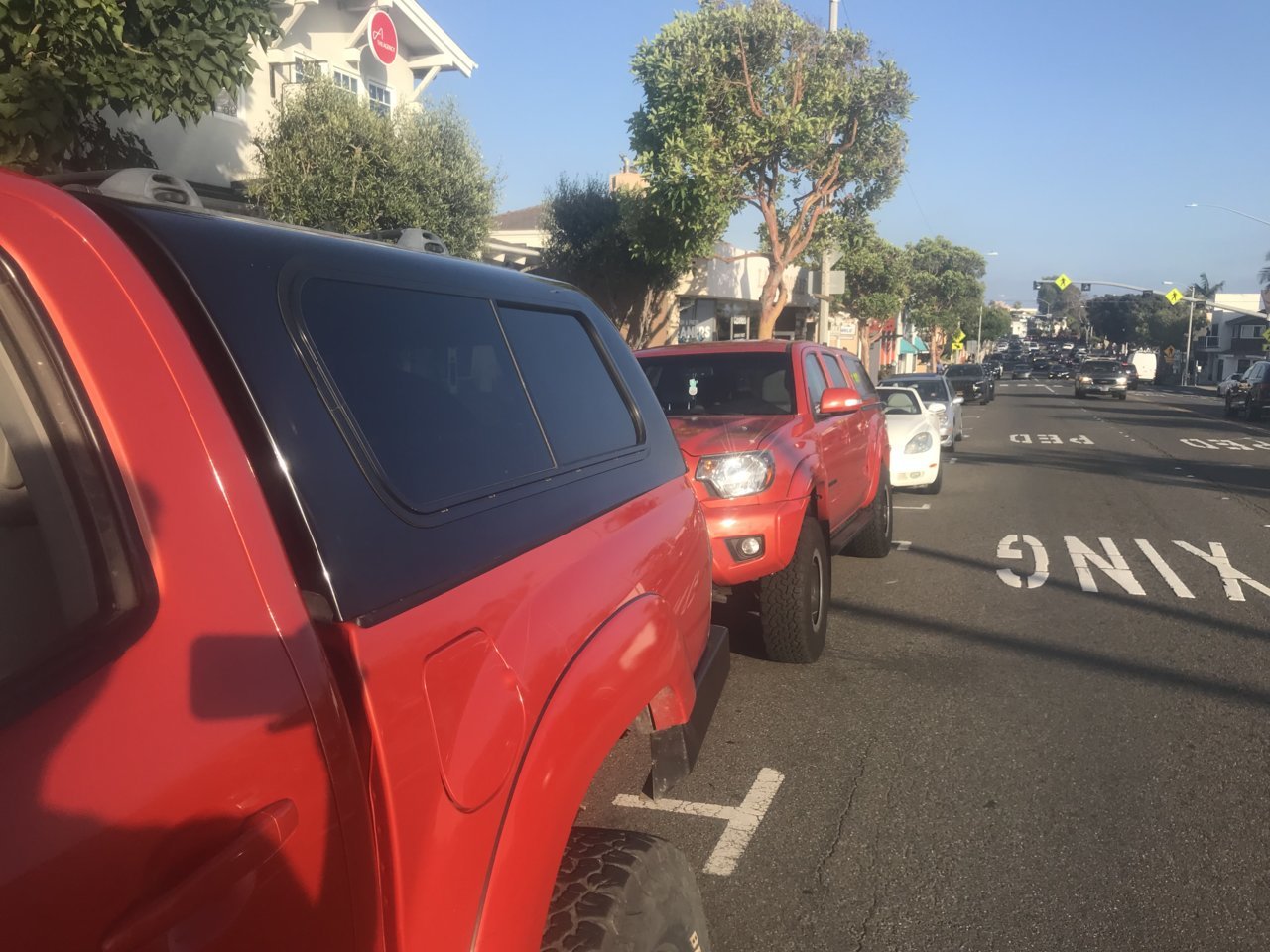

    Question of the day. Anyone of the very small number of 15’ inferno tacos have a inferno camper shell? And then if so.. anyone want to part with it lol.. hoping there’s at least one out there that someone is tired of but doesn’t know how to get rid of.. (psst I’m your guy )

    Honestly just trying to find this guy from Laguna Beach and convince him to sell me his lolol.
