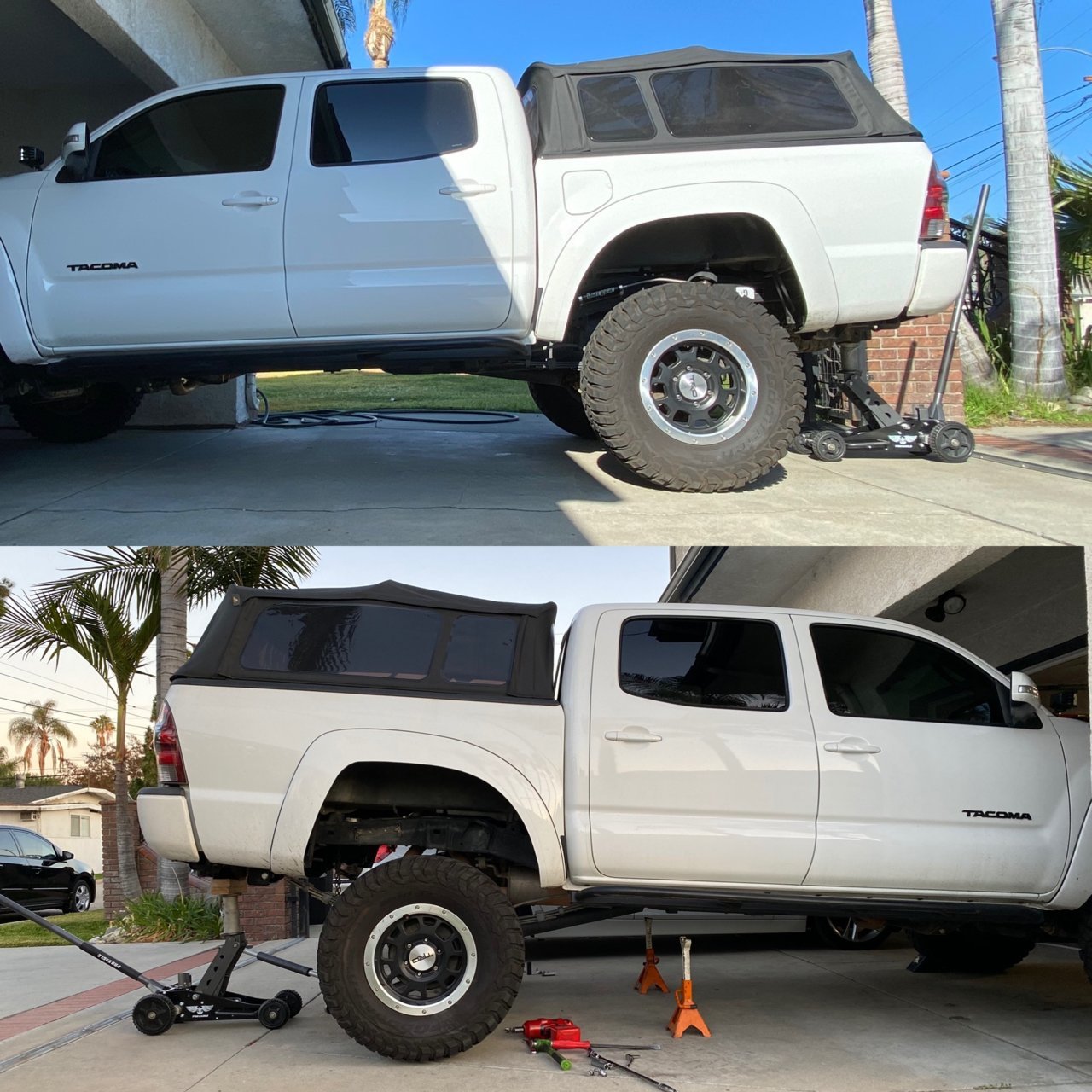

  12. Nov 23, 2019 at 4:50 PM
    #6752
    greenEFSI
    greenEFSI TacoSupreme____
    Jun 29, 2016
    #190830
    1,560
    Gio
    West Covina, SoCal
    '15 TRD Pro Super White
    I gained about 9 more inches travel
    edit* measurement was taken at the rear bumper. Shock length is about 4” longer than stock.
    Scribbles, RyanL, ARCHIVE and 2 others like this.
  13. Nov 23, 2019 at 5:11 PM
    #6753
    JuanitoBonito
    JuanitoBonito Que Pasa
    Dec 29, 2013
    #119422
    9,178
    Juan
    CHI-TOWN
    2024 Raptor
    Whoa....what exactly did you install
  14. Nov 23, 2019 at 5:11 PM
    #6754
    Island Cruiser
    Island Cruiser TVita
    May 20, 2012
    #79166
    3,937
    Kauai
    Baja
    Extenze
    BVita, Armyhater458, hack4875 and 2 others like this.
  15. Nov 23, 2019 at 5:17 PM
    #6755
    greenEFSI
    Jun 29, 2016
    #190830
    1,560
    Gio
    West Covina, SoCal
    @ARCHIVE Hammer Hangers and removed the shocks to test full droop. Once the hangers are installed the shocks limit the travel. Tomorrow I’ll test full bump and finally have the numbers I need to get new shocks made :cool:
    :rofl:
