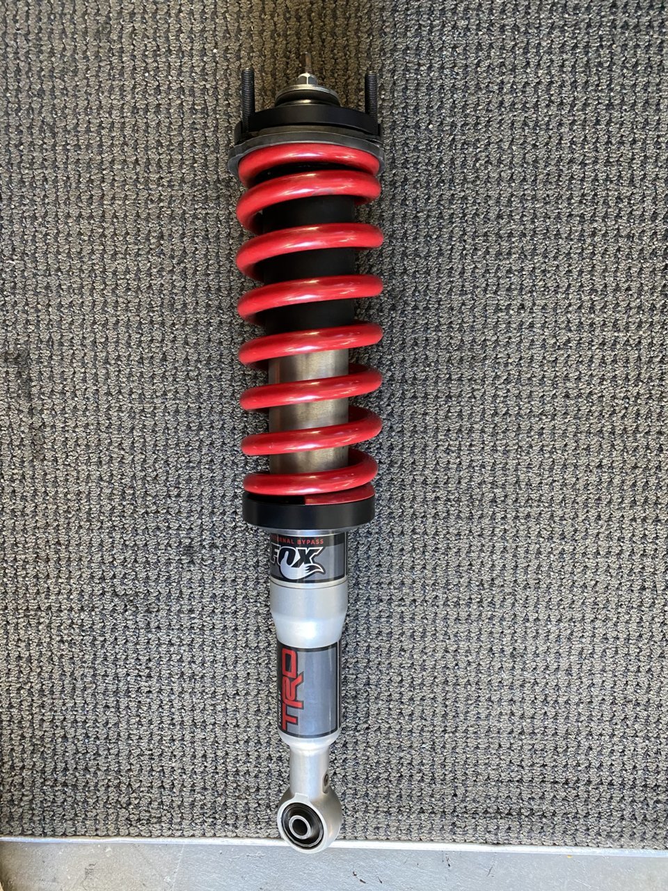

    I have the 3rd gen Fox set up as well. I only have the rears on the truck as of now. The fronts will go on this summer.

    Oh he had a 2020 Pro Fox suspension replace his 2019 Pro Fox Suspension? Interesting
    With your top hat spacers? Remember my outcome lol

    I’m holding out hope the top hats I take off the Baja setup for the fox setup will still yield me a pleasant stance.

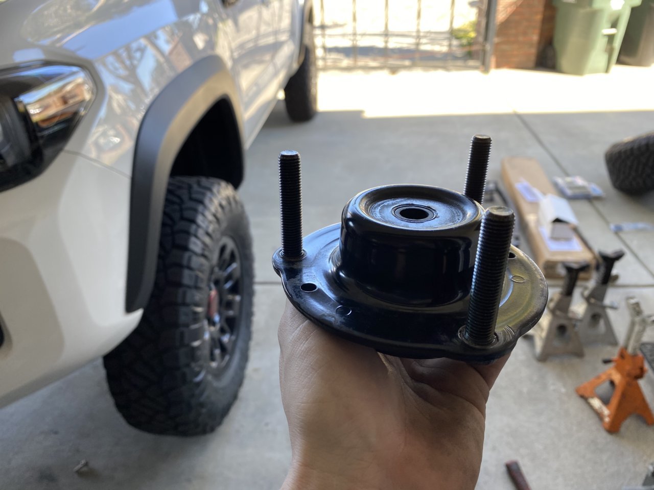

    The install was ridiculous lol! Took about 4hrs for just the front spacer kit and extended top hat studs. My cheap spring compressor was operating at max sketchiness :rofl:

    Yea I’d say it’s about that thick. The larger lower perch made it tough putting the spring back on.

    Ohh I thought that looked different too lol. Revtek? I came close to using the 1” Toytec when I was getting the Baja Bilstein’s on but I was helping the mechanic assemble the coilovers with the spring compressor off the wall lol. I was more so afraid to risk both our lives with the 650lb coils wanting to spring out worse than morning wood

    Haha that setup is the “wescott” lift that Juanito originally posted. Not too sure about the exact sizes of the spacers, but I wish I had a wall mount spring compressor to do this install lol :frusty:

    I have the 1" Toytec ( ) and the Icon progressive AAL in the rear...wondering if these Fox Pro setup will be a direct swap for my setup and if the lift/stance would be the same. $350 seems like an incredible steal.

    No shit, you do?? I was strongly considering them but wasn’t too sure on how it would ride off and on road. Also was concerned on the affected travel. How are they?
    And NO the 3rd Gen Pro Fox coilovers will not yield the results you’re under the impression of. Believe me, belieeeeve me lol

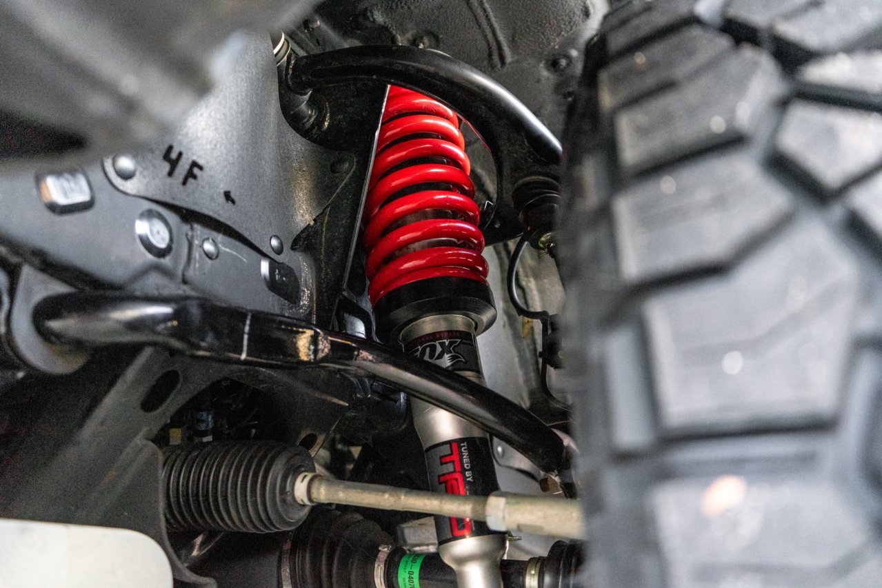

    Fuck, you ain’t wrong about that brother lol! To put it simply, the Fox Coilovers ended up being LOWER than our Bilstein’s lol. Edit: the height up front from center of hub to bottom of fender measured out to about 21.25”
    How’s your CV angles? I assume you didn’t notice your shocks over extending or experience coil bind under full compression?

    CV's are good. Nope, didn't notice any of that, and I've pushed it through some good flexing. :thumbsup:

    I wanna see more pics if you got and of your CV angles man!
